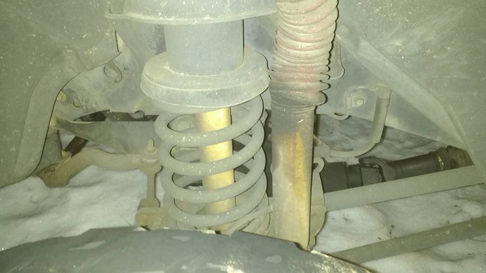

ok, here's the pictures if i did it right...
Attached Thumbnails newbi bought a truck from a tweeker-s1.jpg   newbi bought a truck from a tweeker-s2.jpg   newbi bought a truck from a tweeker-s3.jpg   newbi bought a truck from a tweeker-s4.jpg   newbi bought a truck from a tweeker-s5.jpg
newbi bought a truck from a tweeker-s6.jpg   newbi bought a truck from a tweeker-s7.jpg   newbi bought a truck from a tweeker-s8.jpg

Ok, spacers up front, and a cluster fark out back..... It looks like the bump stops were moved on the frame, and now contact the spring forward of the axle?
I would be REAL tempted to replace the rear springs with some appropriate lift springs, dump the blocks completely, and maybe do a shackle flip if you need more lift..... Either that, or just pick up a real lift kit, and replace EVERYTHING under there.... That mess does not bode well for the quality of any of the other work on the truck........

from the last picture, to me, it looks like there is no bolt connecting the leafs together, and the straps were put on to do that.
