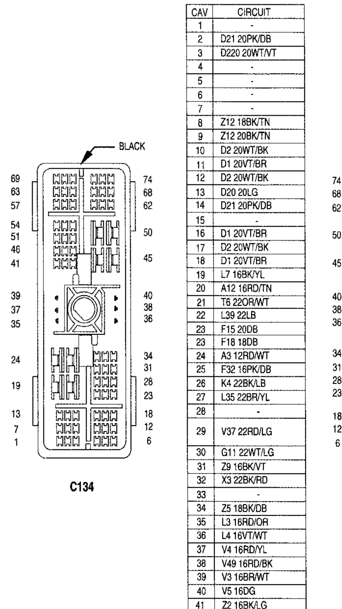

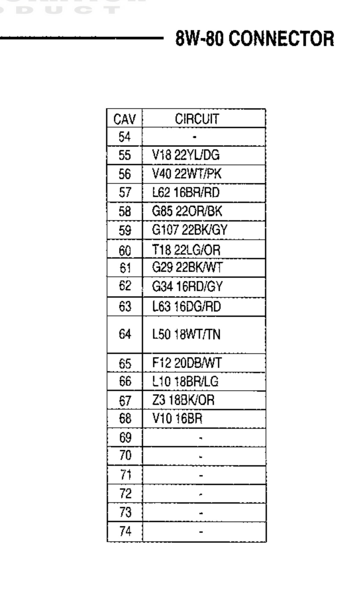

IF that is Connector 134, I think that's is pin 67, which is a ground for various interior lights? (circuit z3) What color is the wire supposed to be?

The wire is black with a red tracer. But being as it's headed up behind inst. Panel could it be the ground for it?

It looks like your right it is pin 67 according to this and here is a little piece of the insulation that was left so how do I find out where each end of this wire goes to?

Ok still getting there slowly but surely... It is part of the z3 circuit and the wire that is burned going up behind the cluster lands on pin 5 of instrument cluster-c1 plug... which comes down to the c134 plug that then goes through the firewall so anyone know where to fond the other end on the engine side of the firewall?
Old Oct 3, 2017 | 07:19 PM
  #38
Posts: 87,554
Likes: 4,230
8W-15-10
That wire is the ground for the electric brake controller. Even if you don't have one, the harness for it is still there.
