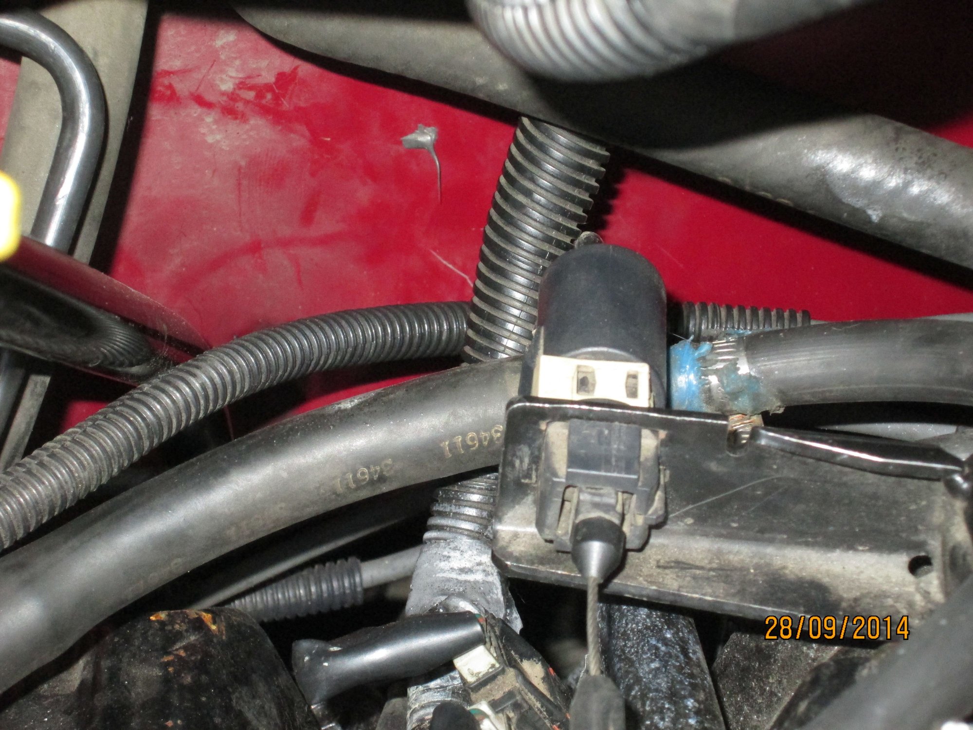

Is this the IAC? If so is there a trick to unplugging it from the connector? I do not want to just tug on it and screw it up if there is a certain way or disconnecting it.

Nope, that's the Throttle Valve cable. Goes down to the trans, and modulates shift points/firmness.
IAC is on the back side of the throttle body, right smack in the middle. There is a four wire connector. Yep, it's a pain to get to.
