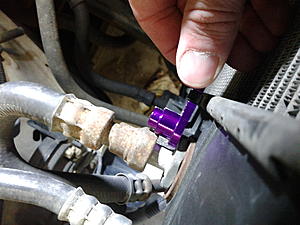

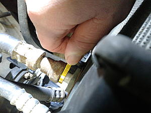

Okay, as you can see in the pics below the purple tool is too long to fit
between the quick connect and the radiator. So I cut down the gold tool
too fit between the two, but by cutting it, its now too short to reach the
springs. Ive tried these tools, the grey "professional" plastics, the white
"autozone" plastics, and the 45-degree steel wrench tool - every single
one has the same issue - either its too big to fit, or it fits but too short to
reach the springs.
I really dont want to cut the radiator or lines out of the truck but I am
running out of time and options for this swap. Please let me know
your thoughts!

I apologize - I guess I wasnt clear enough... I know how quick connects
work, i just cannot get this one because of its design.
NONE of the tools fit inside the quick connect because they are too long
to fit between the radiator and connector (see pic with purple tool.) The
plastic ones break when I try to force them, and the metal ones (obviously)
cannot be forced in.
The Gold tool was cut off with a dremel in order to make it fit in the gap
between the connector and fitting. The problem now is that it is not long
enough to reach the springs inside, let alone pry them apart. I have tried
pushing and pulling the hose with pry bars, but the 1/8in wiggle isnt
enough to allow the tools access, or the springs to reach.
Other than the typical tool use, is there another way to pop these
connectors? Ive tried rolling up paper, zip tie straps, bent a piece
of flat metal - all work at popping one spring at a time, but I cannot
get all four simutaniously.
Is there a way to remove those studs from the radiator?
My only other option at this point is to cut either the lines or the radiator...

FJ5 - Everywhere I look online shows a much bigger gap
on the shafts than what my truck has. Another 1/2in and
EVERY tool I bought (probably) would have worked fine.
Yes the bottom line has a nut fitting that I (think) i can just
unscrew, but its pointless if I cannot get the top one
disconnected... and if I can figure out a way to disconnect
the top one, then I can simply disconnect the bottom.
Question... the large nut holding the QC shafts onto the
radiator - I was told that unscrewing them is a headache.
What happens if I unscrew them? I only ask because all
the new radiators online dont come with those shafts so,
in theory, they must be removable... right?
In the end Im looking for a shadytree/hillbilly way to
remove the quick connect without using the special tool.
