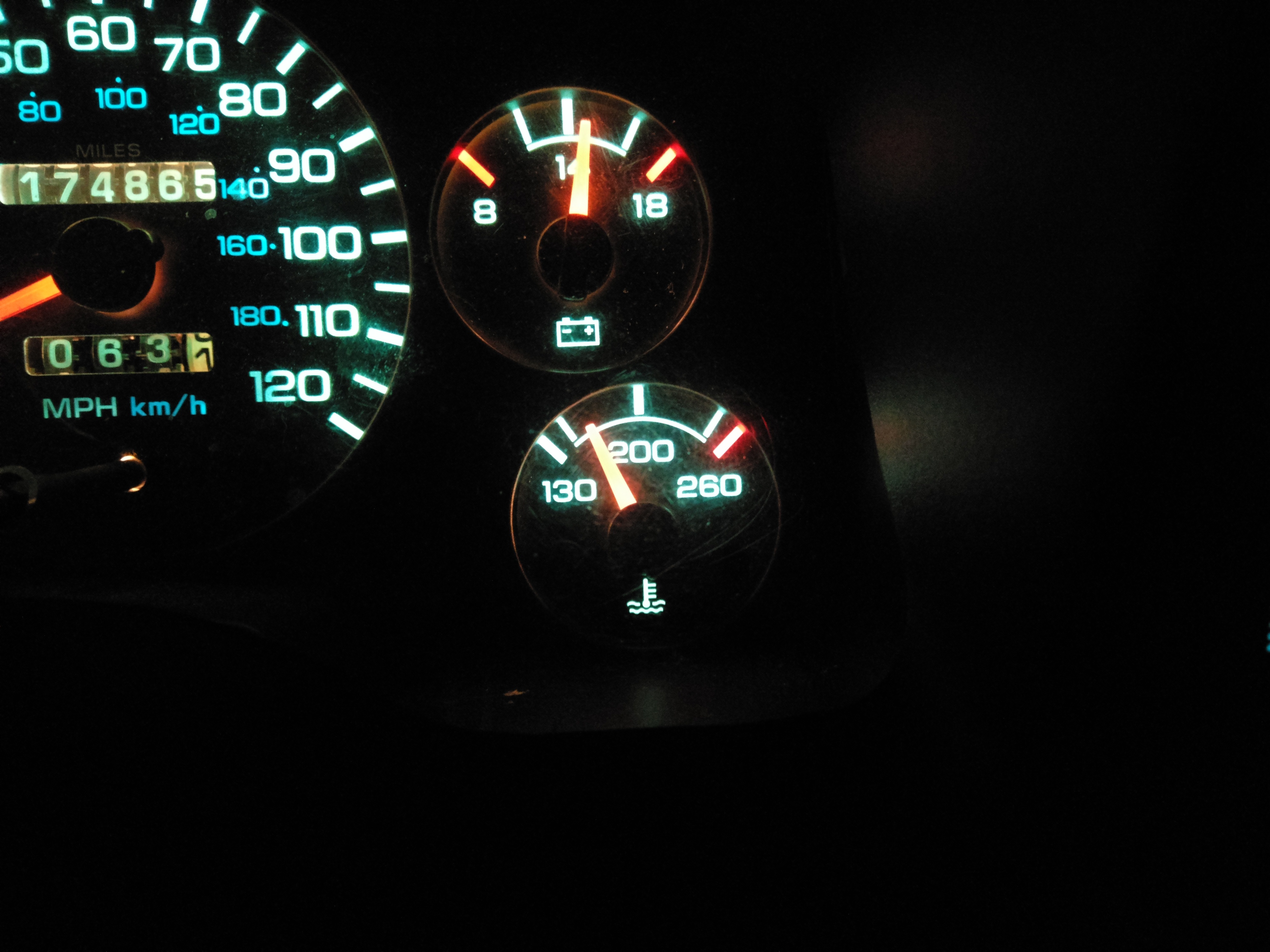

I installed a 190 thermostat in my truck but lately it doesn't get near that. It's acting as if I installed a 150 or 160 thermostat. Can this have any bad effects on my truck? Besides.... No heat

That looks a lot like a failed thermostat.......

If the thermostat fails open, and it's winter time, your engine probably won't reach operating temp which is what you're seeing.

There is a tab on the front of the thermostat housing, that makes it fun to get out with everything else still in place. Grind off the tab, and life becomes a lot easier.
Get a stant superstat. NOT a safety stat. Those suck, as they fail far to easily.

I have a 180 in mine and in 20* weather mine stays just under the 200 mark. Replace the t stat. And drill a small hole in it before you put it in(read # 14).
