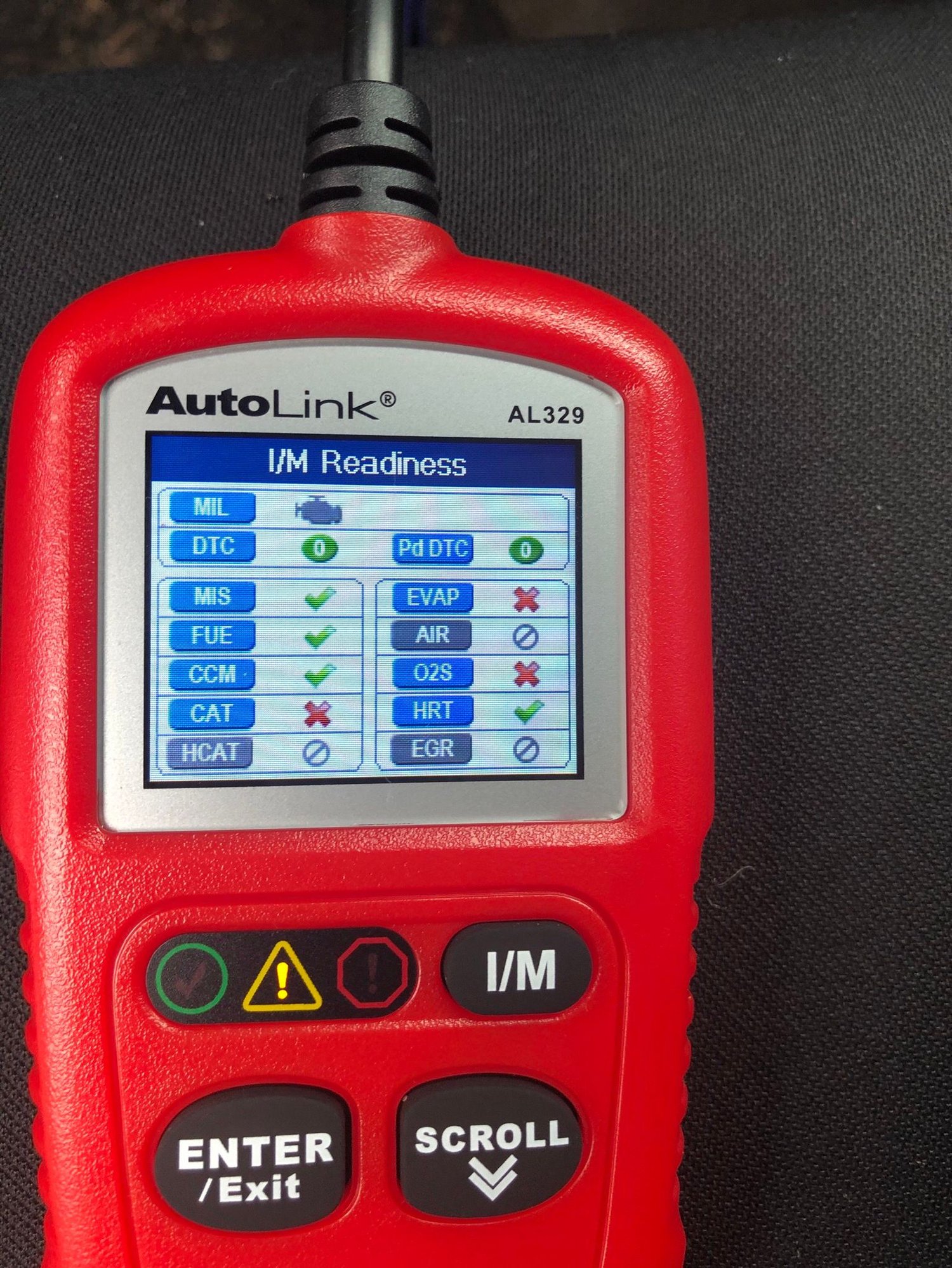

Old Nov 11, 2019 | 05:30 PM
navy5.9's Avatar
navy5.9
Joined: Jan 2018
Posts: 21
Hi guys trying to bump this thread again, just got back from a deployment and ready to work on the truck again, it started back up after sitting for 8+ months but is still running weak, won’t drive at all. I borrowed a cheap Autel reader and it’s not popping any codes, still playing around with the system monitoring and got this... I know as above it was recommended to double check the coolant temp sensor/harness for it so I’ll be doing that, just wondering if there are some other possibilities
Old Nov 11, 2019 | 06:27 PM
Posts: 87,401
Likes: 4,214
Think I would remove the O2 sensors from the exhaust, and see if it drives better.
