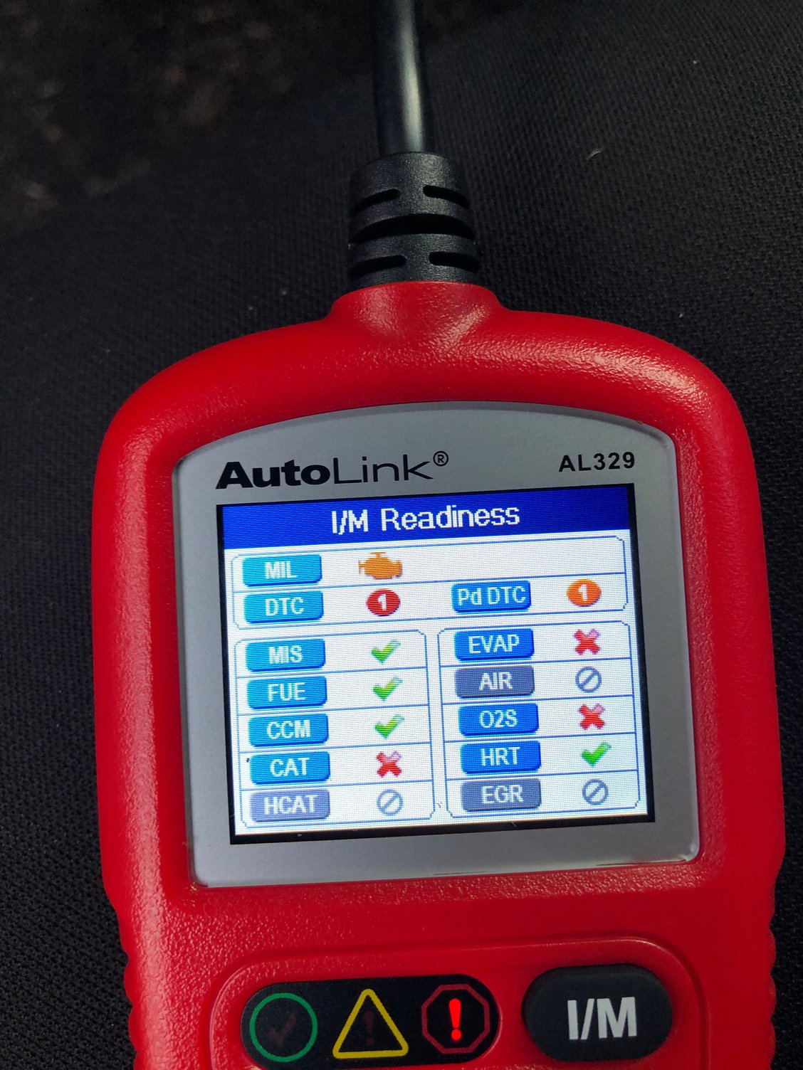

now I was popping codes for both o2’s and getting this on the reader when check engine came on

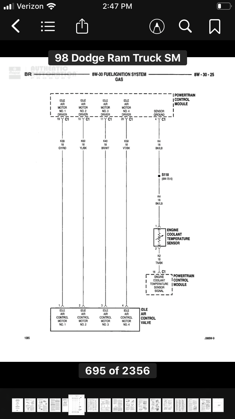

removed the pre cat o2 and no changes, additionally I’ve been noticing a chatter when it idles. I plan on reading out the engine coolant temp sensor wires as someone mentioned above, trying to figure out where c1 is (connector 1 on the pcm?) so I can read it out

There should be a pic of which connectors are where in the service manual. (connector locations.....)
