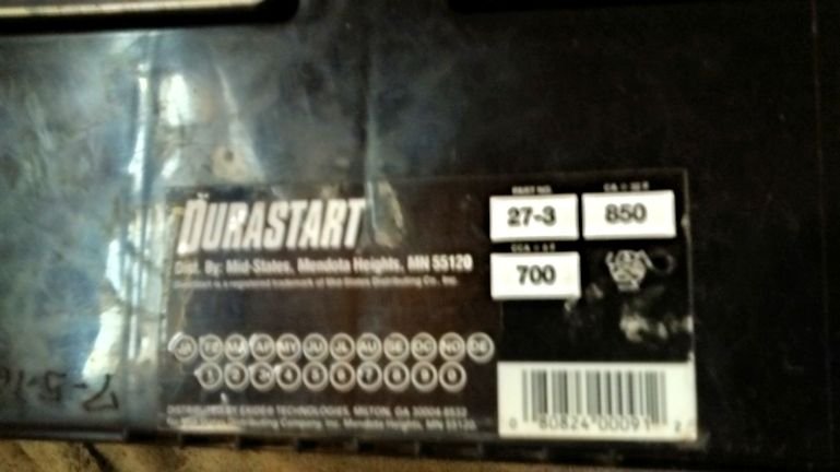

This is the battery that I bought in the fall of 2016, right when I discovered the 2 major battery drains, and had no choice about it.. I got this one specifically for the Dodge, however, it ended up living in the house mostly, until just very recently. Because, I also had to purchase another battery for my other truck, that is used only as a tractor at home. The intention was to have the little battery, that would be used only once every couple of months, to live in the house. ( I am guessing, I think it is only 550 CCA) I don't remember why, but for some reason, the little battery ended up in the Dodge, and since it just kept working, even outside in the Dodge all last winter, that is where it stayed.

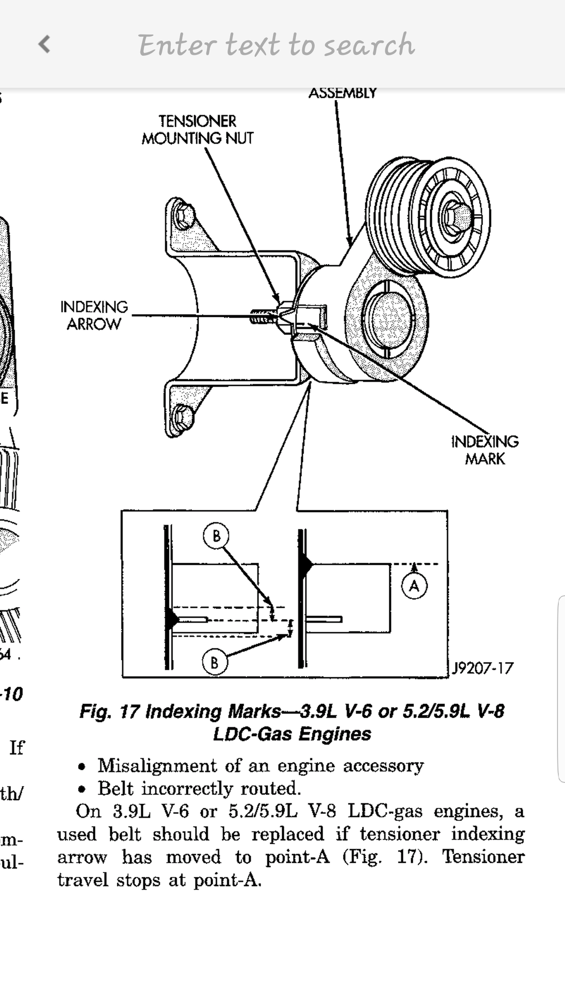

That sounds like an alternator problem. If the gauge works at anytime properly I wouldn't see why 30-45 mph would make your cluster different. Ill post a pic of diagnosing stretched belt. Tensioner mark should be almost ligned up with the stationary arrow on tensioner.

Welp, now today, I was not able to get that tensioner to budge at all. But as usual, I was in a hurry, so I need to check again tomorrow. Maybe I'll be stronger tomorrow. lol
According to the diagram Micheal posted, I do think a new belt might be in order, but will have to post a pic for you guys to tell me for sure.
