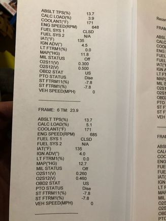

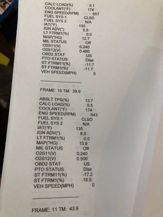

Well I was quoting what someone had told me to look into. I myself did not know what pump he was referring to. I do not have a smog pump on my truck. I have some freeze frame data from a few months back it doesn’t like to load in order although they are numbered. Maybe you can give me your input on this info? I can reload somemore when my buddy gets home to use his tool
Old Apr 10, 2018 | 05:52 PM
Posts: 87,554
Likes: 4,230
Why is O2S11 always at .24?
Long term fuel trim is always 0...... Have you reset the computer recently?

Heyyou is on the right trac here. Hard to tell O2 trends when a snapshot in time is all we have. The main thing about your fuel trims to note here are the short term numbers. Those hi negative numbers mean that your HAL 9000 is leaning you out in a big way and that's why you sputtering. The long term fuel trim at "0" only means that the trims start here. Try unplugging your battery n short the terminals together for 15-30 seconds n try again.Your upstream O2 seems almost lip locked on a lean condition (especially when you see numbers as lean as -29/the engine is being starved of fuel by the ECM) and your ECM isn't correcting for that for some strange reason. did you have an electrical problem recently? The other place to look is into a severe fuel injector problem on 1 of your cylinders. Probably stuck open or ECM is telling it to stay open, however I'm only guessing here. Pull your plugs and look for oil/fuel fouling.
