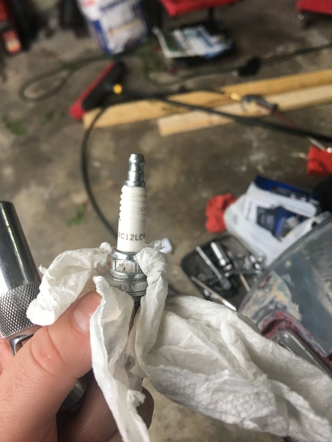

Ok, I cleaned out the IAC port and throttle, but it is still looping and stalling. It runs ok with the IAC unplugged, but it’s a high idle. Also, what is the TPS percentage supposed to be? I’m at 10-12%, but in the GM dealer we were always 0%. However, I’ve read mixed things about from the forums. Also, I have champion plugs RC12LC4 and they look black. I plan to buy a deal crank sensor tomorrow. P
Old Jun 11, 2018 | 07:11 PM
Posts: 87,572
Likes: 4,233
Its running rich. Do all the plugs look like that? Or just a couple?

I will have to pull the other plugs, but they 3 look pretty funny to me. The O2 seem high on the 1volt side, but I unplugged them both to seem if it would change the idle, but no difference.
