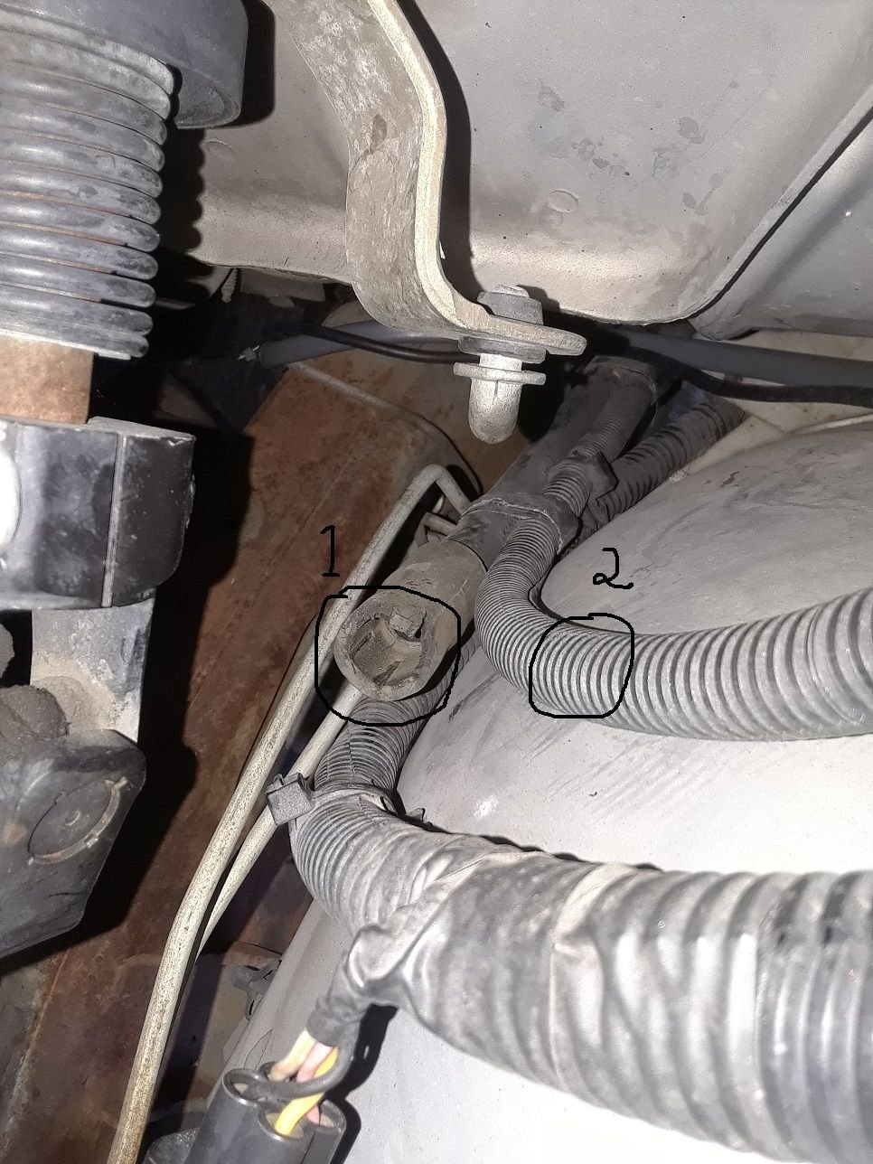

So this was interesting. I drove the truck today; gas is just dripping madly from the top of the tank. So I decided to trace back from the vapor canister to the purge valve. There are two hoses going from the canister that go to the engine (a larger diameter hose #1, and a smaller diameter hose #2 as labeled in the picture) near the steering column. Hose #2 seems to go to the purge valve up by the air cleaner just fine, but hose #1 looks like it was just broke off! I don't see a corresponding broken hose anywhere, and it doesn't seem like I have a huge vacuum leak. So what connects to this hose? Some sort of vent that's open to air? I'm going to start googling diagrams (my manual isn't helpful). Any info (or a picture!) would be appreciated.
I wonder if this is related to my fuel pump leaking, or just a secondary finding.

Here you can see where it looks like something was ripped off. You can see the striations or ridges inside the end of the hose where something was making contact.

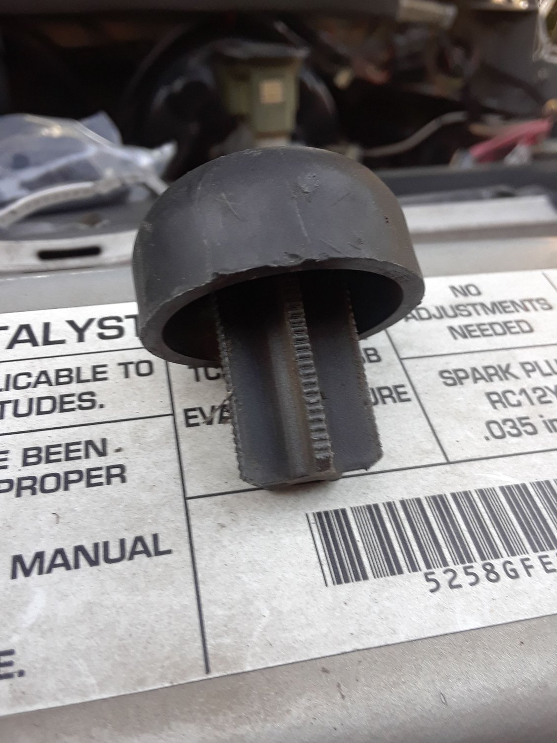

Here is the mushroom piece I pulled (along with a section of the hose it was attached to). You can see the ribs where it goes into the hose.
Here's the mushroom piece, the hose piece I pulled from my truck, and the hose I pulled along with the mushroom piece.
And here it is attached to the hose that goes to the vapor canister. It sits up higher now, and away from the steering column.
I was striking out on-line trying to find out what went at the end of the hose from the vapor canister. All I found was a black-and-white line drawing of a Mopar fuel and vacuum line combo that may or may-not have been for my actual truck, and it looked like a mushroom thingy on the end of the vacuum line. So I went to the not-so-local Pick-n-Pull to see if I could find anything on any Gen II trucks.
Pretty slim pickings for Gen II trucks at the yard, and nothing from a Gen II truck. But looking at a couple Dakotas I saw a little mushroom thingy up by their throttle body. So I pulled the hose and cut it. It looks like that's the piece that goes on there. I'm thinking somewhere down the line on my truck it must have got caught in the steering column and got ripped off. Since it is basically an open vent, it wouldn't generate a check engine light if it were missing since it is already open to air essentially.
