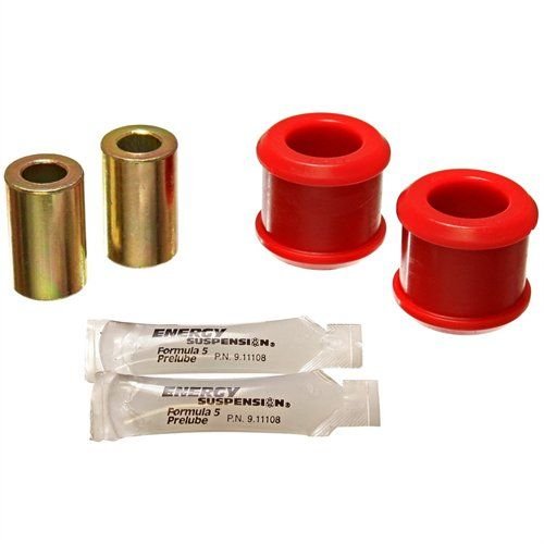

Ordered Energy Suspension bushing from Amazon - saved $4 by going with red (can't really see them anyway) Plan to order the SSI bracket from PDP on Monday. Will probably take a couple weeks to get it, since it sounds like a drop shipment deal from SSI - and from what they claim, SSI doens't carry any inventory on those.

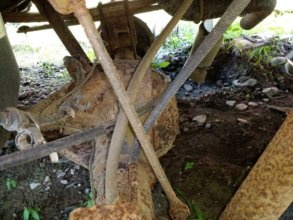

I'll go to the yard and take some measurements first hand. It was on the truck I pulled the track bar, I just glanced at them and said - dang those aren't rusty looking at all.
Here is the link I'm reading :
https://www.turbodieselregister.com/....157632/page-2
The rear D60 with 4.10s out of the 2000 2500 I had been thinking about dragging home looked like it was in the ocean for a few years... I think that one will go to the crusher, I'm not interested
Picture for your amusement.
