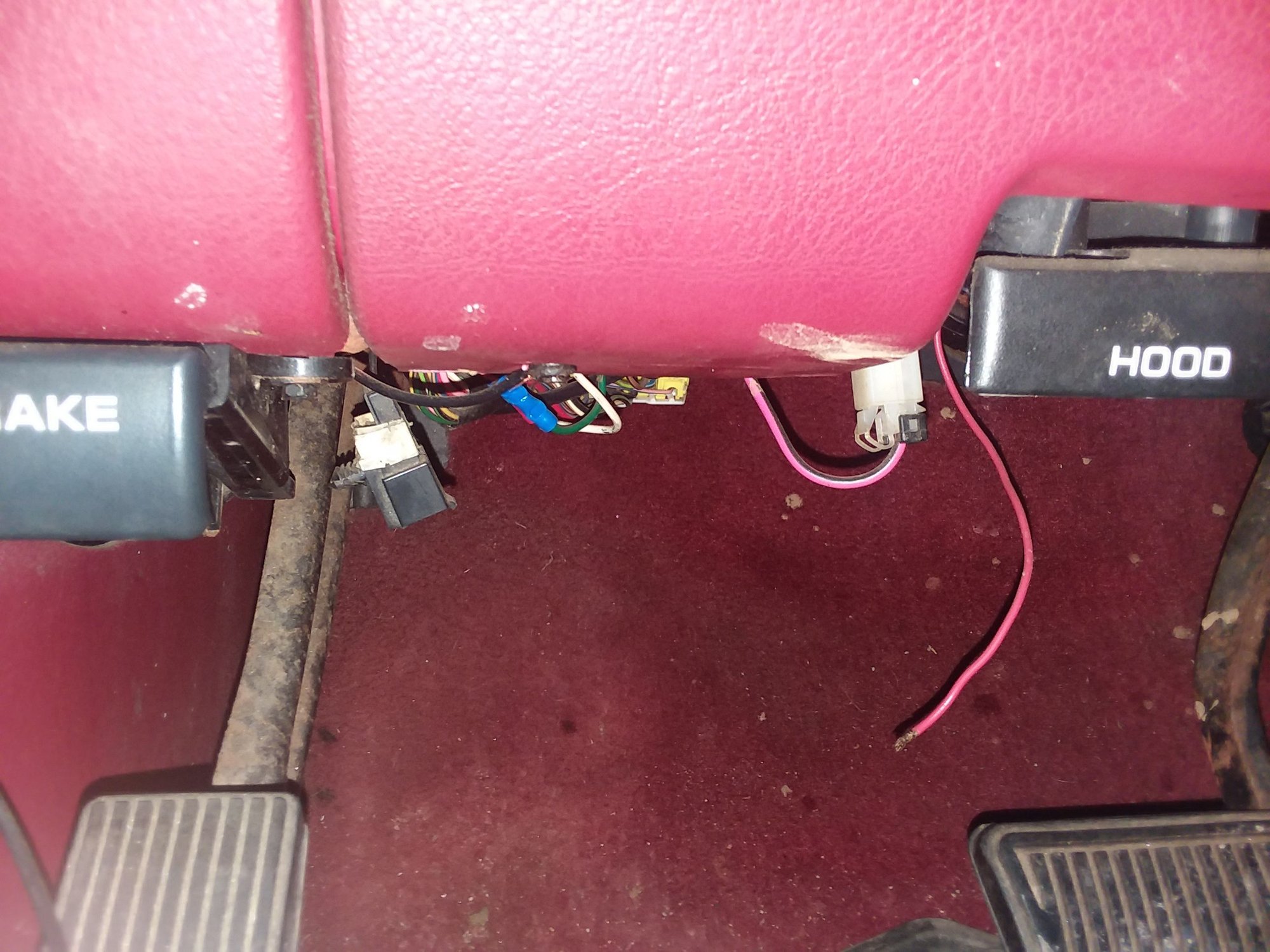

I have looked all over and there is nothing no old style plug nothing.

Complete dash no plug anywhere

Stick your head UNDER the dash. It's there.

I am not seeing anything resembling a plug

My bad. Too used to GM trucks..... It's actually under the hood, next to the PCM.......
