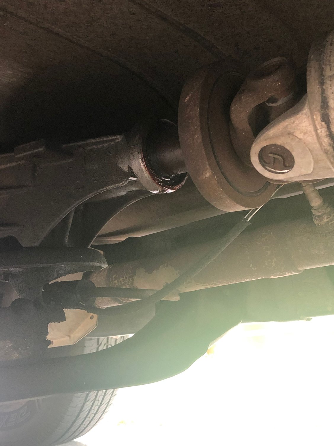

1. There is an area where the crank shaft meets the back of the engine (transmission? The trans pan is right under it) and it looks like it might be leaking, it just rained here so I think some water got up there and made what I “think” is a leak looks more serious than it actually is. I have a picture below to show you what I mean. The fluid I found on the ground looked like oil, but it was not very thick at all, which is why I think water got there.

1. That's the tailhousing of the trans. And yep, thats a rear output seal leak. Drop the driveshaft, yank the old one, install the new one, (grease the area where it rides on the driveshaft really well, otherwise, you'll smoke it the first time you drive it) and be happy.

Ordered a new seal, thank you sir. Engine Assy lube will work? So yea I am pretty sure I somehow messed up the plenum gasket when I installed it. Thought it all looked good so I will investigate further.
