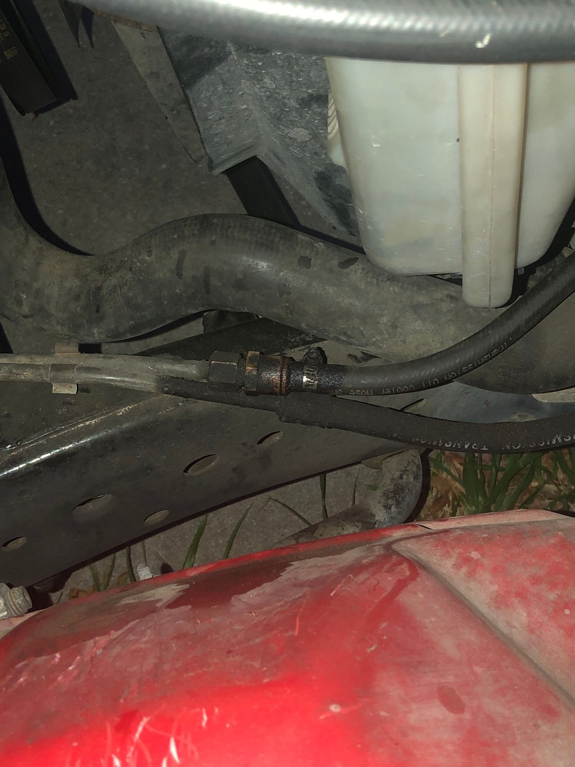

Just wanted to post a picture really quick and ask if this looks like the check valve hose has already been replaced, this is what I have right now:

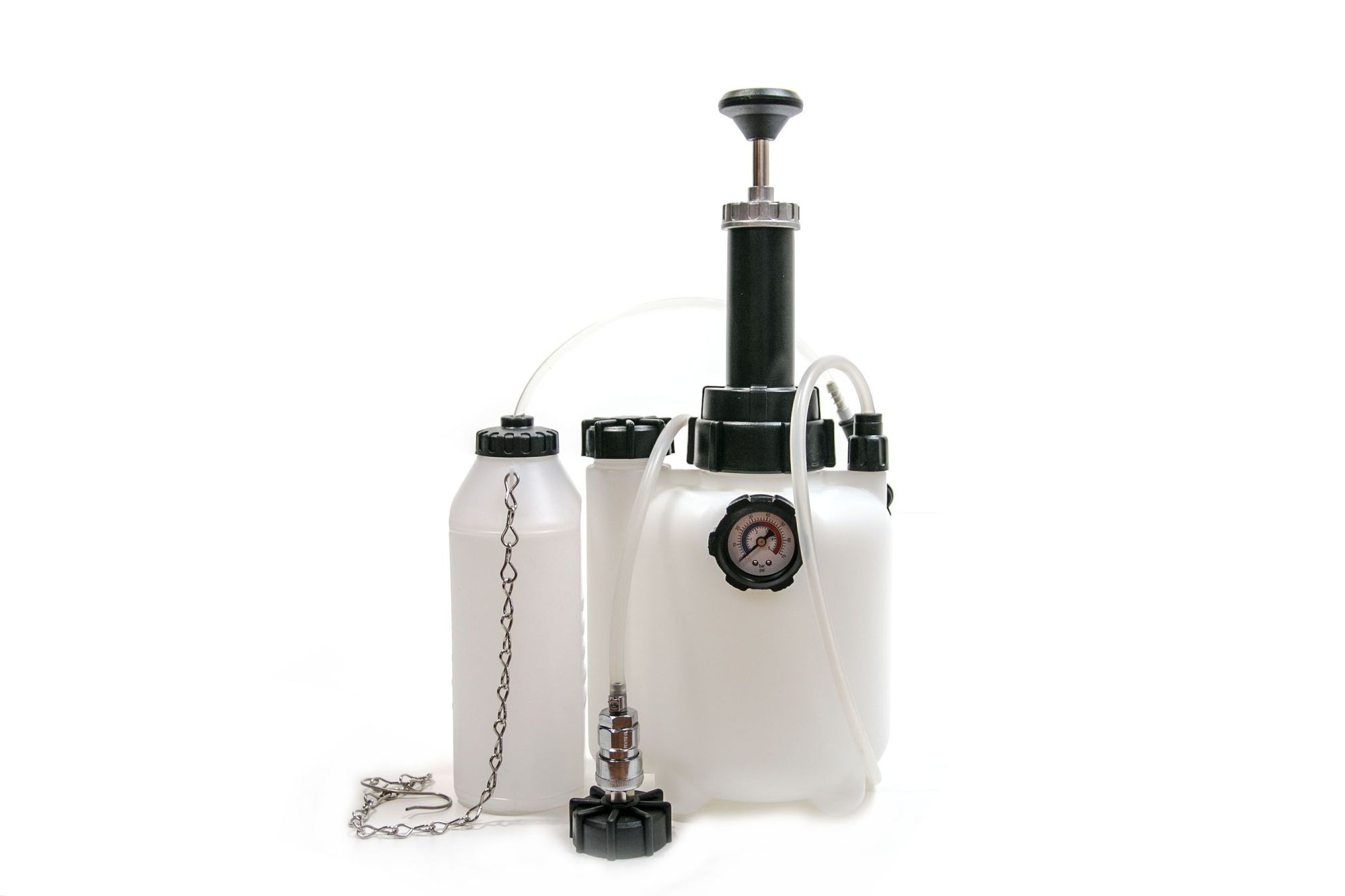

I have this break pressure bleeder, but the cap on it is designed for a volkswagen. You can remove the cap and the fitting though. I was wondering if anyone possibly knew of a cap similar to the one on this for the 2nd gen dodge I could just hook up to make sure all the air in the line has been removed?

Looks like it was replaced.
You should be able to buy the cap adapter for the brake reservoir for a Ram.

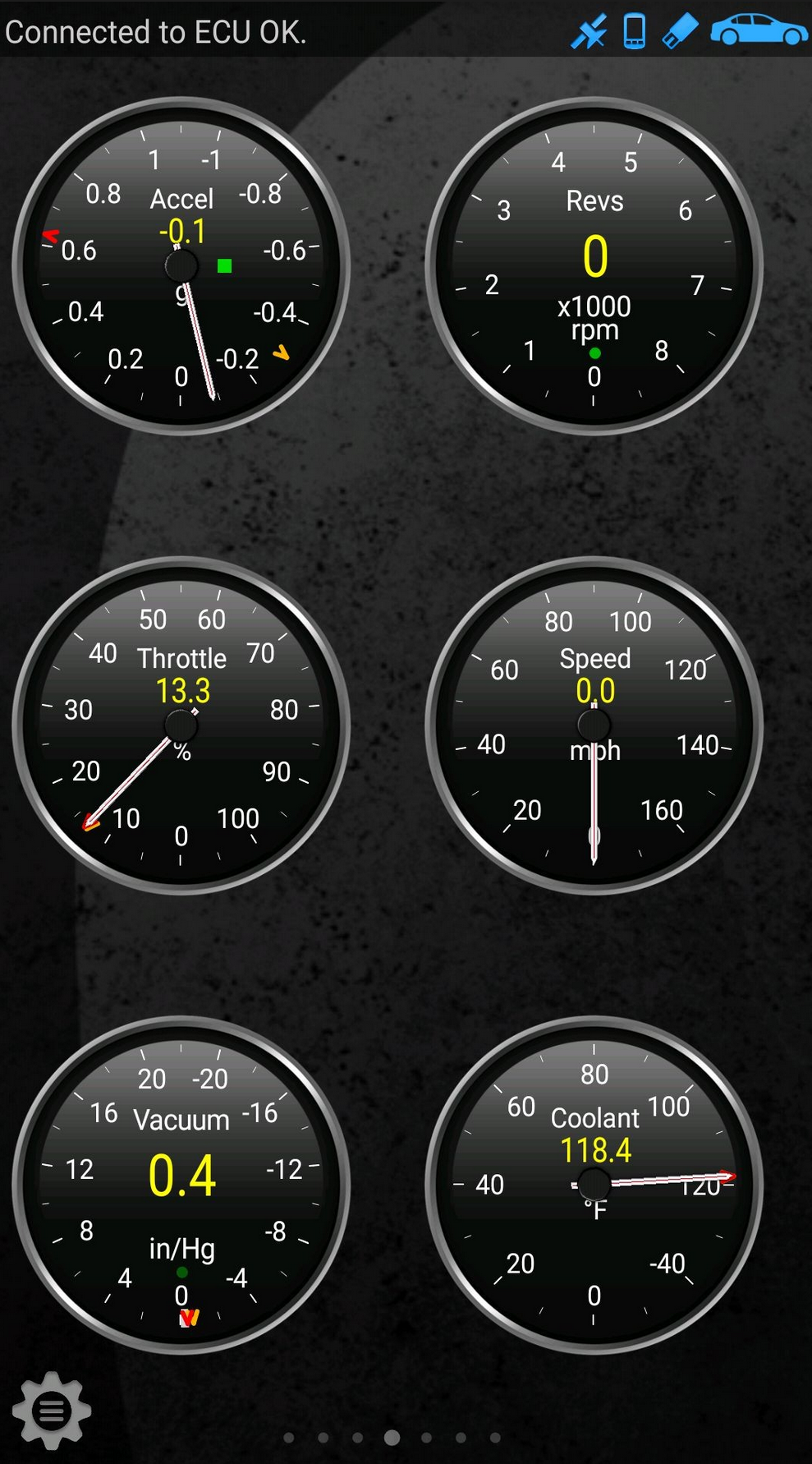

Here is what my scanner is reading. Throttle is reading at 13.3 when the truck is not even firing over. Coolant has not really moved from 118.

Is the coolant actually that warm????
