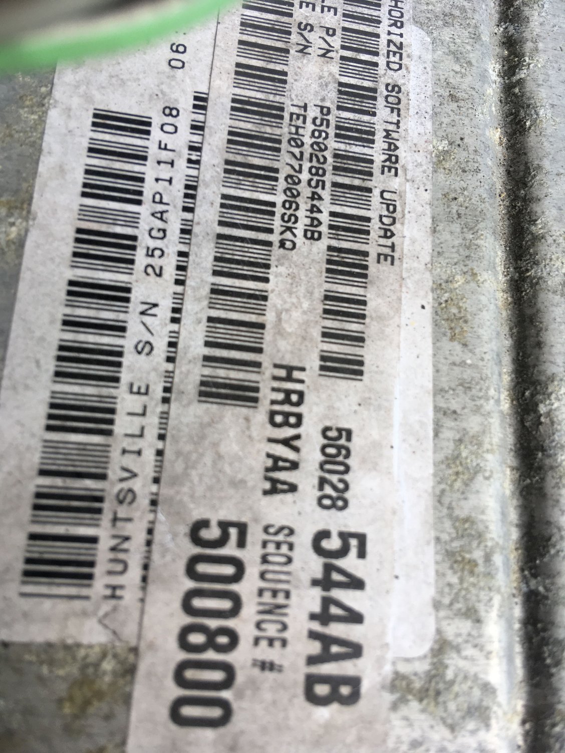

Well I plugged it in and no issues, srs and abs still functional! I do have one question for you buddy, you think either of these have death flash?
Old Jun 30, 2019 | 12:19 PM
Posts: 87,394
Likes: 4,213
Probably both of 'em. It was pretty standard.

Well the replacement came out of a 98 5.9l, was told it was a pre death flash update but I was hoping someone had a code list for the update and what numbers I should be looking for
Old Jun 30, 2019 | 03:49 PM
Posts: 87,394
Likes: 4,213
According to theory, there is only like 4 horsepower, and 20lbs of torque different..... (though, people have spent a couple hundred bucks to GAIN that kind of power....) Best bet is to just get an aftermarket tuner, and call it a day. Make sure you flash the PCM to the correct VIN first though.
