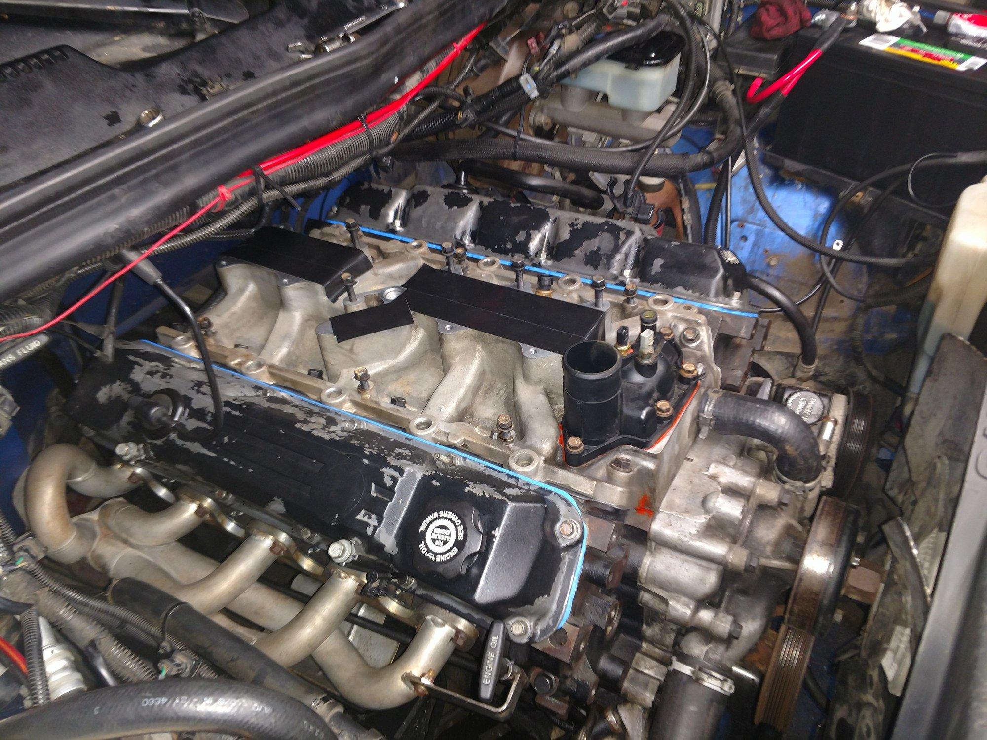

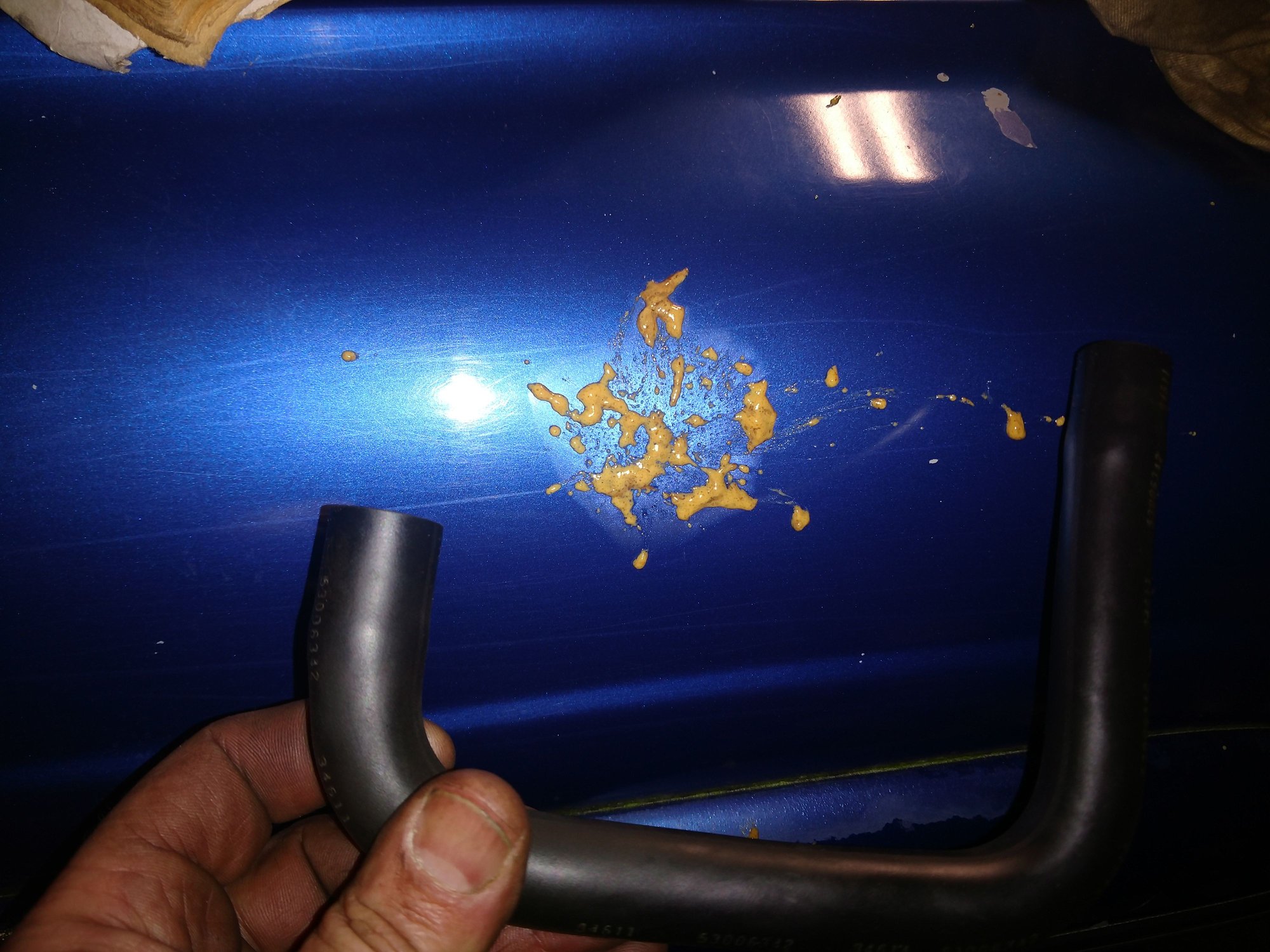

Progress! Almost have it back together. Couple more hours!
Look at the crud I blew out of the vent hose from the driverside valve cover to the upper intake plenum???? Not good!

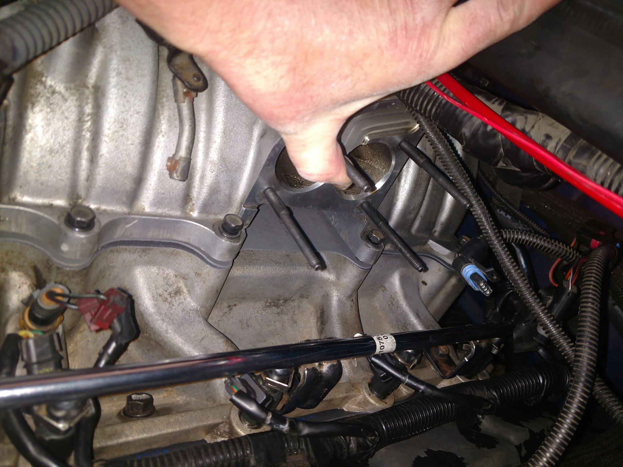

Default Upper Plenum gasket 2.0!
Figured out the easiest way to install the upper plenum gasket! Slide the plenum in place without the gasket. Then tilt the plenum to the passenger side and slip the gasket between the upper and lower manifold! I put 1" blue tape on the back three long bolts between the head of the bolt and the plenum itself. This holds the long bolts up out of the way when you slide it on! Helps to have little tiny hands of which I don't! Gotta relax and take your time with this piece. Cheers!
Slide plenum onto intake manifold without the gasket. Move the plenum into place and tip it to the passenger side of the vehicle. Slide the gasket in and tighten! Easy peasey!

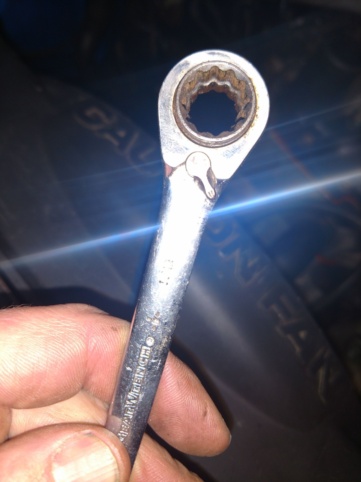

Make sure you have a 1/2" gear wrench for those three back bolts! It will keep the blood pressure down! Much easier!

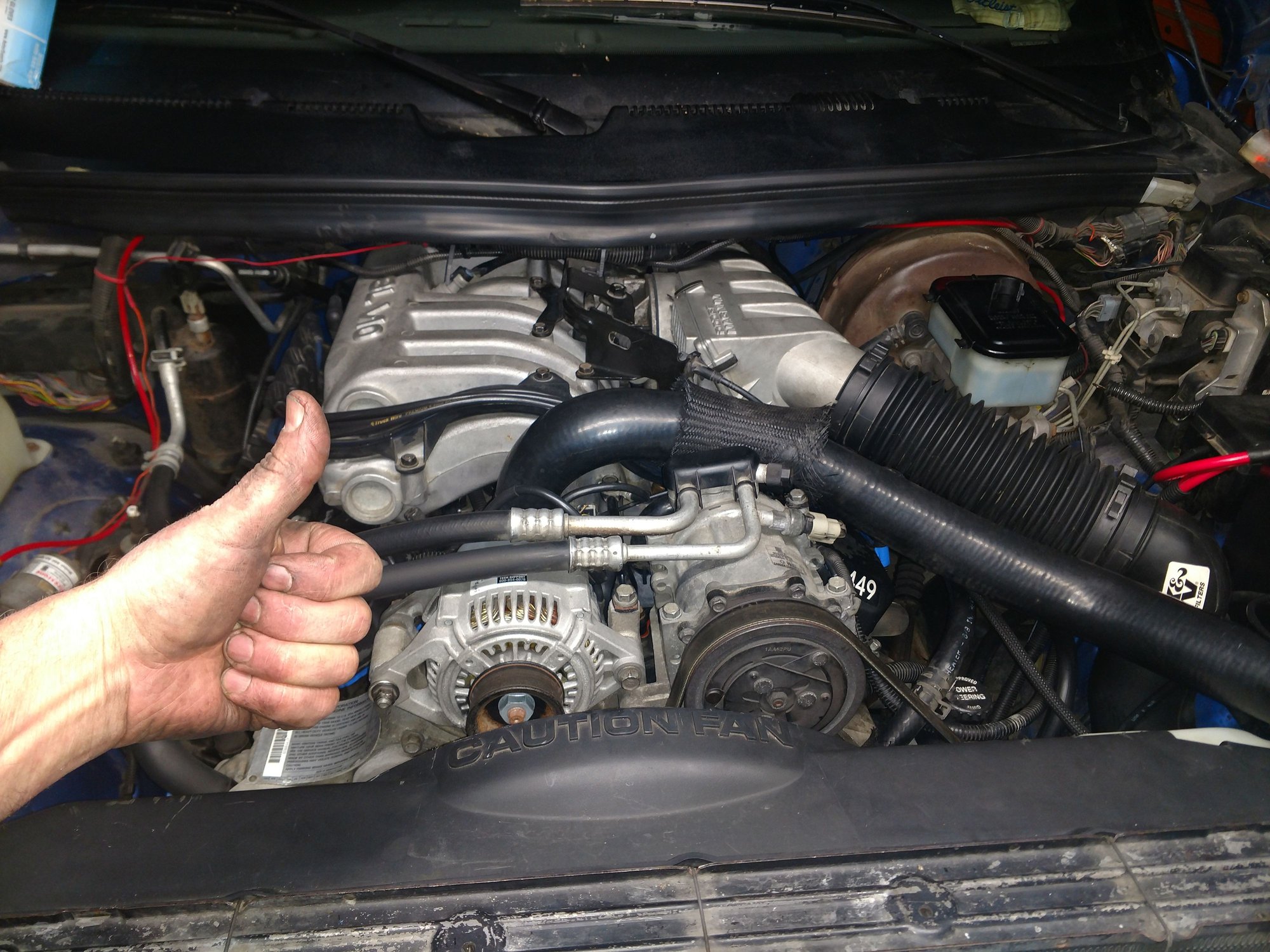

Default She's back together! 11:45pm AK!
It's all back together! It's late. Everyone is sleeping. So I can't fire up the truck until the am! Need water in the radiator and to hook up the battery! Stand by........
Only broke on plastic hose clip and have no extra bolts!
