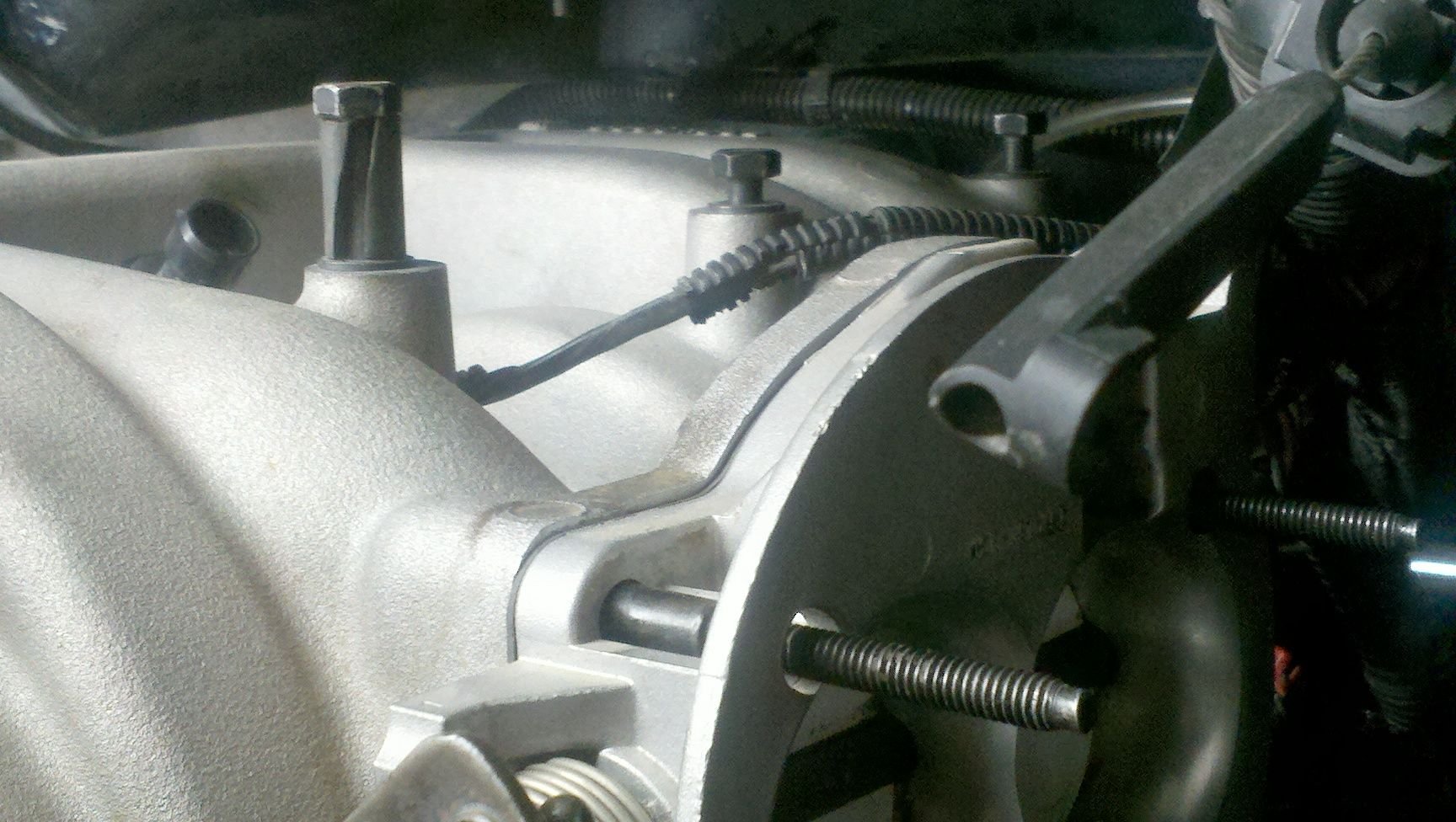

Here is another place to look, the corner of the intake manifold at the front. One of the V-10s I tore down was corroded enough here to look like it could start leaking coolant into the crankcase at anytime. This one not so bad, but you can see how little meat there is to form a seal. Besides that, every one I have had apart, the long bolts through the intake right here are corroded, meaning some form of humidity, along with differential or galvanic corrosion, whatever they call it, right? The coolant passages at the top of the timing cover mate to the block, but inside the engine. More meat here for a seal, but if the timing cover/chain changers messed up, there might be a good leak there.

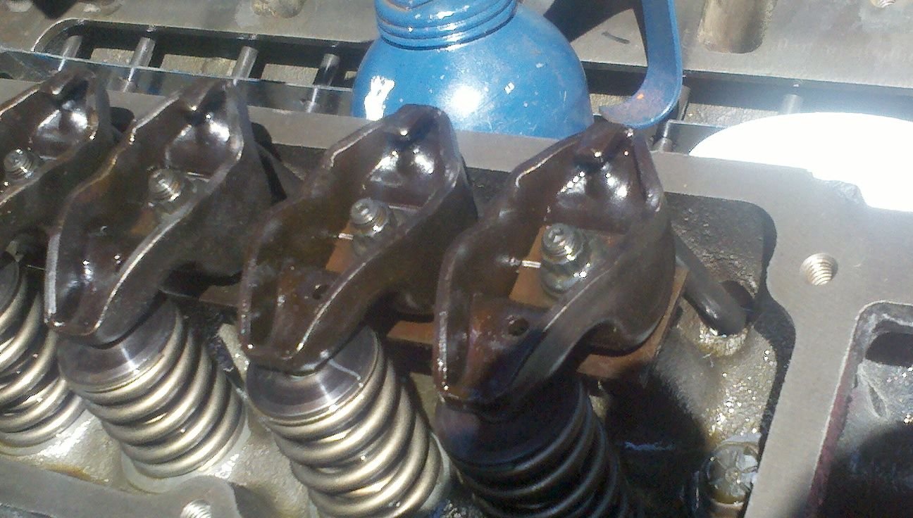

The caution is to allow the lifters to bleed down enough to avoid bending a pushrod due to overly tight valve clearance. If you prefill your lifters by soaking them, lifters on the base of the cam lobe, that is sitting at TDC, might have no clearance. Tighten the rockers down anywhere you please, just do so slowly/carefully. I then turn the engine over slowly by hand a couple of times to watch the valvetrain for binding and give the lifters that need it a chance to bleed down. I would also caution you to very carefully check that the fulcrum is fully seated on the pedestal. That little separator plate can wiggle loose and end up under the fulcrum. I'd be willing to bet that some of the reports of broken bolts/pedestals were due to folks with a false torque that later worked it's way loose. The oil needs to bleed up the pushrod or back past the check valve. ARP makes some sweet studs for 5.2/5.9L Magnums that work for the V-10. Just need four extra of everything.
Don't believe the parrots that tell you the world will end if you can't keep your pushrods in "as removed" order. Look at the tips under a magnifying glass, they never have. Nice and smooth right? The pushrod tips are oiled under pressure directly from the galley that rises straight up from the oil pump at the front of the engine. Some of the best oiled parts in the engine. I keep mine in order, because that is the way I was taught in the early 80's when I started. But I don't lose a second of mind time when they (almost inevitably) get mixed up a bit. I would definitely caution you to check carefully the fulcrums, however. The get splash oiled from the pushrod and seem to gall/sieze in engines that suffer from poor maintenance, another source of broken rocker bolts I am sure. I blame the accountants at Mopar for some of this. The pathetic little thimble of an oil filter they spec'd for this engine likely spends most of it's time in bypass, filtering nothing. Get a 51515 Wix for more filter area/oil capacity.

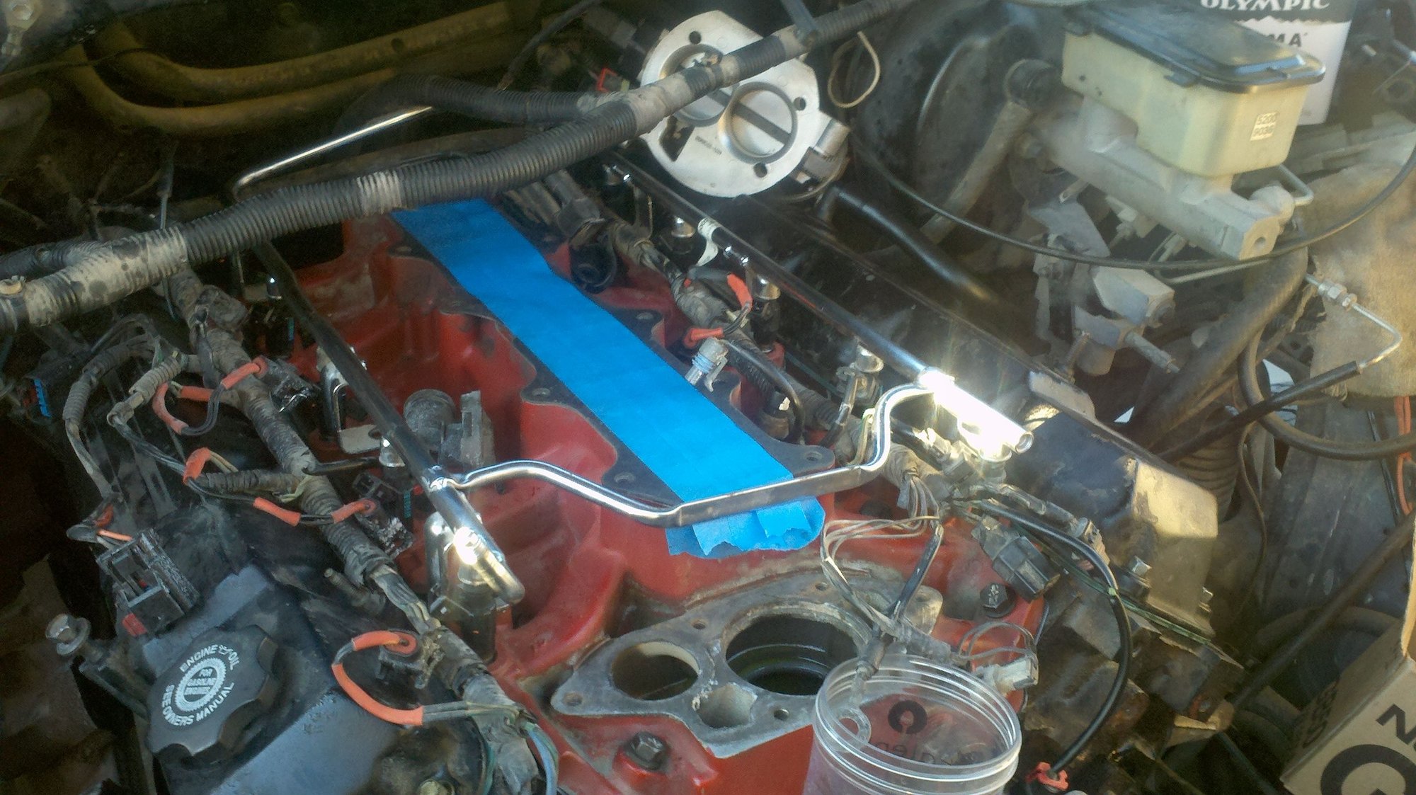

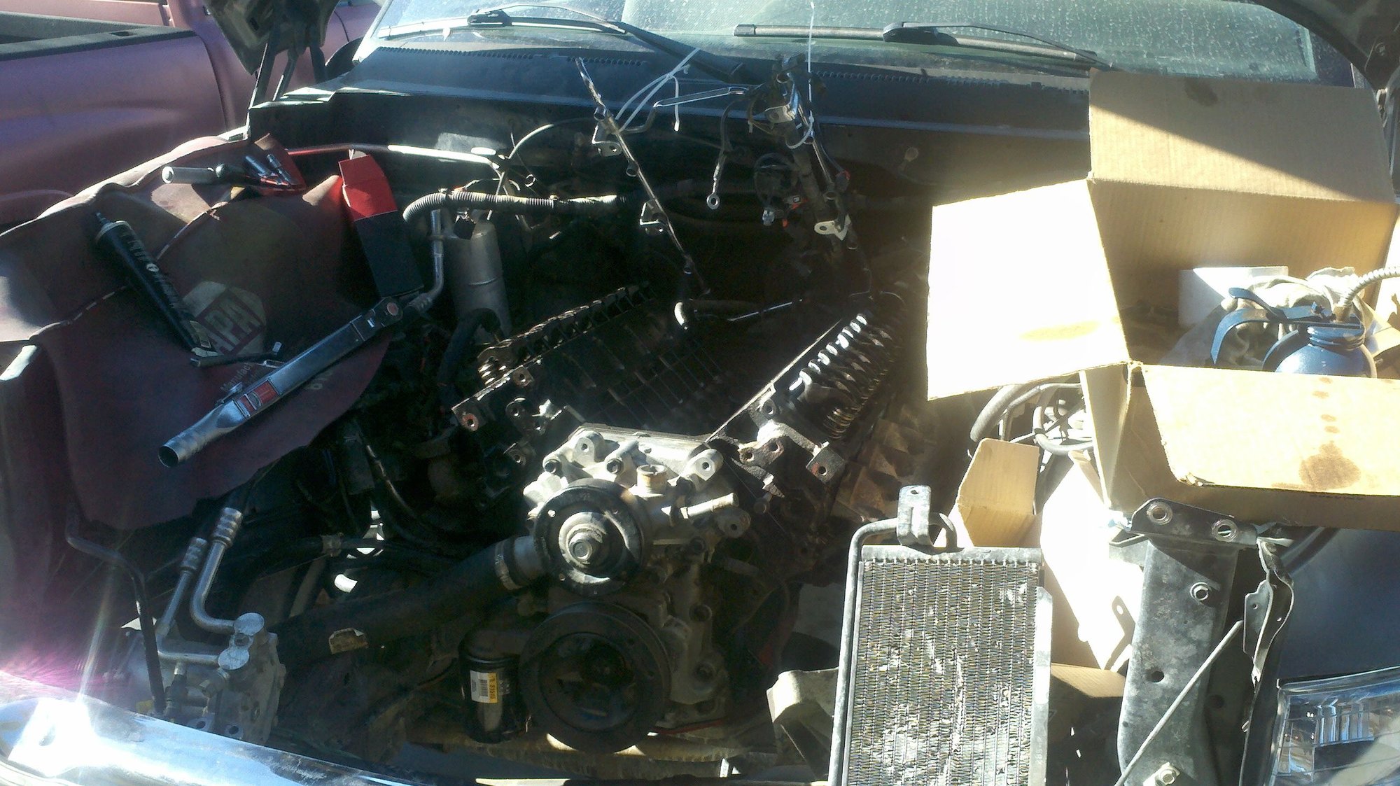

I cheat. I completely strip the front of the engine, pull the radiator, that's the way I was taught. I can easily sling these heads myself, (well maybe not "easily"), but I get it done no problem. I can stand on the steering brace/sway bar and reach the back. I can also sit on the bumper for the work in the engine box, much easier.
The blue tape keeps small parts out of the engine. Years ago I dropped a small bolt down an intake. A magnet taped to a piece of copper wire fished it out, but not until I (twice) s**t myself worrying about it. Your life would suck if you did that not realizing it.

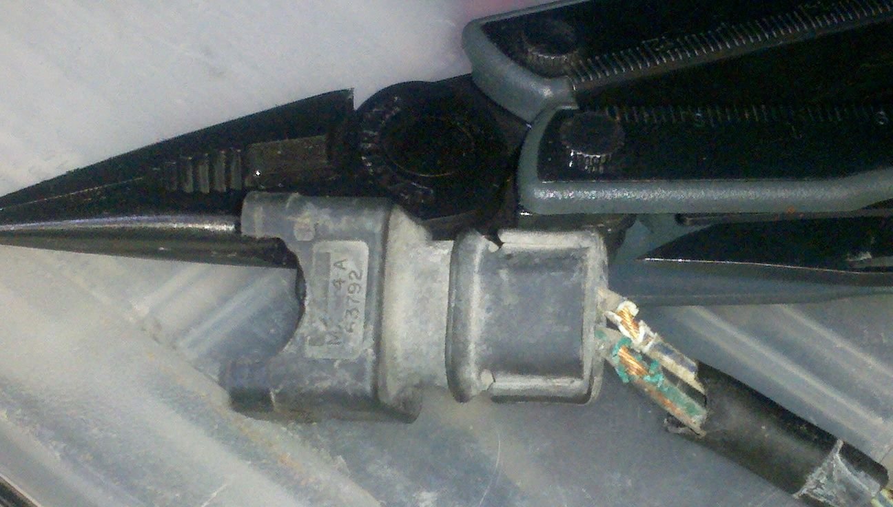

When I talked before about wiring, your problem was the truck not running, and this is one of the types of things I was talking about. This is an injector connector. I had a problem with one on cylinder six, but the wires could actually touch, intermittent operation. A ground anywhere else might lead to an injector that sticks open. As you can see in the prior picture, I've been replacing the wire connectors.
I use a piece of vacuum hose split lengthwise to hold the intake bolts out of the way for installation. If you go to HughesEngines website, you will see this throttle body. I had them rework it for me, first one they ever did, but very similar to the small Magnum ones the already produced.

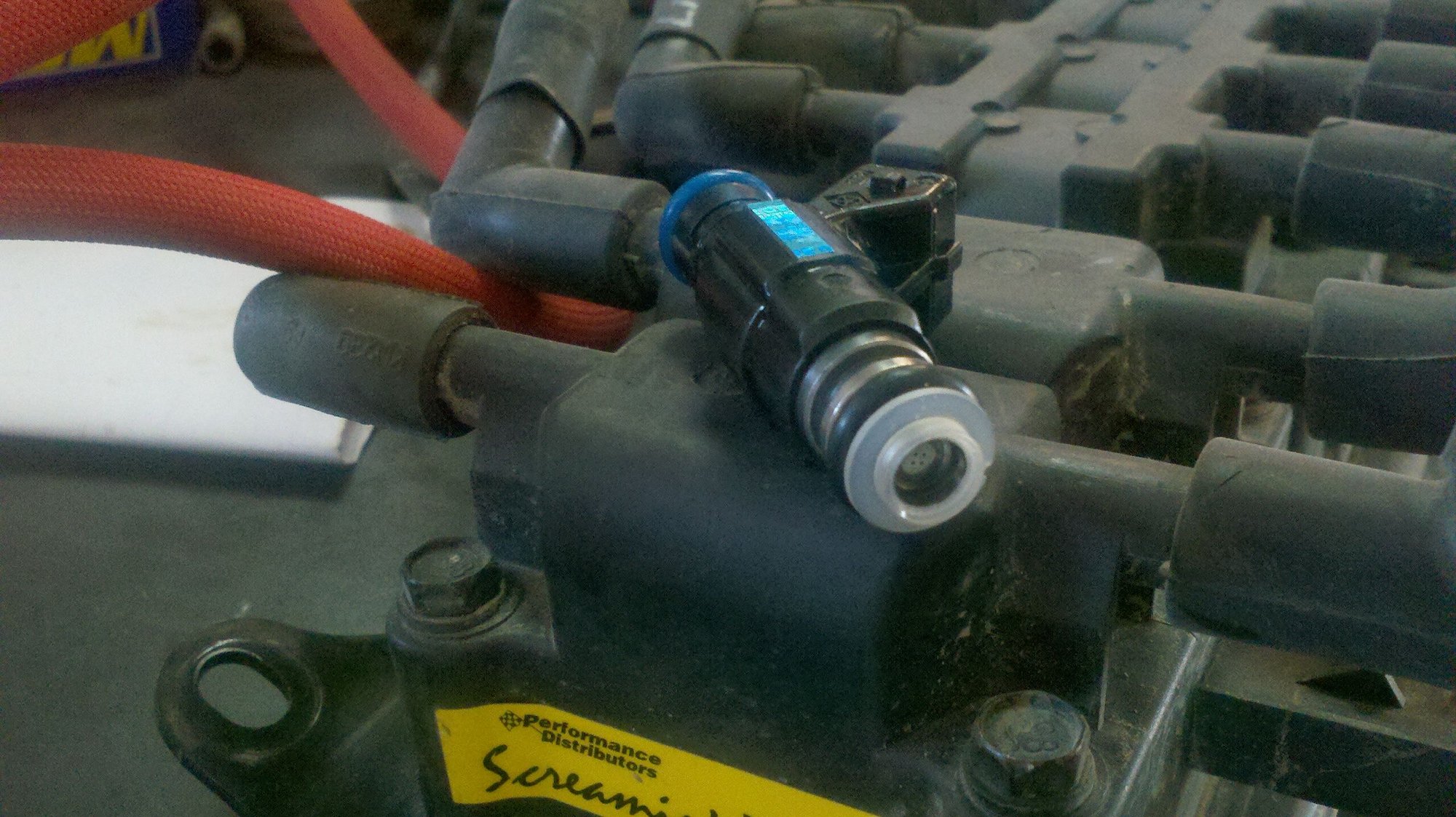

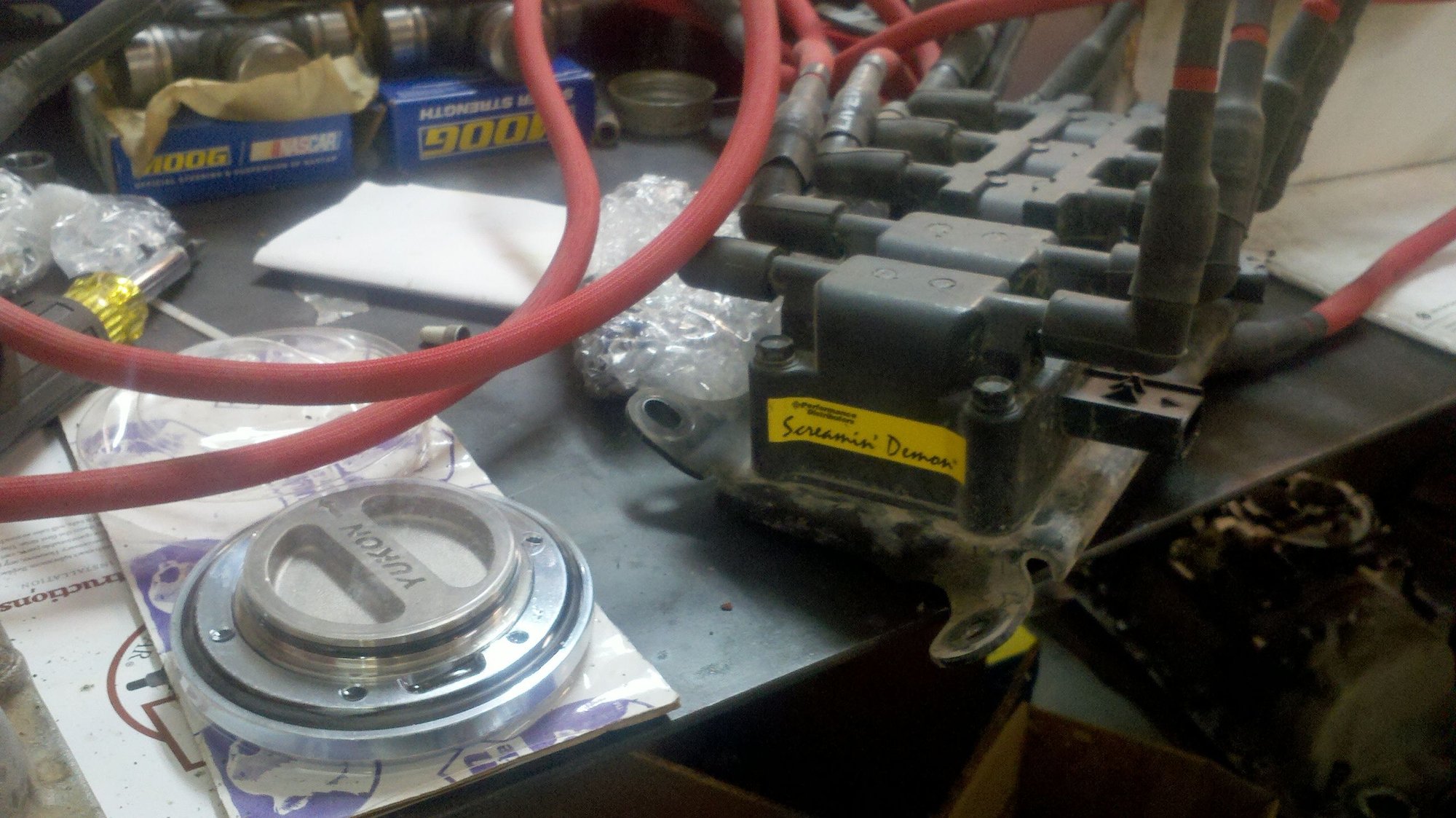

Davis Unified makes these coils for the Viper, but they work just fine in an OBDI '95 if you read the wiring pinout and change the harness. The LiveWIres for the Viper don't really work, even thought the sales gal told me they would. That is a four hole injector "upgrade" for a '96-'98 style injector. I installed a newer manifold, bypassed the EGR, to use some of these injectors I had rebuilt by Dr.Injector out of Sacramento a few years back. This particular one is from a couple of sets I bought rebuilt off of Ebay for spares. I have a pretty good stash of some of the stuff unique to these engines, especially gaskets/sensors/wiring. Some of the wholesalers/retailers are getting out of the V-10 business.

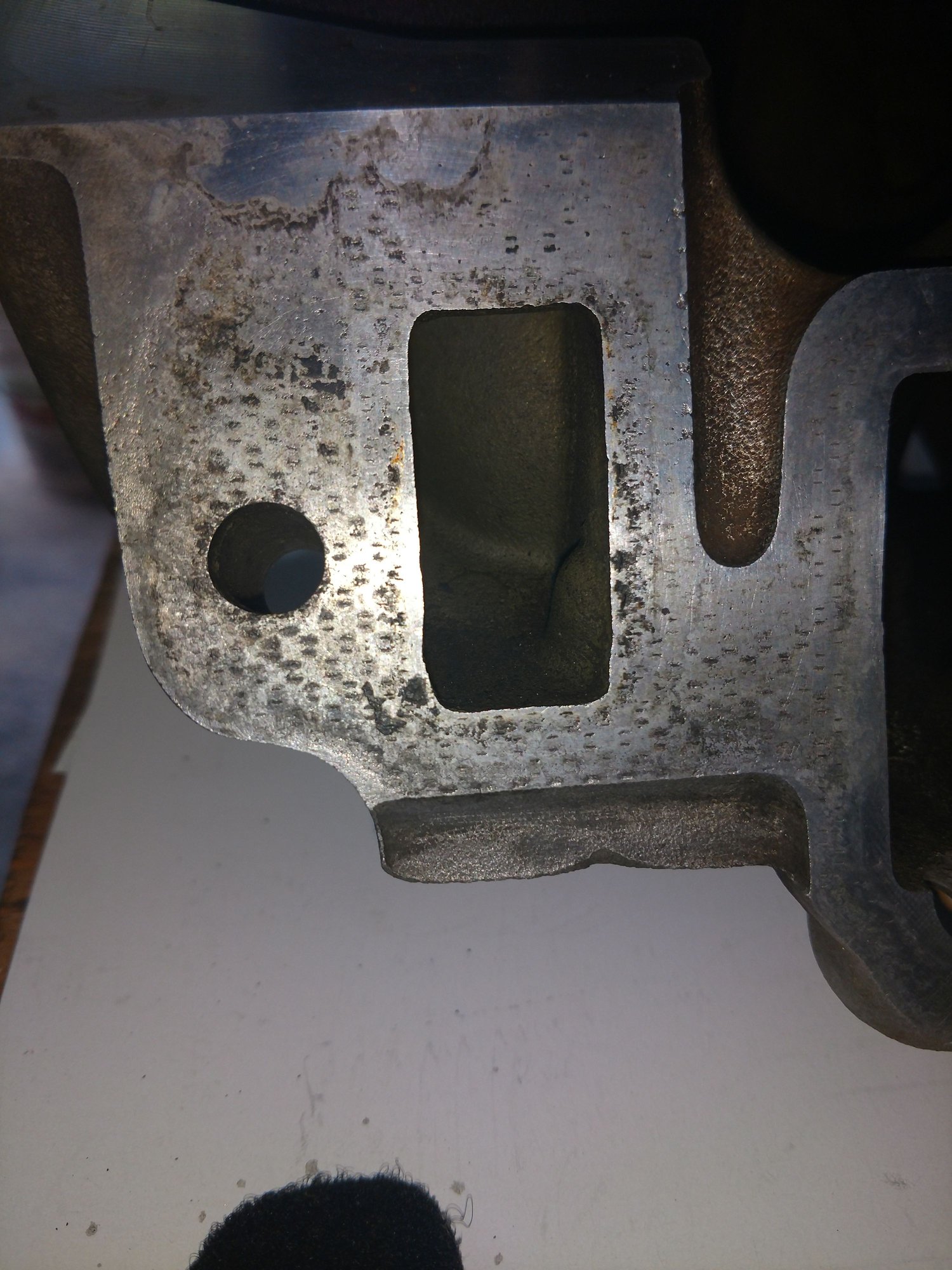

I can see electrolysis on the thermostat housing mounting surface of the manifold? Didn't know if it was the imperfections of the mold out of the foundry or if it really is electrolysis? This thermostat housing has always seeped a bit of water! Took it to a mechanic and he overtightened it and cracked the housing! Still charged me $200 bucks!
