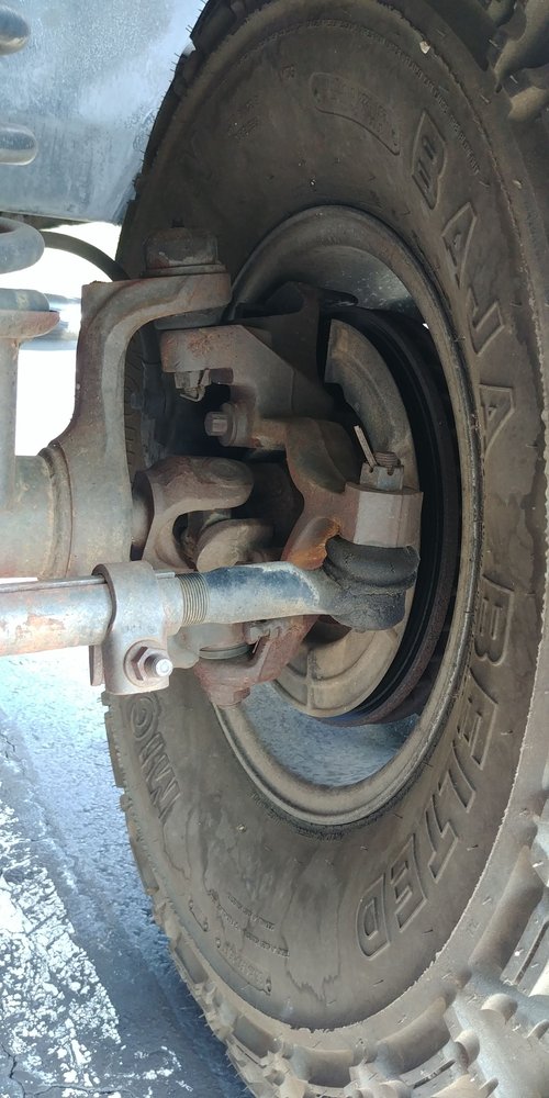

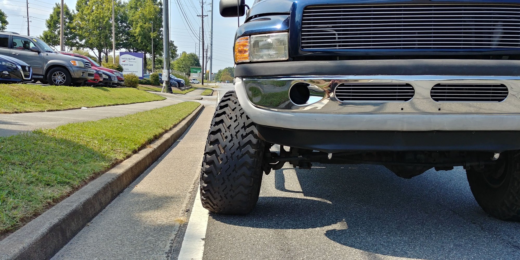

Right now I'm having problems with my front wheel hub and bearings. I was driving home from Home Depot last weekend and only going about 35-40 MPH and it felt like my tire was about to wobble right off. I pulled over and sure enough my passenger front wheel was bent out, looked like it was about to snap off. I added some pictures so you can see what's going on.

Parked, broke down in turn lane....
passenger side that is broken

It looks like the brake caliper is the only thing holding that puppy on. Definitely replace both sides. The other one is the same age and mileage. The right one probably got a hard shock at one time which is why it failed first. While you're in there, yes, check your shafts and CV joints/ The lift puts extra strain on them. Any ripped rubber means that one needs replacing.
