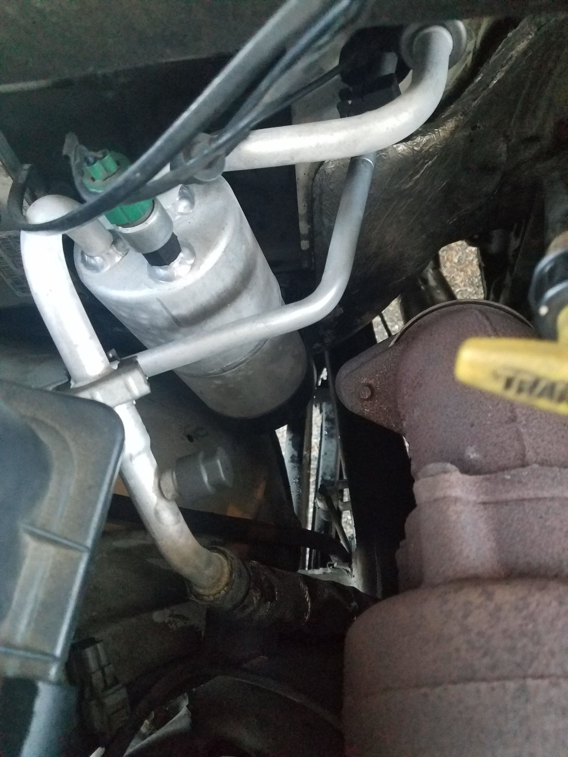

Thanks. I ran motor and again same leakage dripping down from firewall just behind that canister. I see the heater hoses and those stainless hoses and quite why that canister is getting iced over when im calling for heat i dont know. you may see coolant on that strut down there.

I think you are running the AC and seeing the drain for the AC
