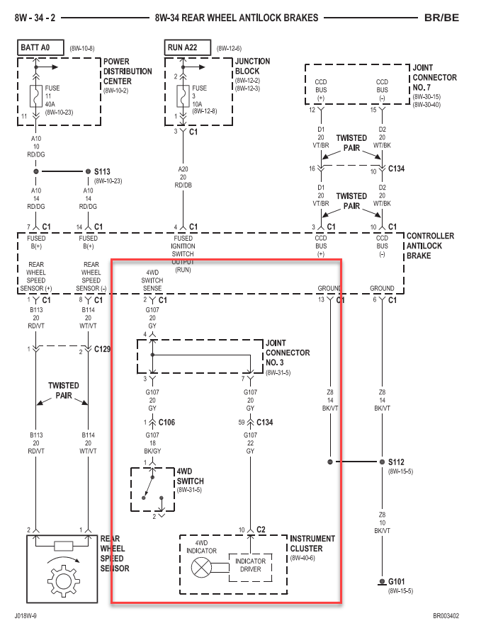

Actually it looks like the ABS gets the signal directly from the 4WD switch like the cluster does, here is the diagram:
Here is the wiring for the actual 4WD switch itself, too:
The ground goes to that "Joint Connector #4" which is a ground for a couple different things.
Using all data the FSM does have some inconsistencies. Even my DRB Scan tool tells me the PCM gets a signal for 4wd. I'm just trying to help

I just went out and checked continuity between the signal pin at the 4 wheel drive switch connector on the axle and all of the pins on the three PCM connectors and didn’t get any connection. I did it twice actually, once with the abs computer connector plugged in and once with it unplugged, too. I did get continuity between the two at the abs computer, which matches the wiring diagram. I see the abs computer is connected into the CCD bus, I wonder if the 4 wheel drive status gets into the system from there.
Absolutely it does I thought that was established. A lot of information goes into the CCD. The 2nd gens also used PCI and CAN towards the end of 01 into 02 (2500s)
