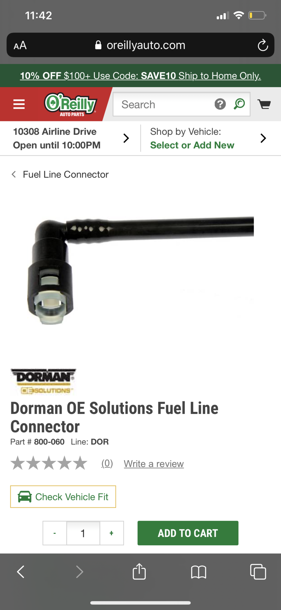

The quick connect fitting that goes to the fuel pump rotted off. Can I repair it with Dorman’s 5/16 connector? They look identical, but not sure if it fits the line or the fuel pump assembly. According to the vehicle fitment guide, it doesn’t fit, but they’ve been wrong many times. I’d like to buy a new line, but they’re obsolete.

Isn't the fuel line 3/8ths?
Get a look under there, and see what the actual problem is, before spending money.

InlineTube sells the plastic fuel line with the 90° connector or SSTubes sells the whole brake line

The fuel pump connector is 3/8 and the fuel line is 5/16. I used a gasoline hose, clamps, and a quick connector to repair the line. Even better than the cheap, OEM nylon tube.
