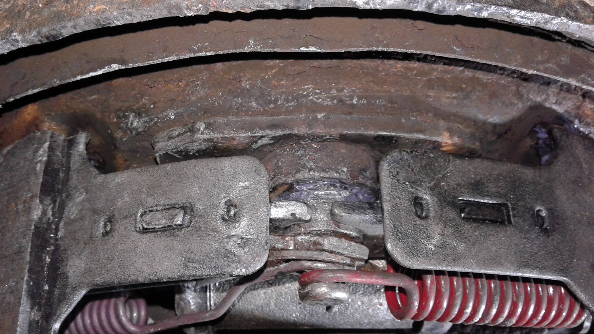

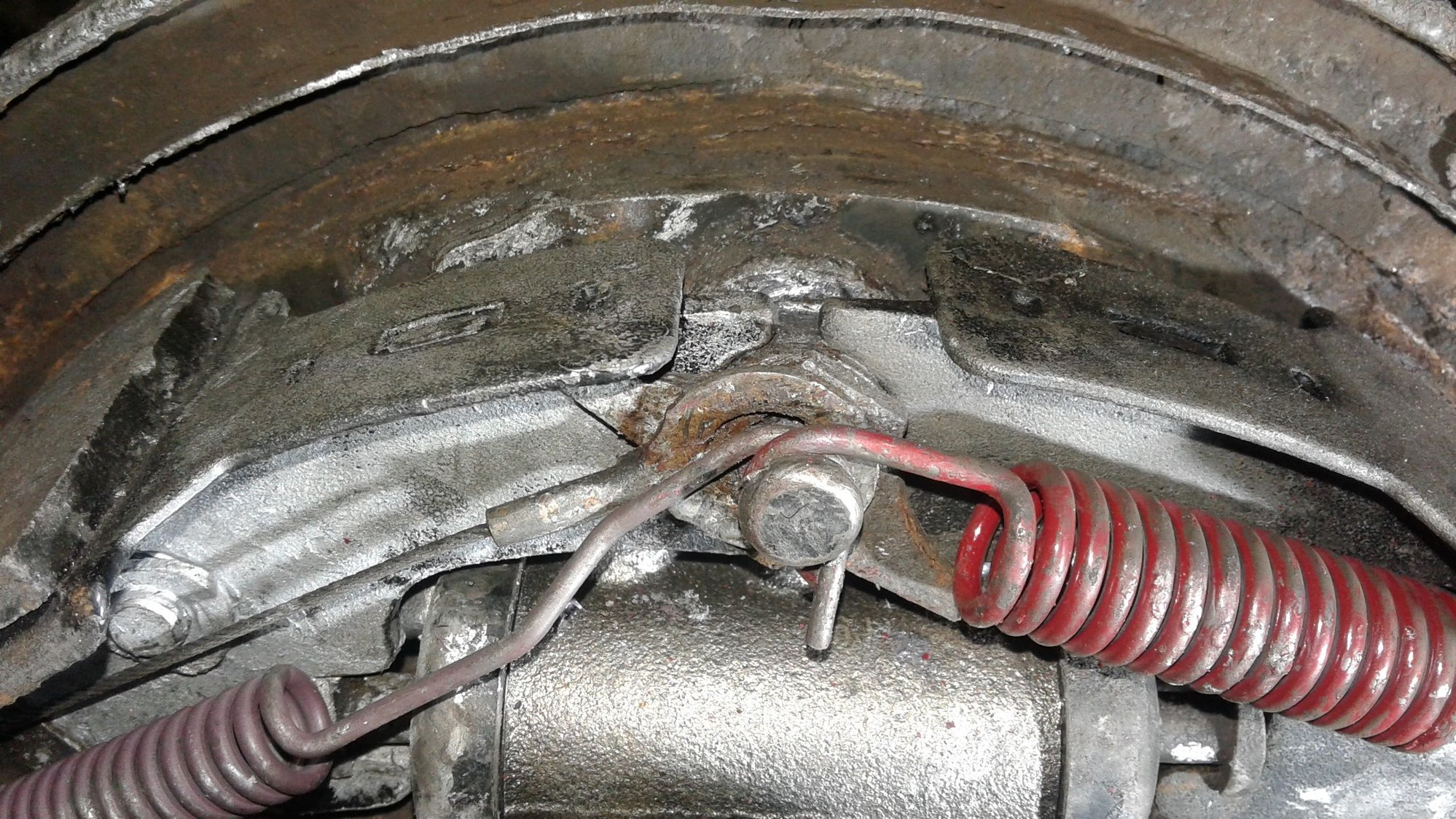

Comet424
You appear to have the primary shoe in the correct (facing forward) position .. but I am not sure of that.
Your anchor plate, at the top of this pic is inverted. That may cause the brake shoes to be spread just enough to cause your problem.

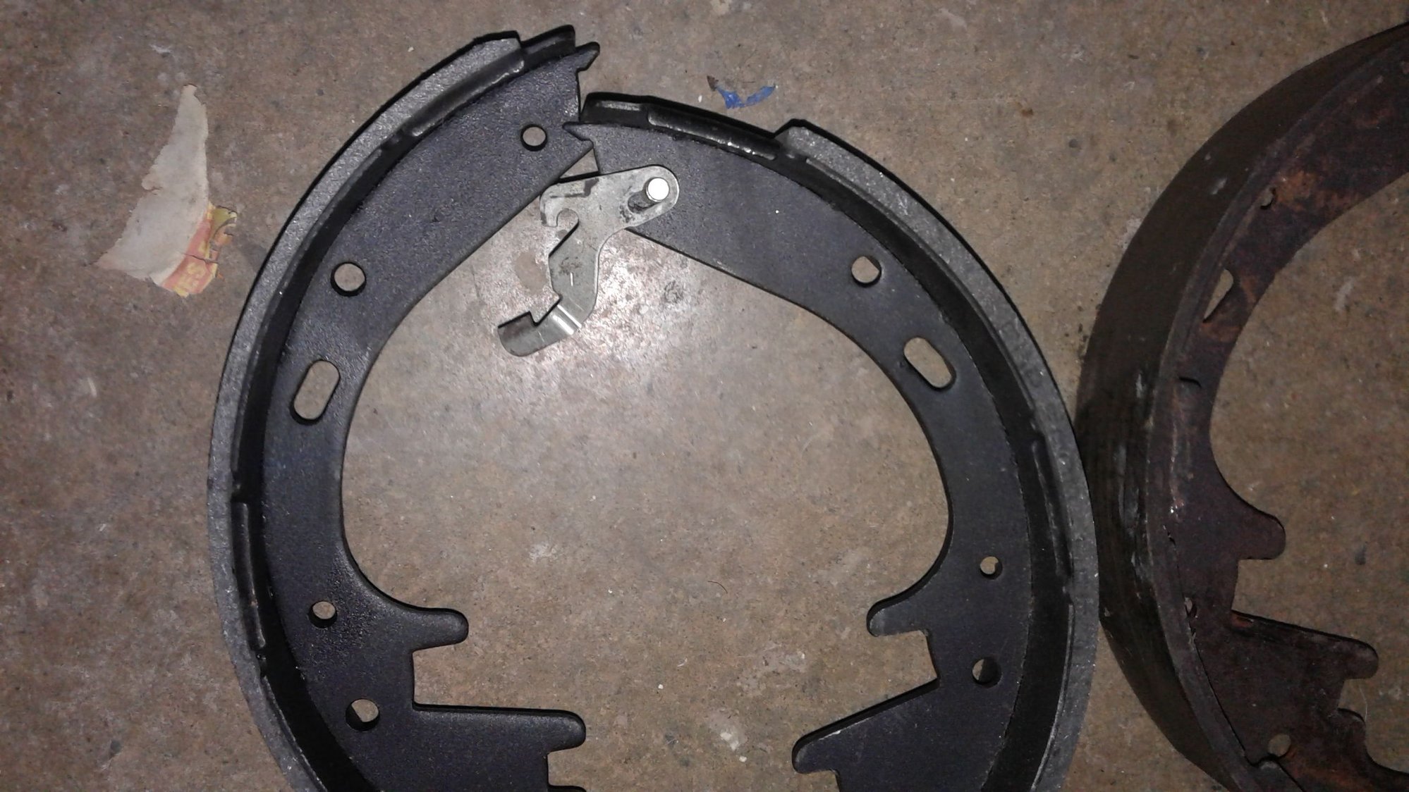

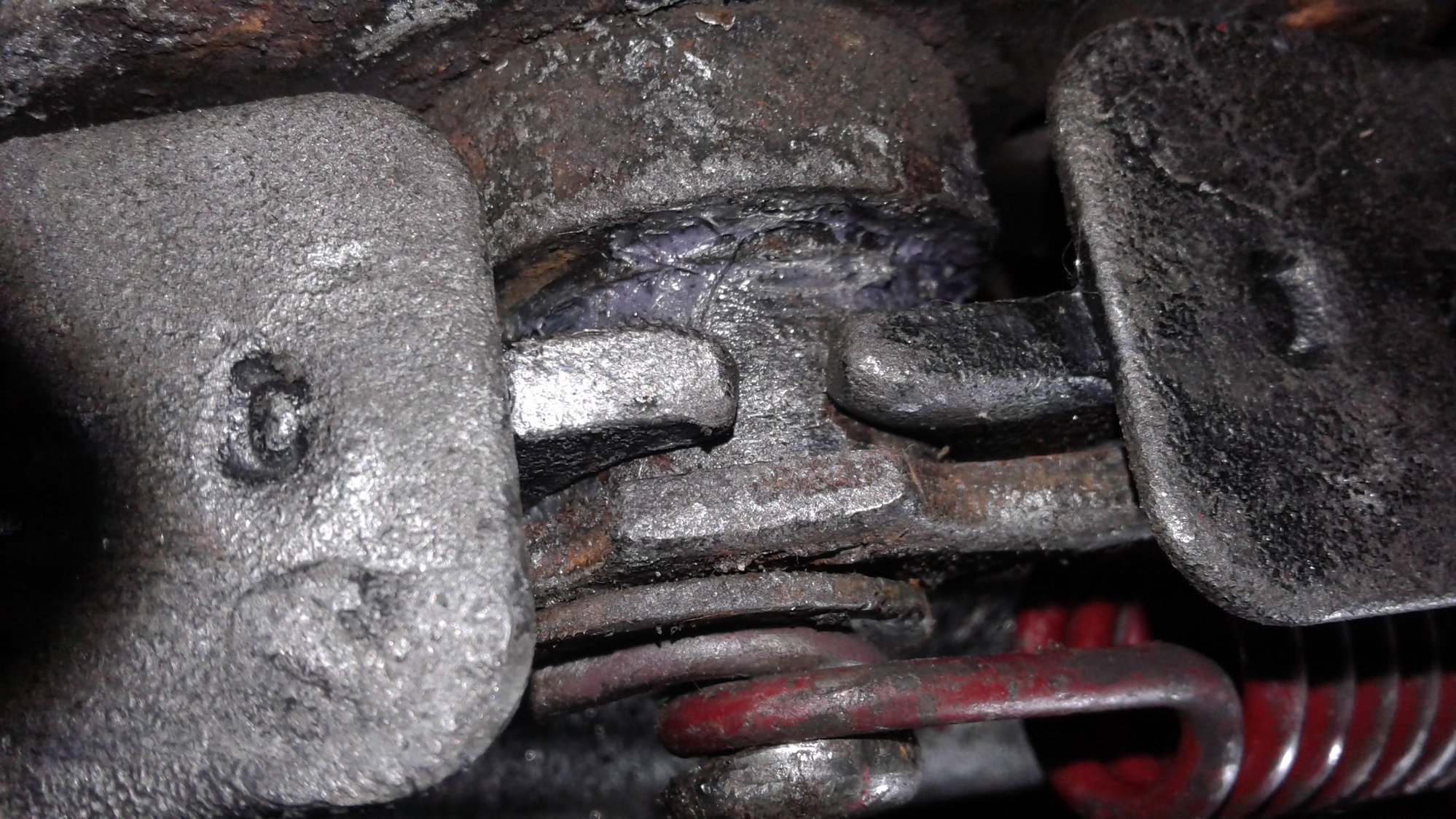

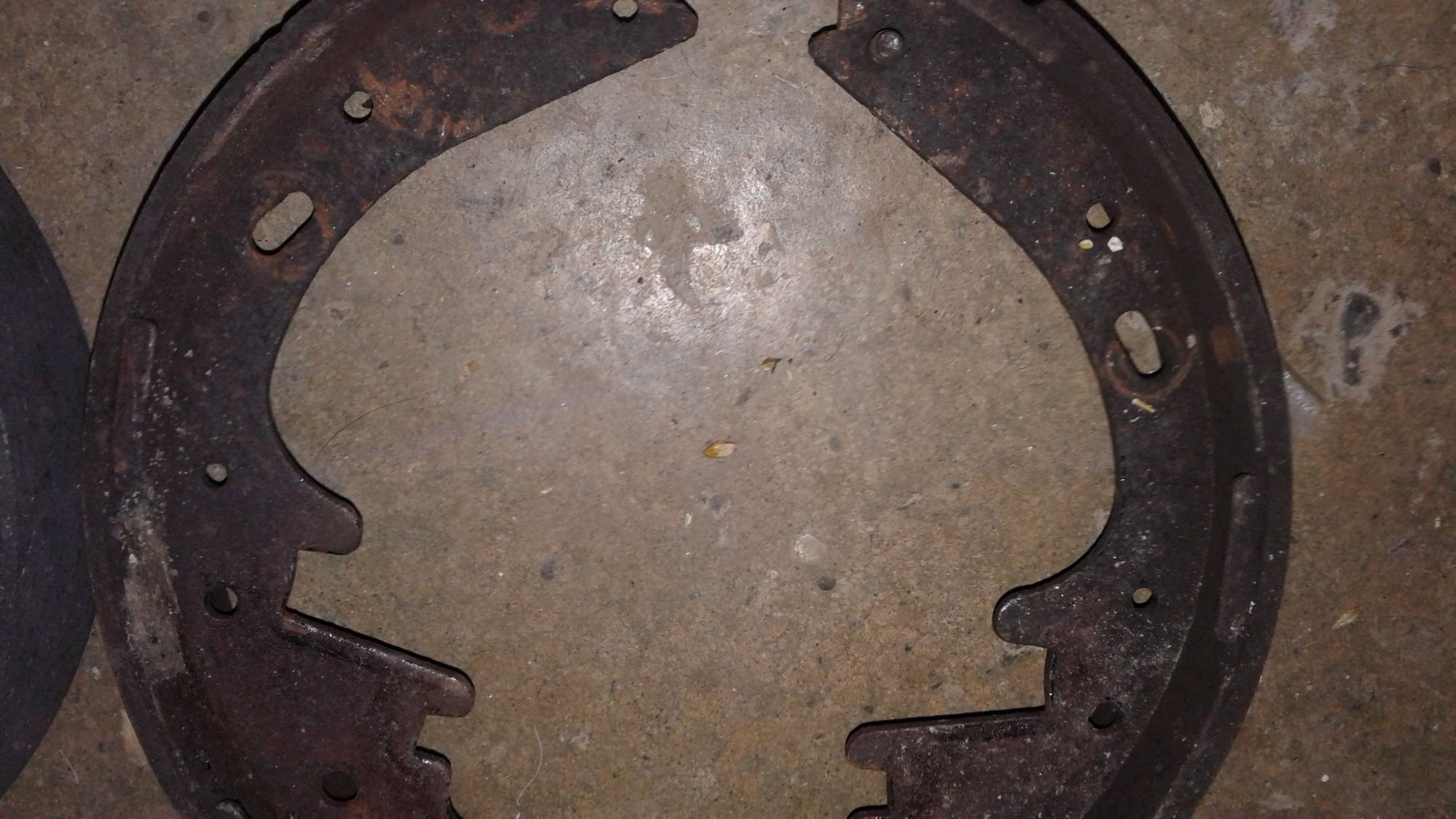

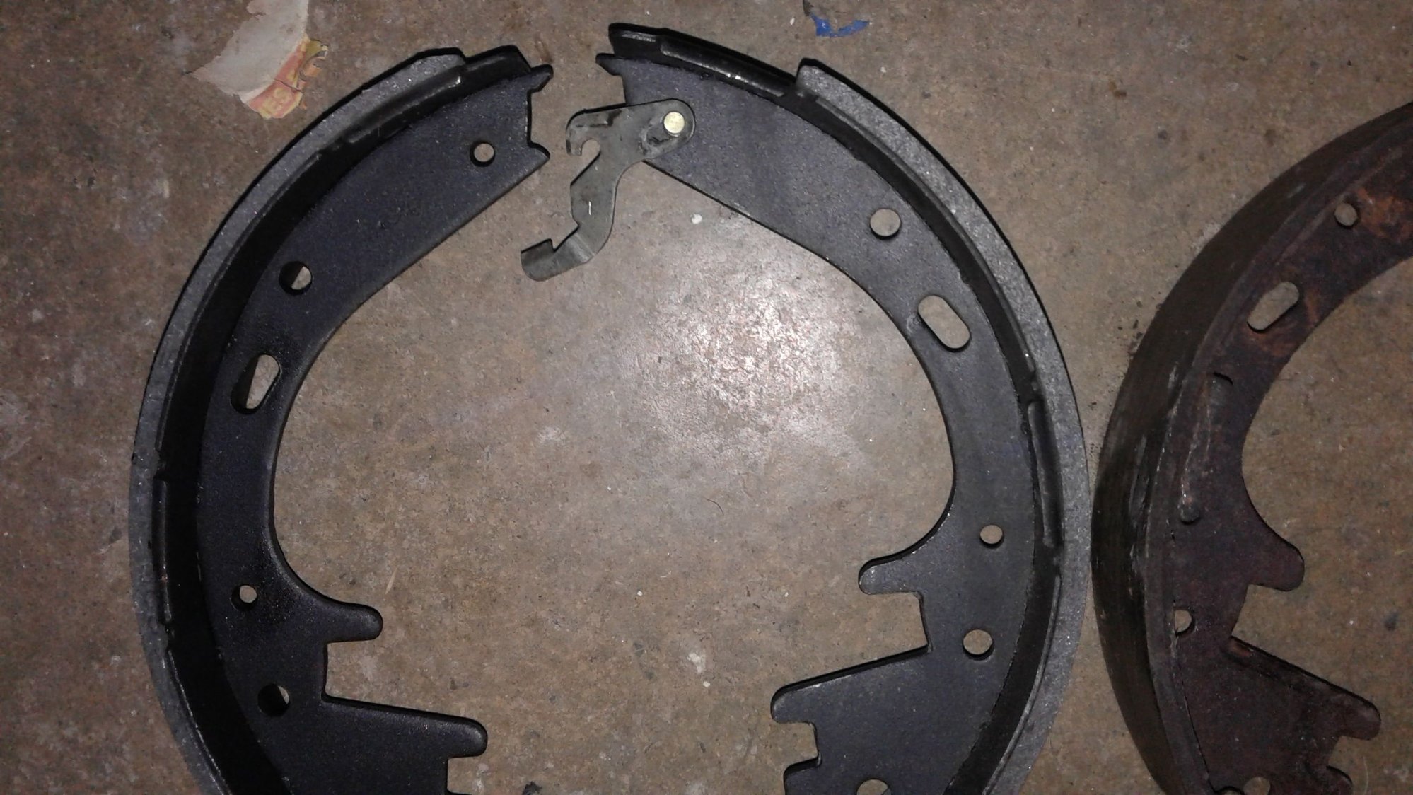

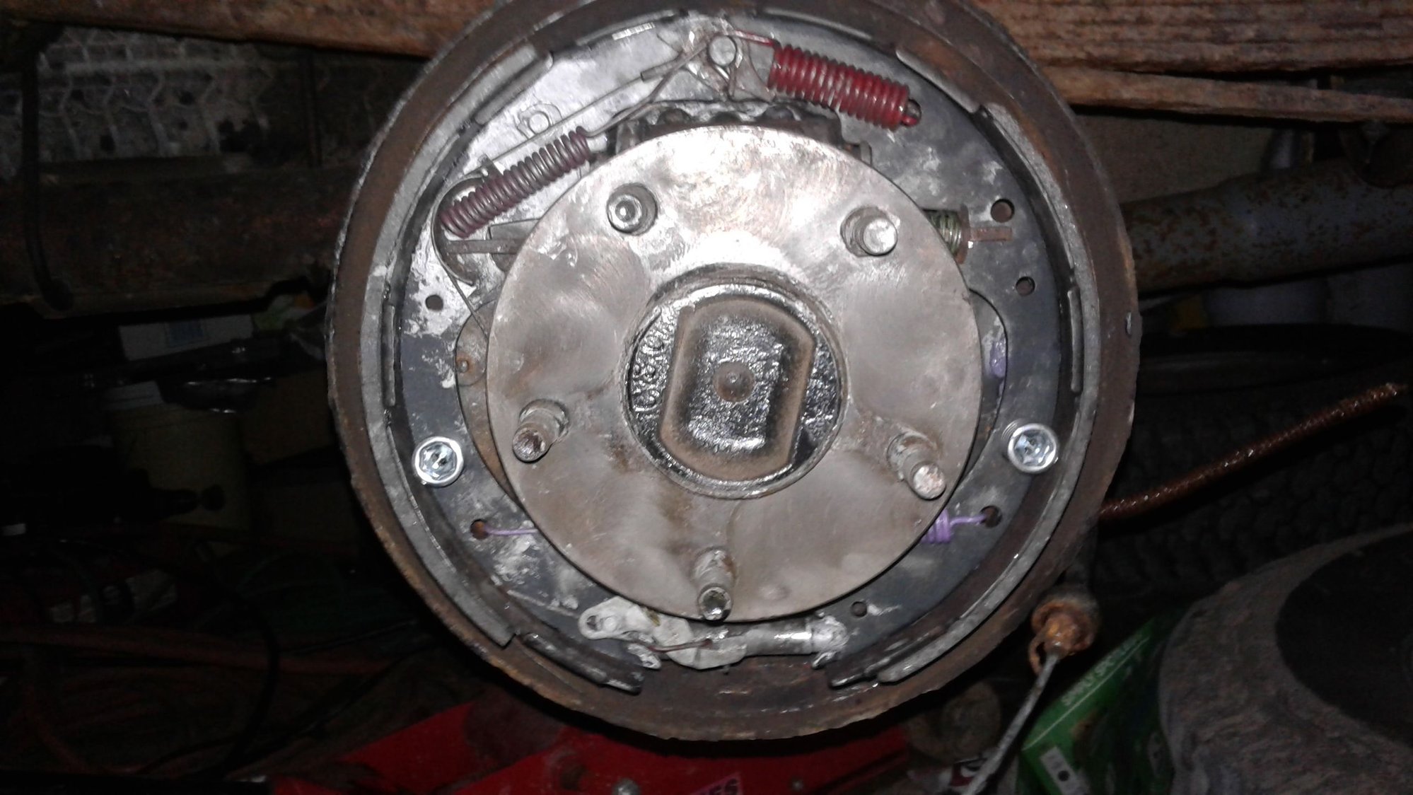

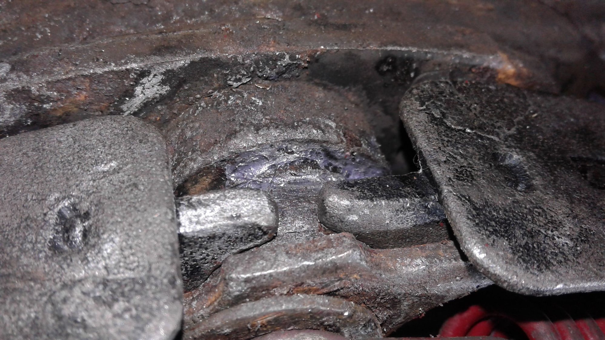

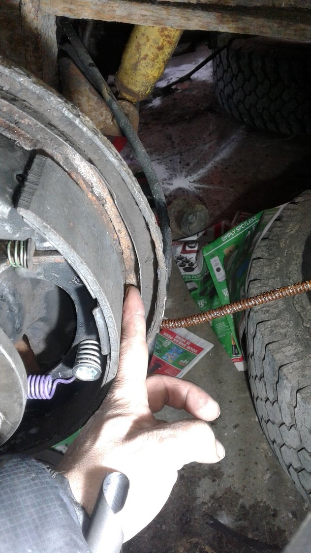

so flipping it didnt help.. drum still wont go on.. and why doesnt the Clip go on that post like i mentioned before.. are there different sizes... as i was gonna tackle filing it to fit over the new shoes.. but its like its an older version then??
but ya flipping it didnt do nothing here some pics still cant get the damn **** on.. i used my finger to size it and i took pics of the old brakes
i gonna try to really wire brush it all till i get it really clean... as i dont work on these everyday.. so i dont know whats acceptable tightness or not i just follow youtube videos but they show slides on perfectly smooth and u gotta adjust it several times.. here its completely turned in and yet
its tight so hmmm
