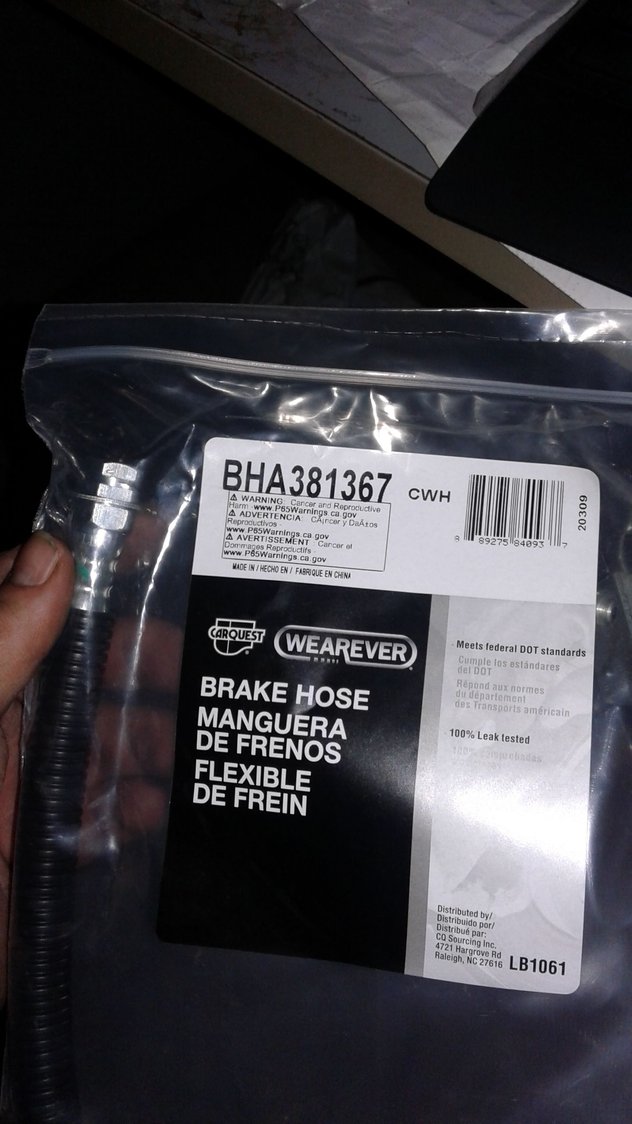

so another question i cant get that hose off that old bracket is so rust up there.. and i see its a bolted on bracket.. so i pb blastered both sides.. of the bolt well what i could reach.. but looking at the new one..
i cant reall make a new one.. this is a Hex not a circle so i cant drill a hex lol

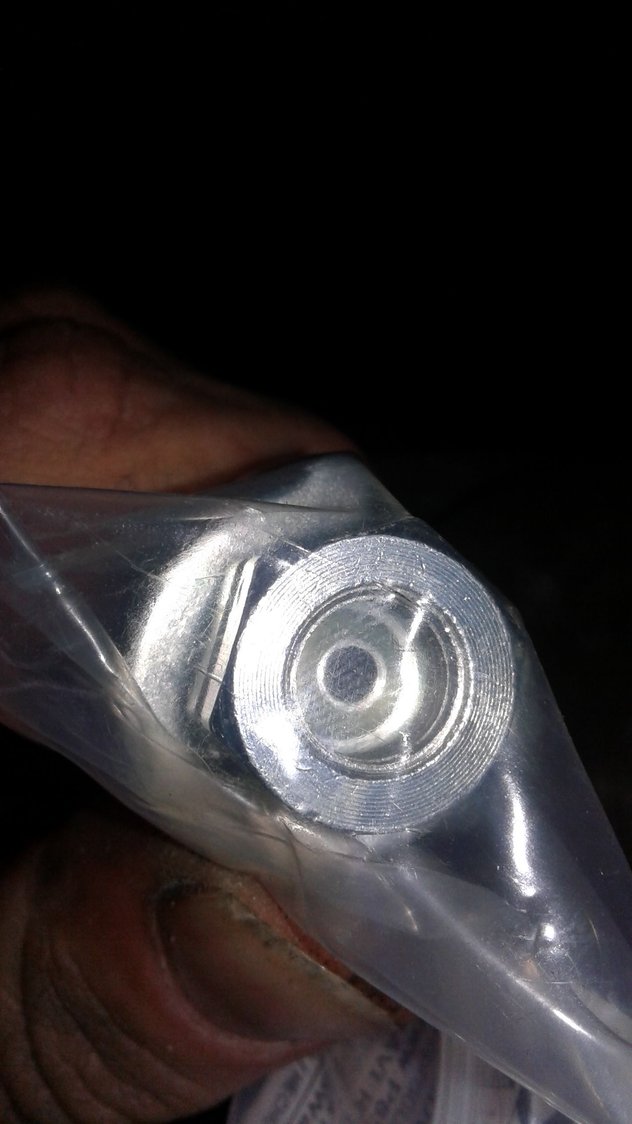

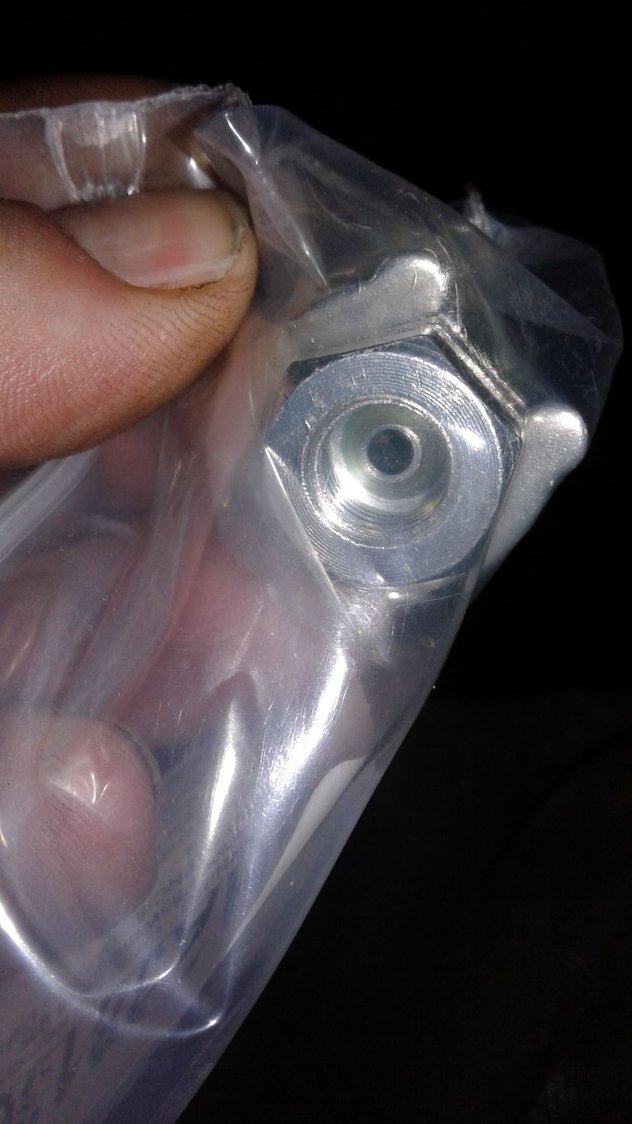

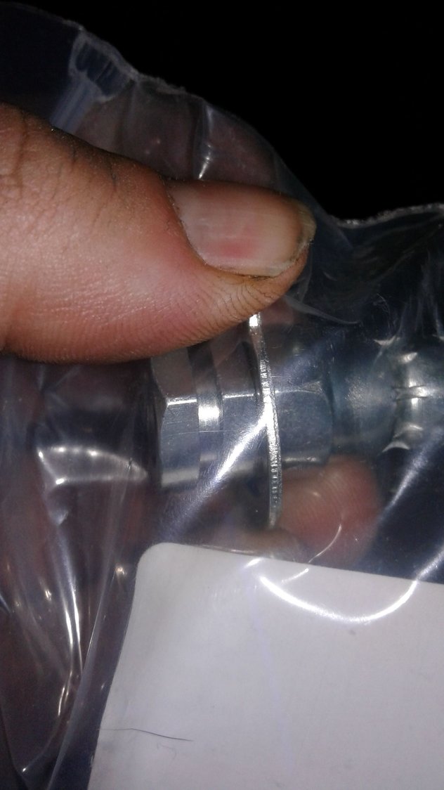

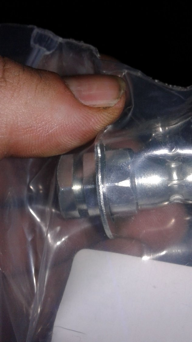

can you buy a new Bracket to hold that hose ? how does it hold in there.. as looking at the new hose .. it just has a c Clip but you cant stop it from moving forward or back but then i see it has 2 slots but only comes with 1 Clip maybe its supposed to have 2??​​​​​​​

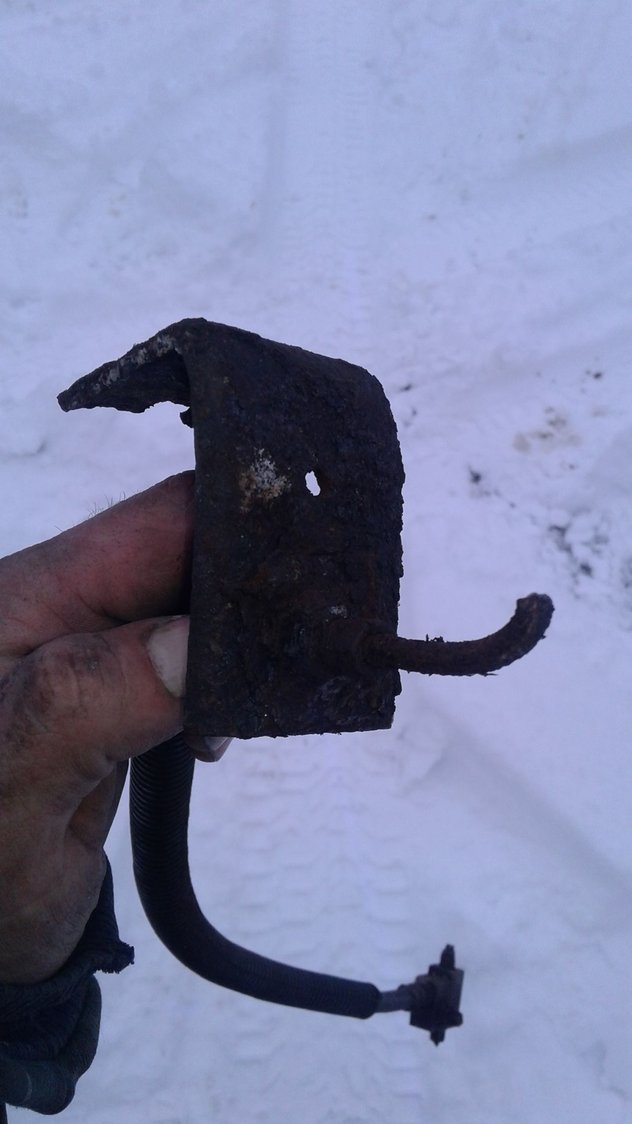

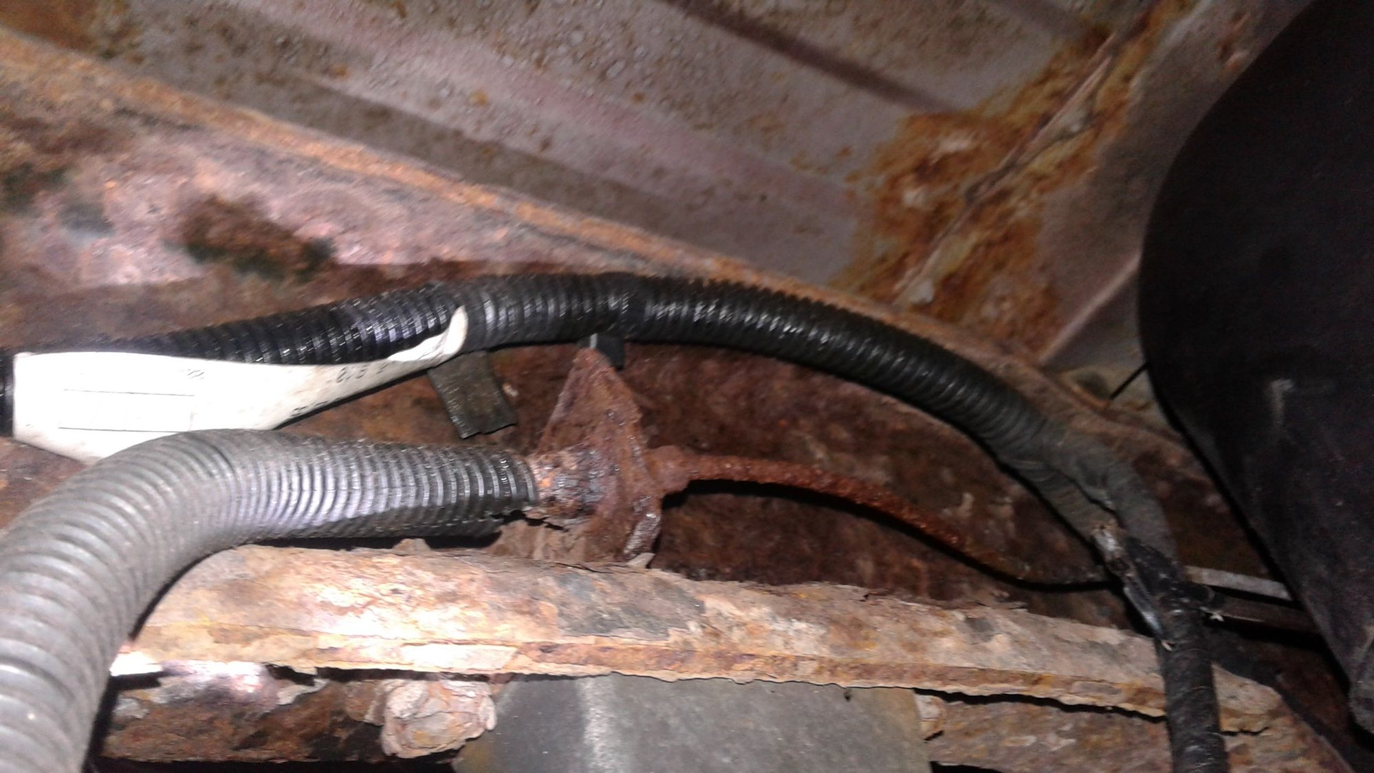

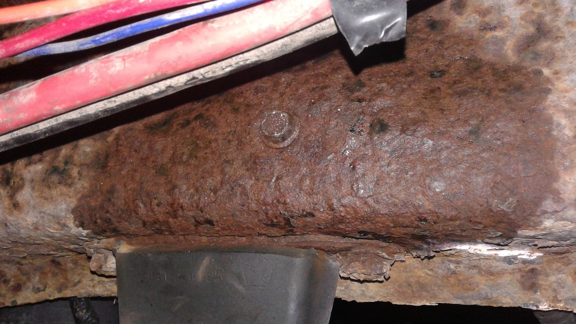

so pb blaster isnt helping i tried to pry the old brake line out of the bracket but its not working either figured chip the rust away
was thinking to ziptie the line but its probably gonna still make the brake line to flex... anyt suggestions was gonna try heat but dont think little propane bottle will help

Wow.... that is REALLY corroded. The line coming back doesn't look so good either. I would be tempted to replace that now, while you are right there. (and, it has to come apart anyway.....)
Not sure you can even get that bracket any more... maybe from a junkyard in the southwest, where rust isn't quite an issue? I think the bracket has a hex hole in it, that the line inserts into, and the clips hold it in place. Did they give you a loose clip? I don't think the one that is on there is going to be re-usable......
But, cut the line, near the nut. (hard line) drown it in chemicals for a day or three, then use a six-point socket on it, and see if it will come loose. If not, just try and get the outer clip off, and pull the the soft line with that fitting still in there..... Get a long enough section of brake line from your local parts store, and replace it all the way forward. Should be able to get the out clip off the line, and see if it will separate from the bracket....

ya welcome to canada where we use alot of salt.. actually i already ran a line.. it probably not in the pic.. im trying new type of line the copper kind.. it bends easier and supposed to last longer.. then the green painted lines.. i using the steel ones for the left and right for the front and the back.. and the copper from front to back.. maybe i take a pic of the trailer hitch tommorow or so maybe you can tell me if its still in pulling shape of its its no good..
i thinking of grinding off the bolt and punching it through i tryied bolt extractor and it was spinning no matter if it felt tight by hand

so i cut the bolt off and punched it through i emailed chrysler if they can get this part but it seems that it has like a backing or so
but i got it soaking in water/muradic acid now
