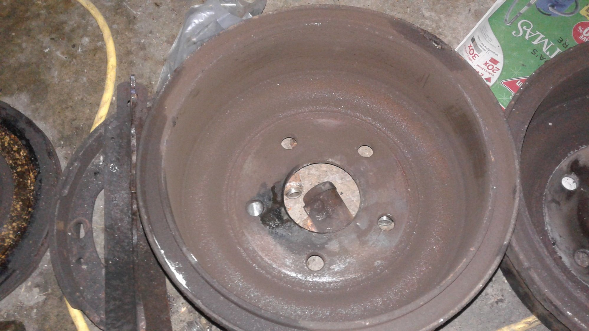

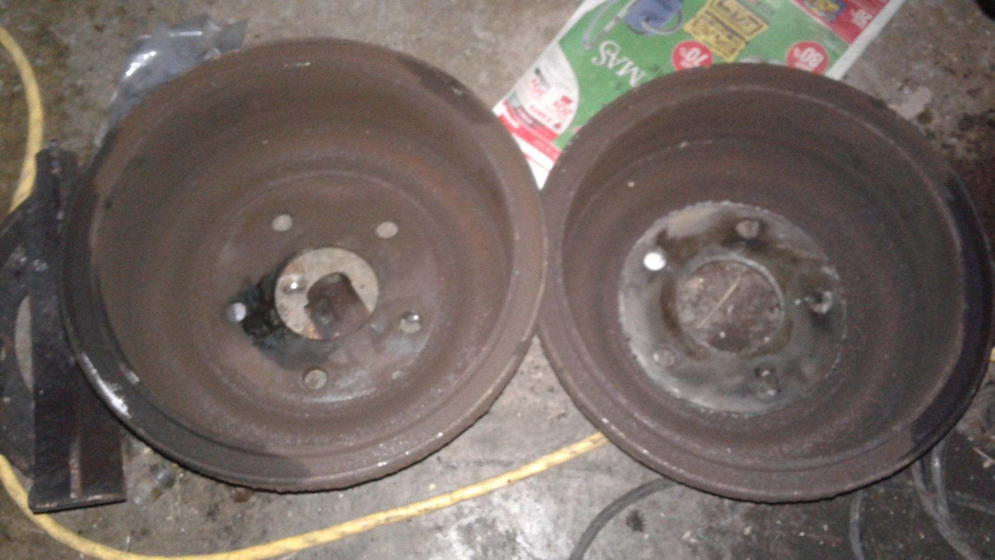

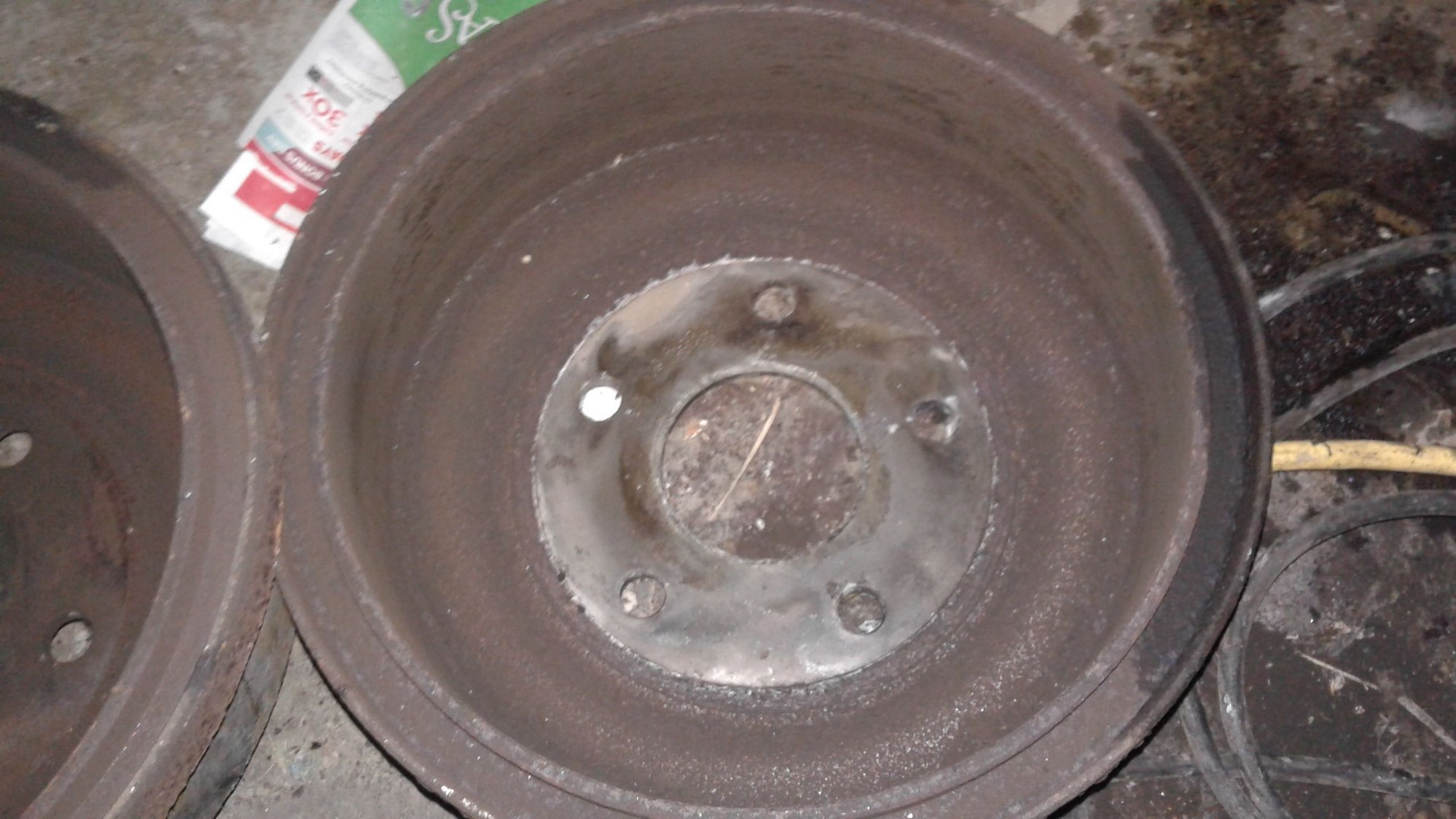

i dunno ? i measured the drum in the one pic its a 10 15/16 or could be a 10 7/8 inside and i dunno for the the pads

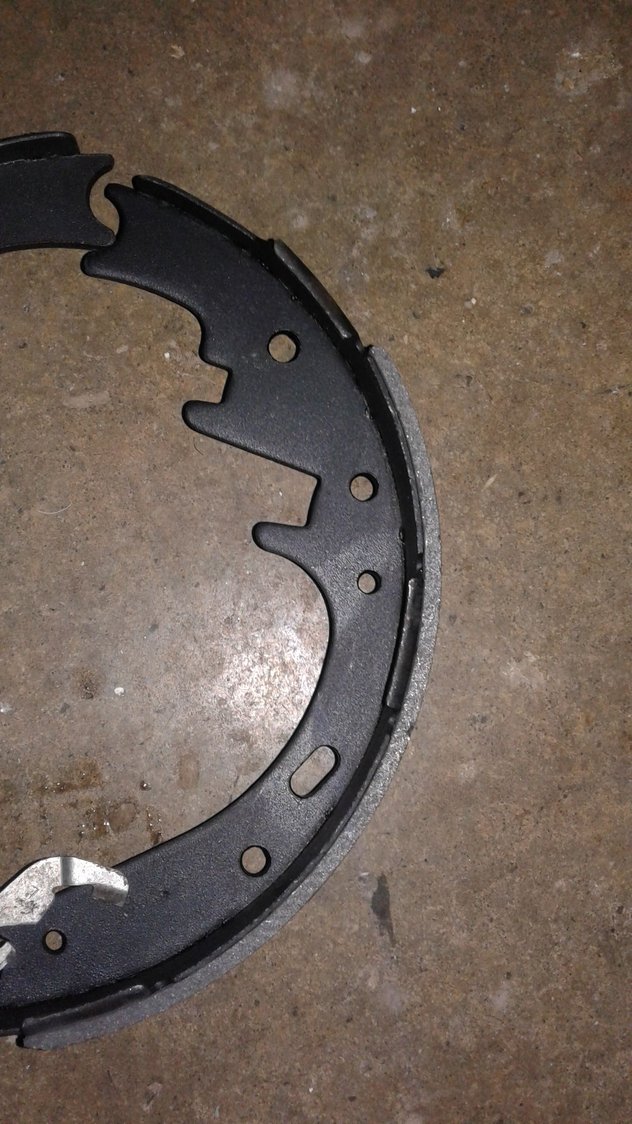

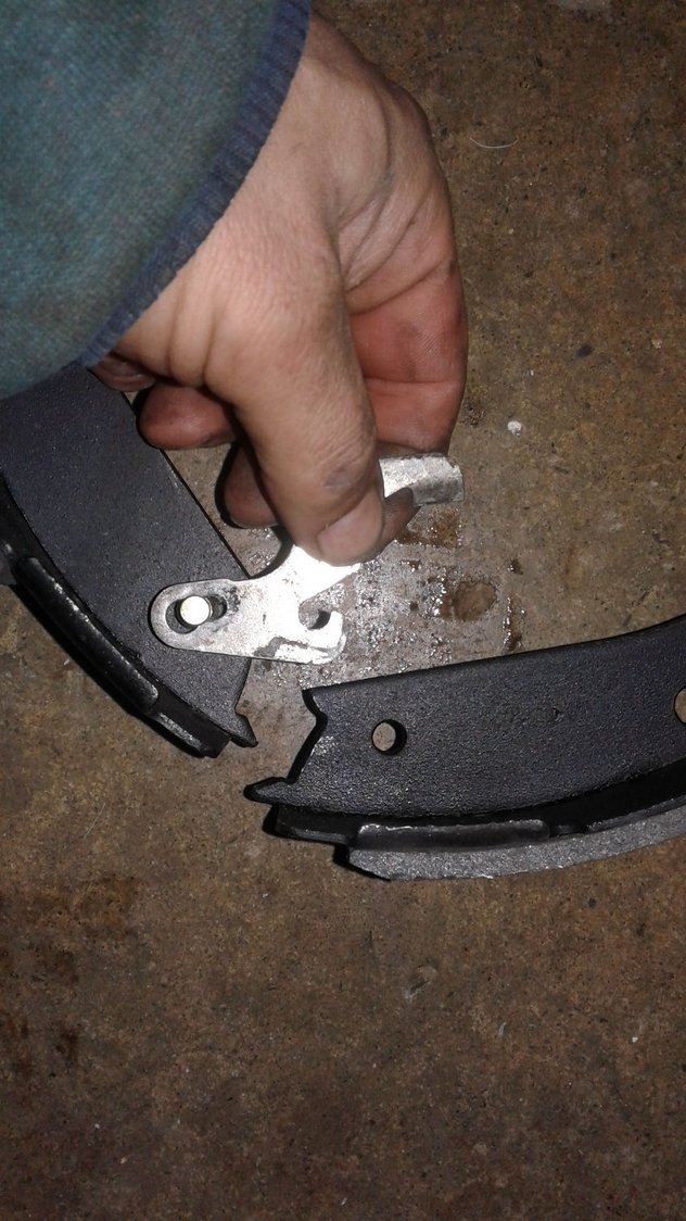

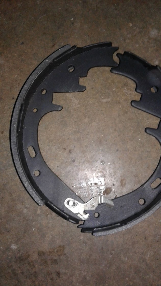

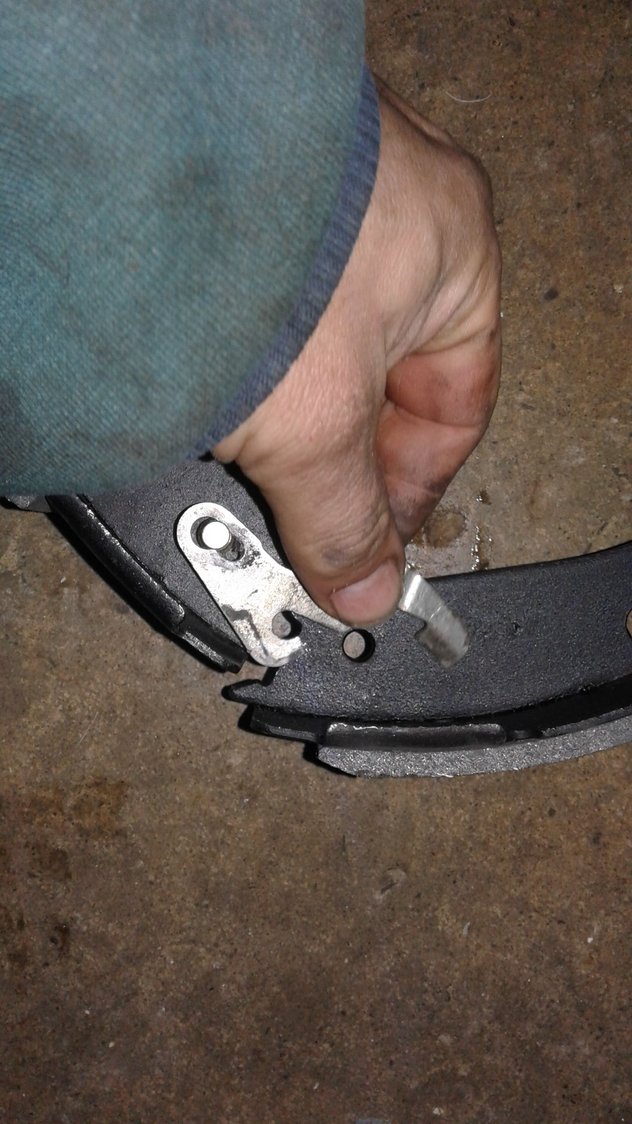

i bought 2 of these boxes from car quest i dunno if that helps u
reason being the Clip that goes on the pin for the adjuster to pivot on wouldnt go on.. the 2nd box 1 would go on.. so out of 2 boxs 4 shoes with the adjuster pin 1 would go fit.. so i was going to file the clip so the clip would fit in it
i dunno if its the wrong brakes then or what?

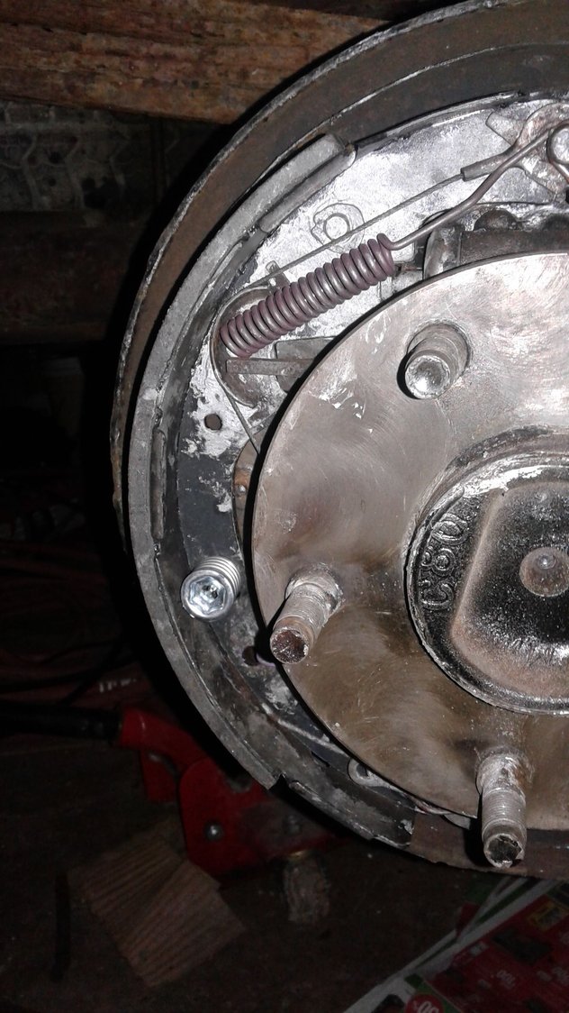

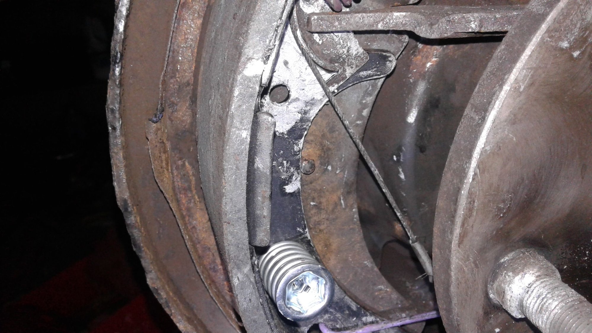

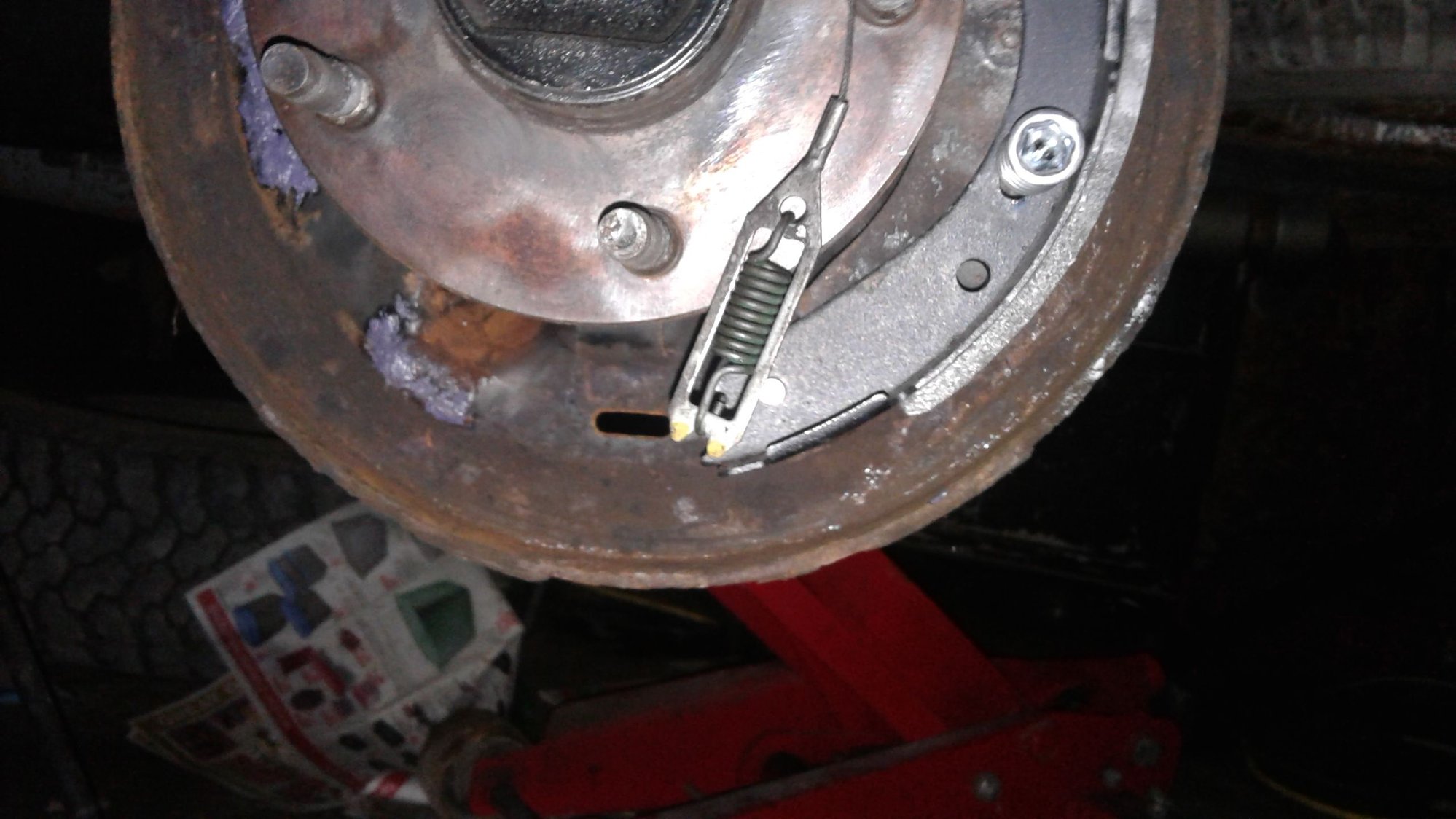

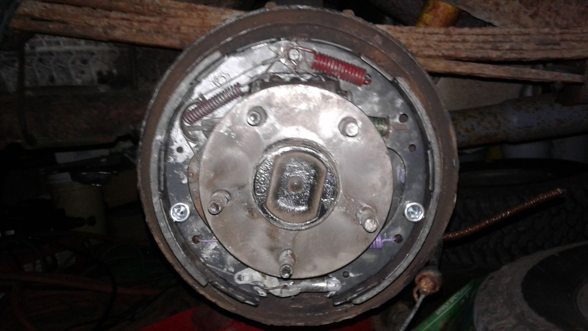

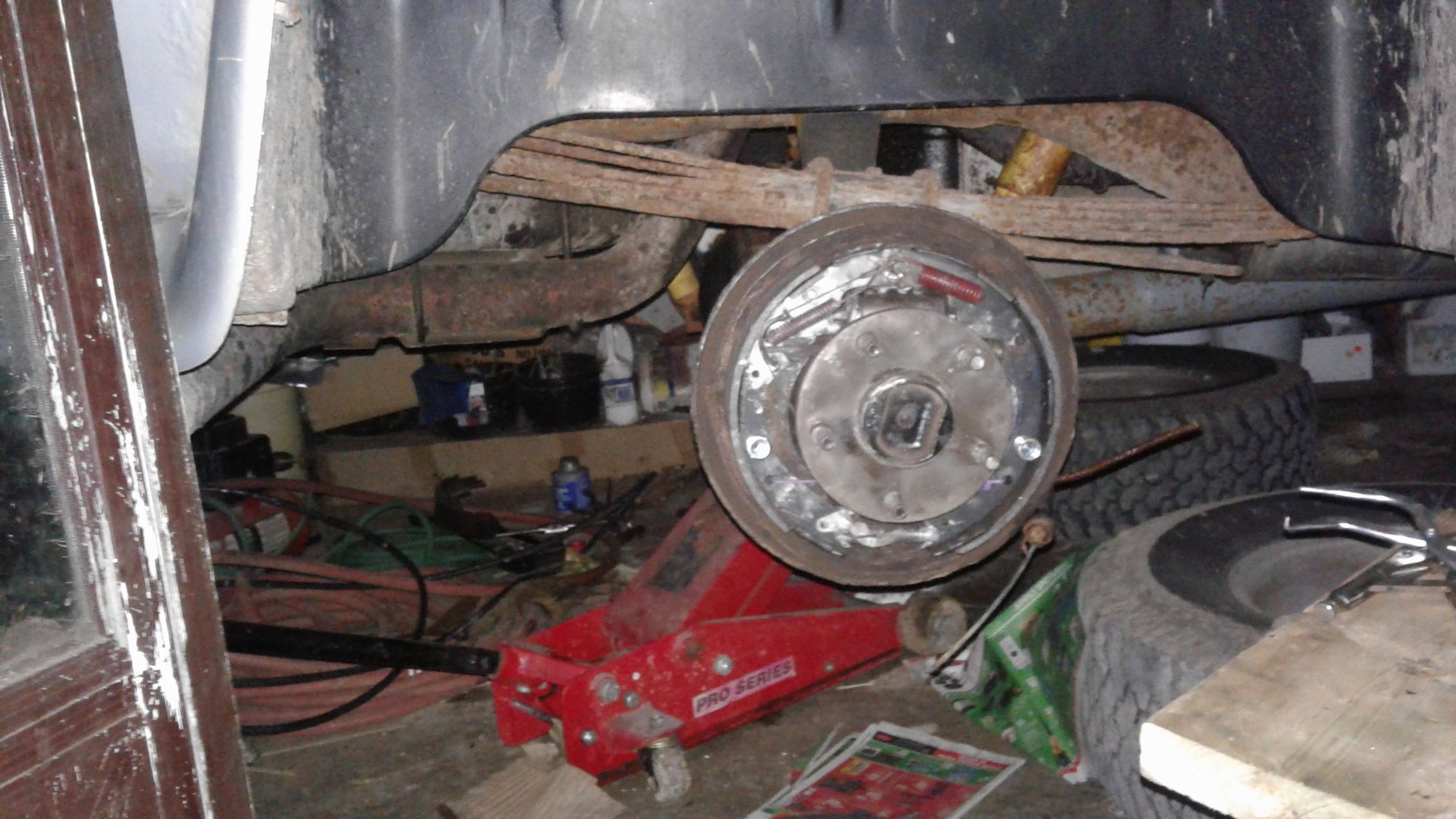

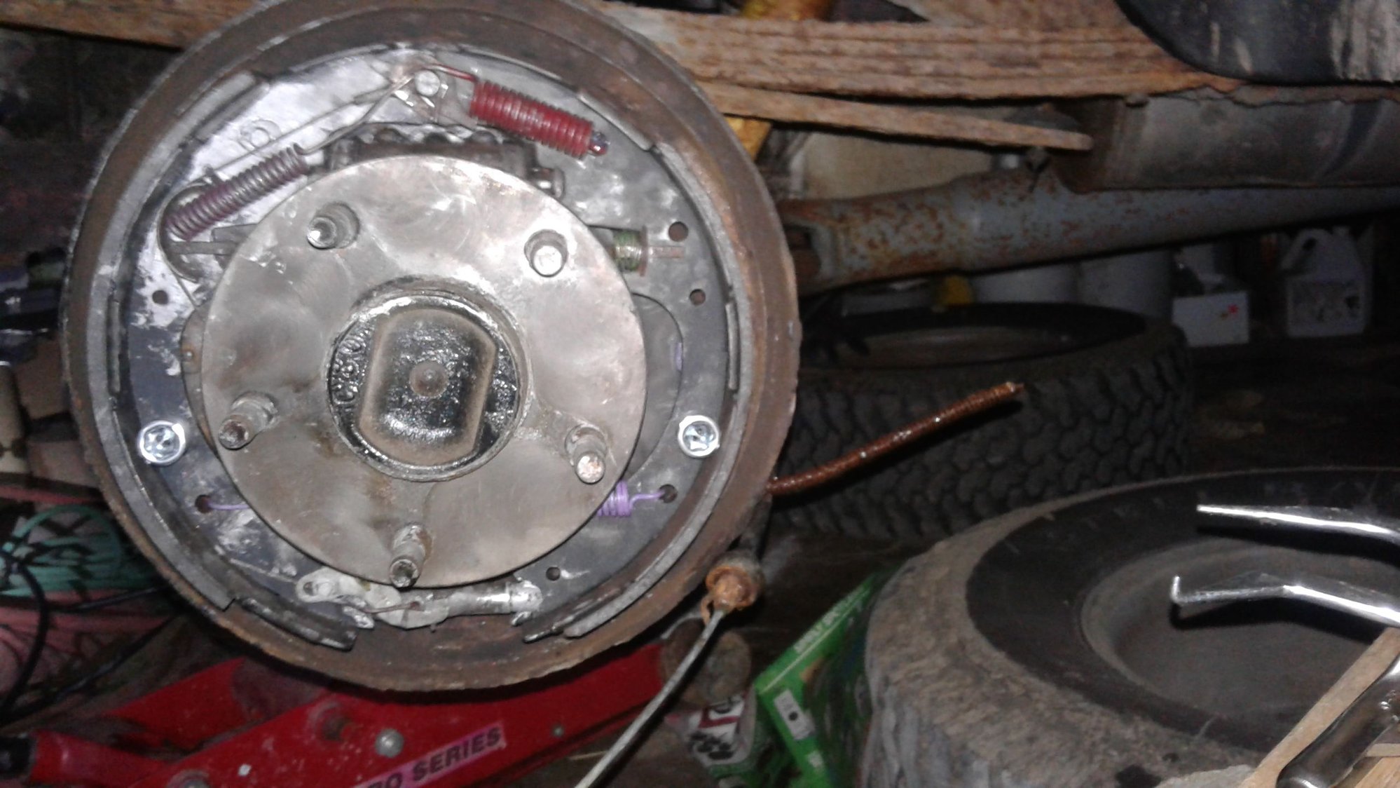

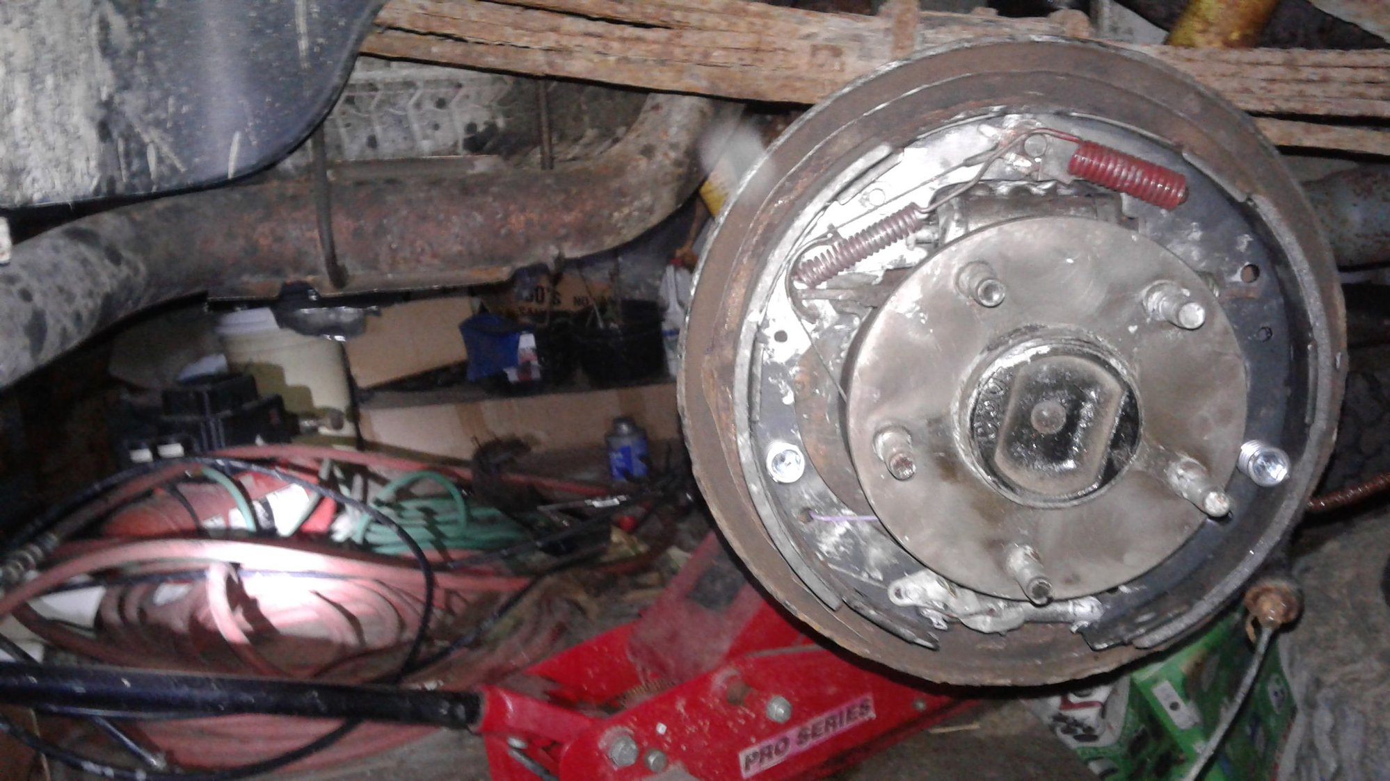

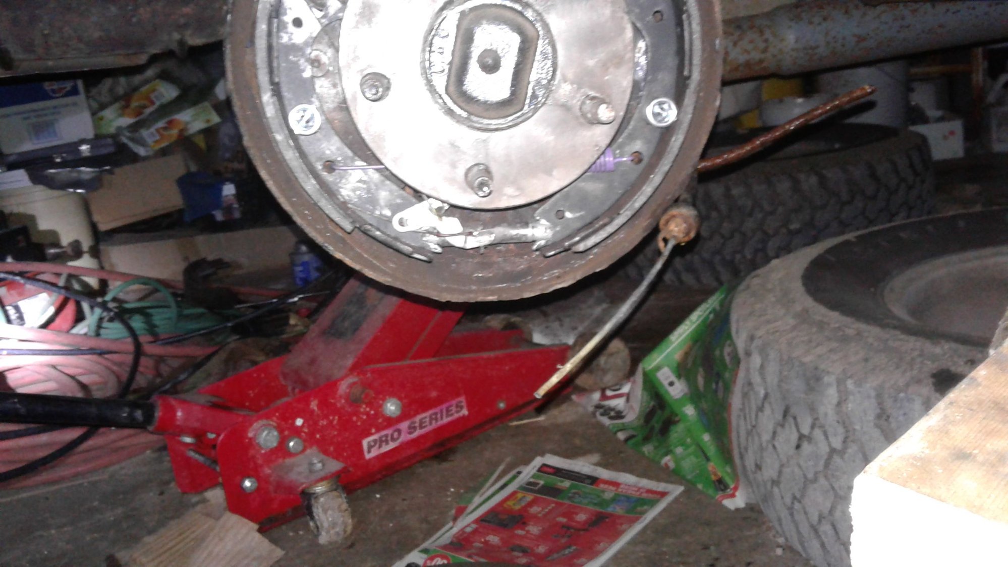

so here is some pics.. both drums both wont go on
you can see the brake pads
i also show how that clip doesnt go on out of the 2 boxes so the 4 with a a post only 1 actually fit on

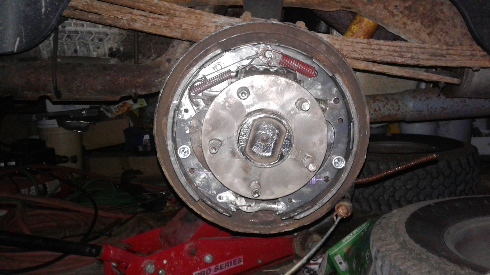

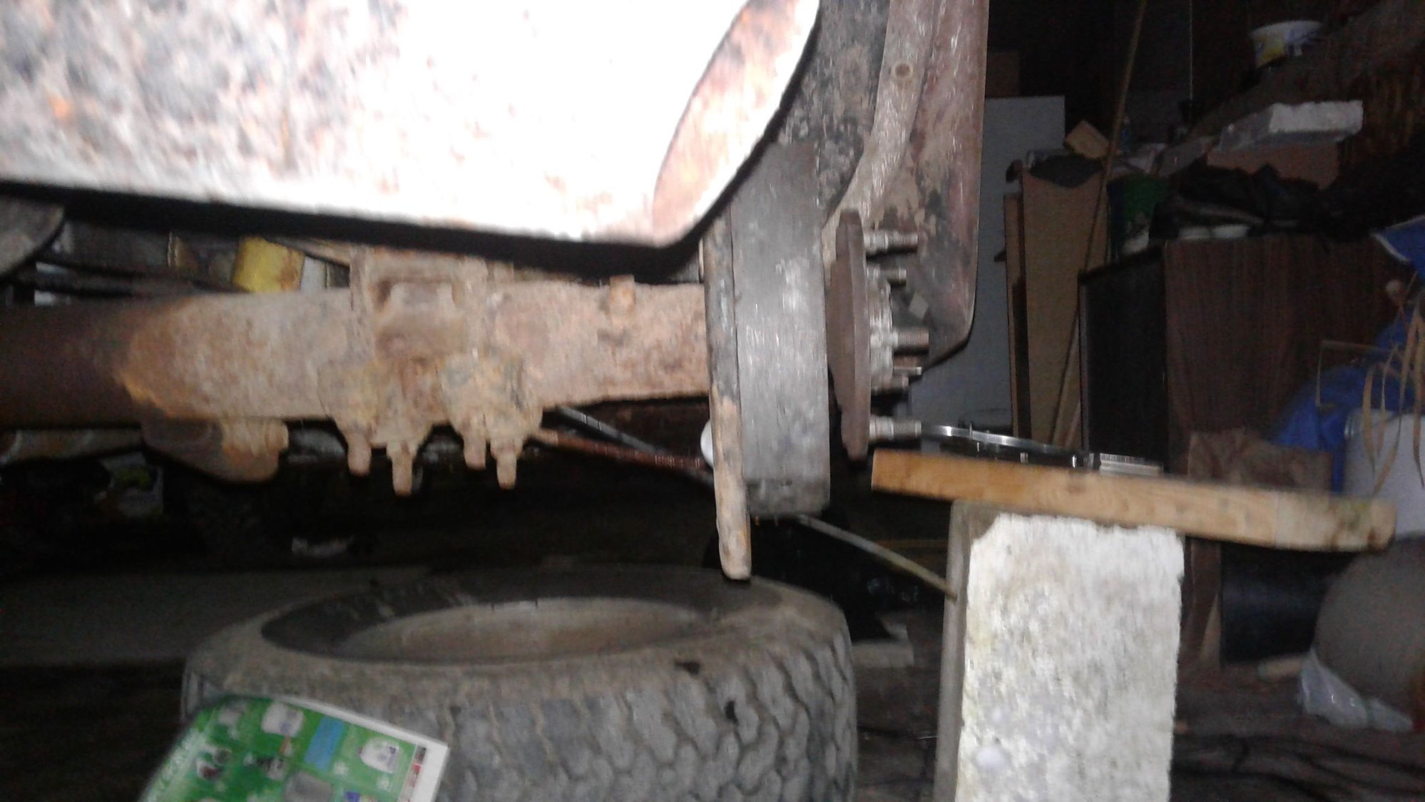

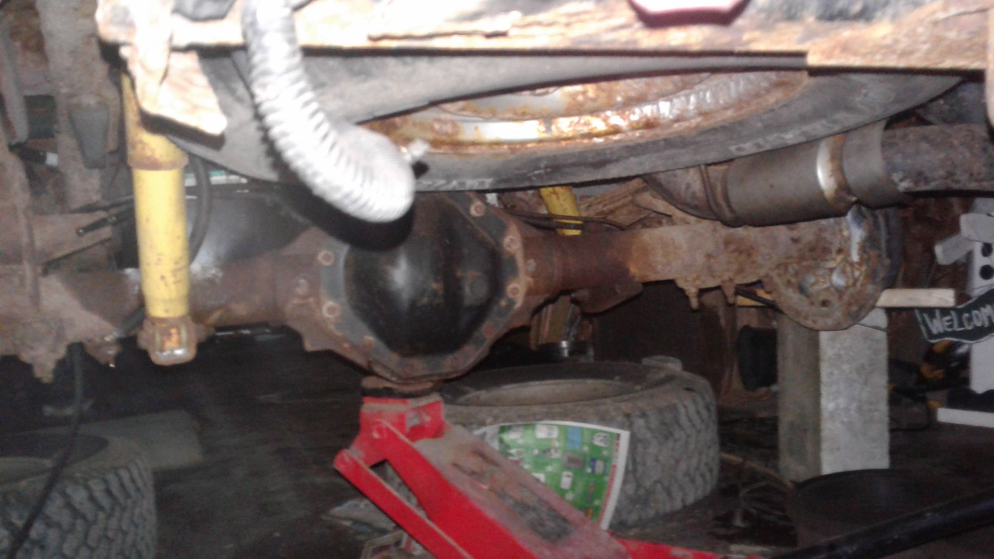

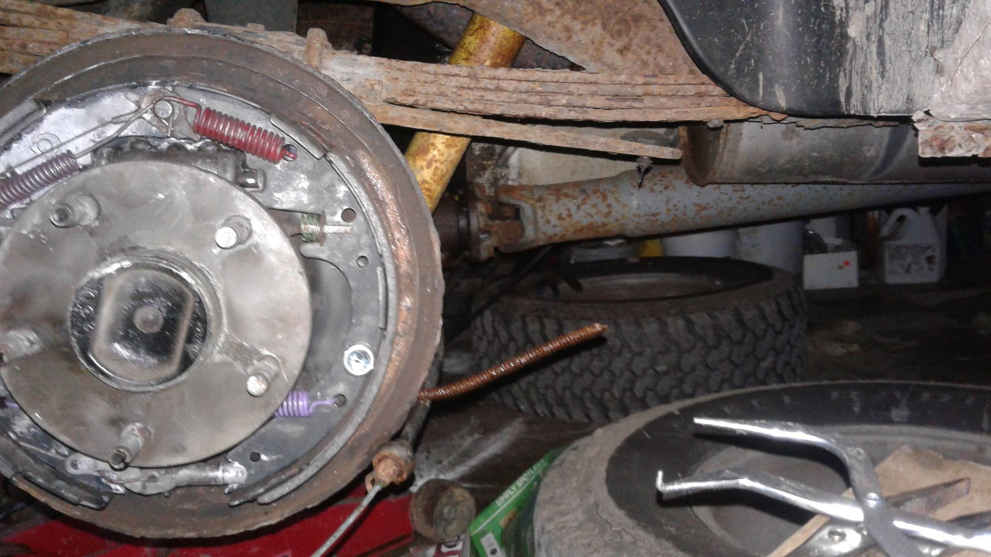

Not the e-brake holding things out just a bit is it??
Can you give me a shot straight on the axle, from about six feet away, showing the relationship between the shoes, and the backing plate? Nice BIG picture would be good.

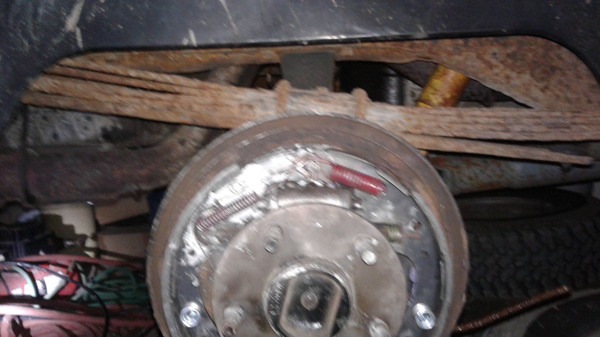

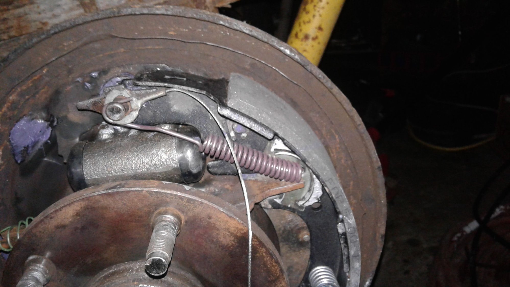

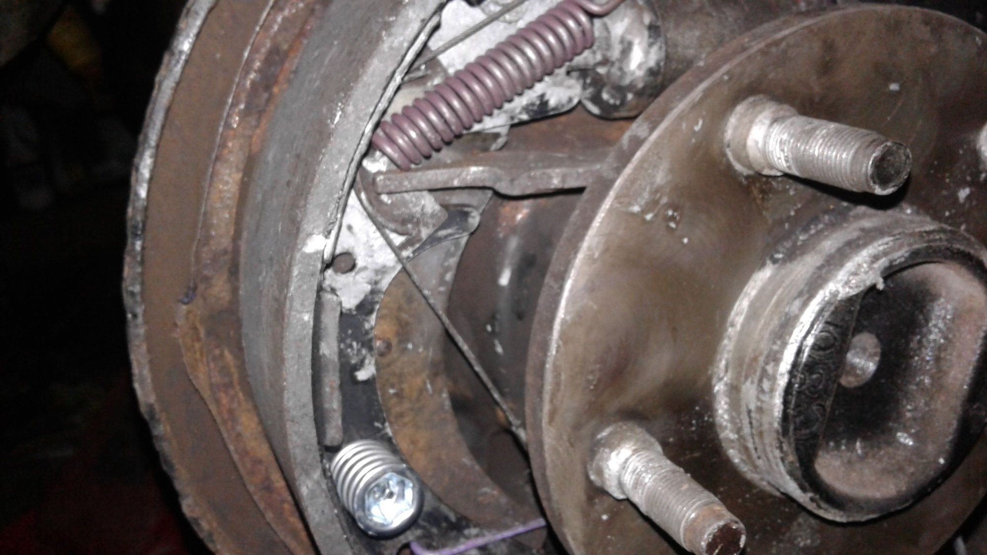

i cut the brake cable with cutting disc and removed it the one pic should show iot.. i was gonna leave the piece of metal out but for that cross piece of metal it needed to be there sot it wasnt floppy
ah as for the picture 6 feet apart what did you mean? i can take a pic of the whole axel? well i not sure but here are some pics lol so i got 18 pics if it works.. i dont know if any are good enough for you
i cant get better really only because wall of my garage in the way and the door is frozen so i can lift to get a wide shot of the axel etc but hope something you can use.. if not good enough ill try to get better pics tomorrow.. cuz its frustrating had nothing but issues as parts that suppoos to fit dont and such

I'm not really seeing anything wrong there..... Maybe the shoes are a bit lower than they should be, but, not like you can do anything about that....... Was the rear end swapped out on your truck at some point? Might need to get the BOM numbers off of it, and see if you can look it up somewhere. (Chrysler corporate rear though, so, god only knows if that info is even available anywhere.....)
