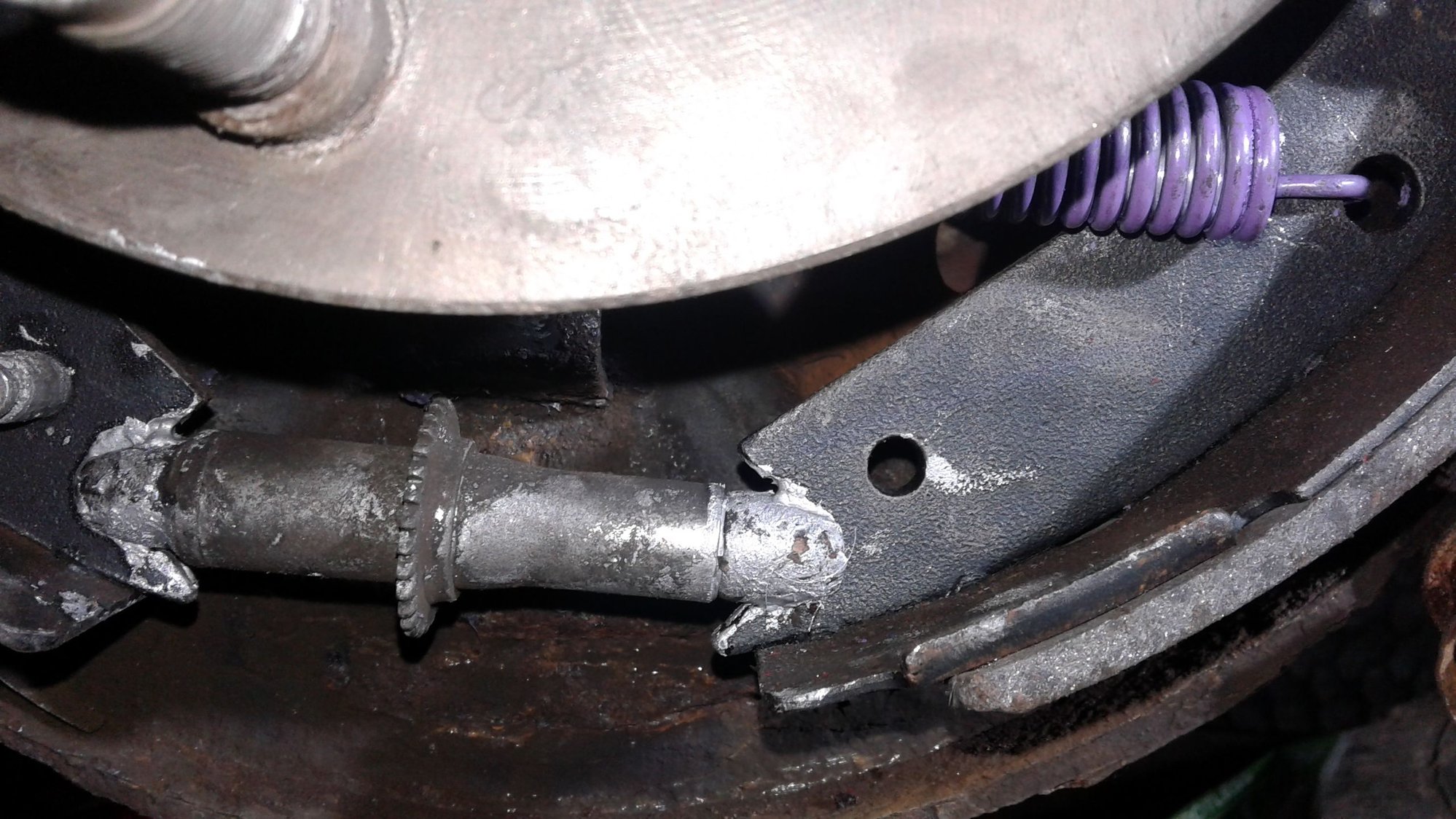

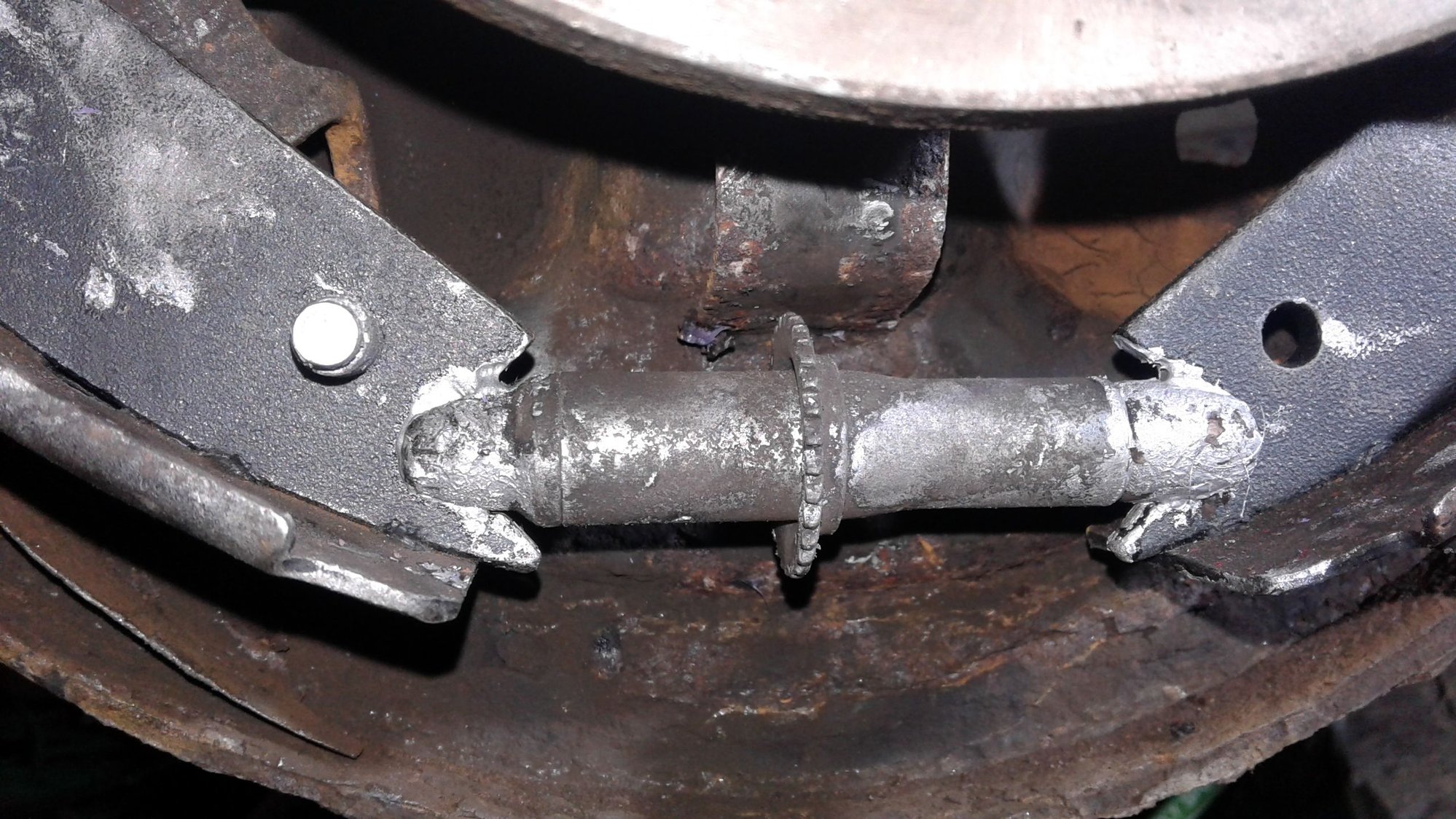

Did you turn the adjuster all the way in, so it is at it's shortest?
Old Dec 30, 2020 | 06:09 PM
  #56
comet424's Avatar
comet424
Joined: Mar 2017
Posts: 267

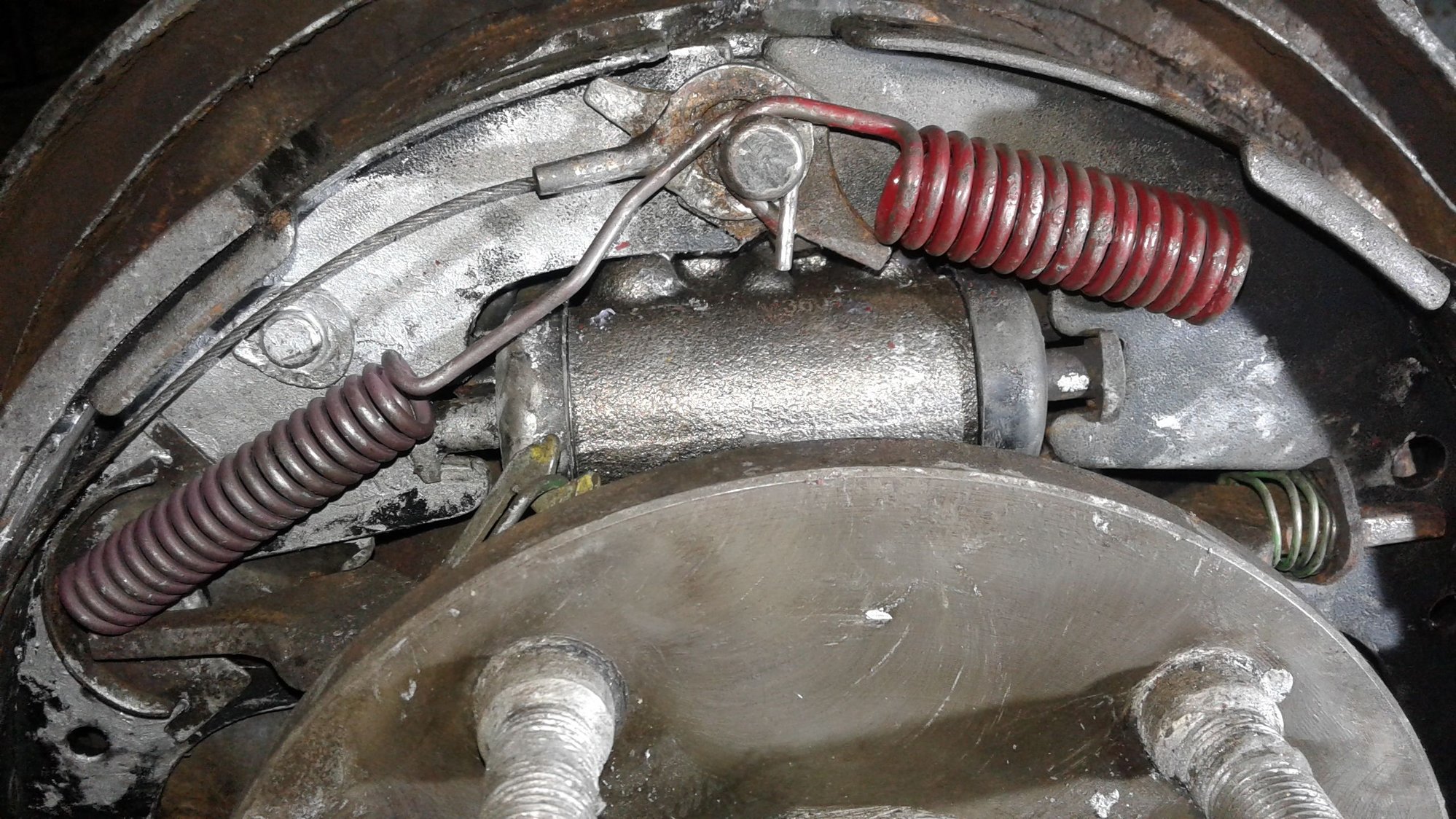

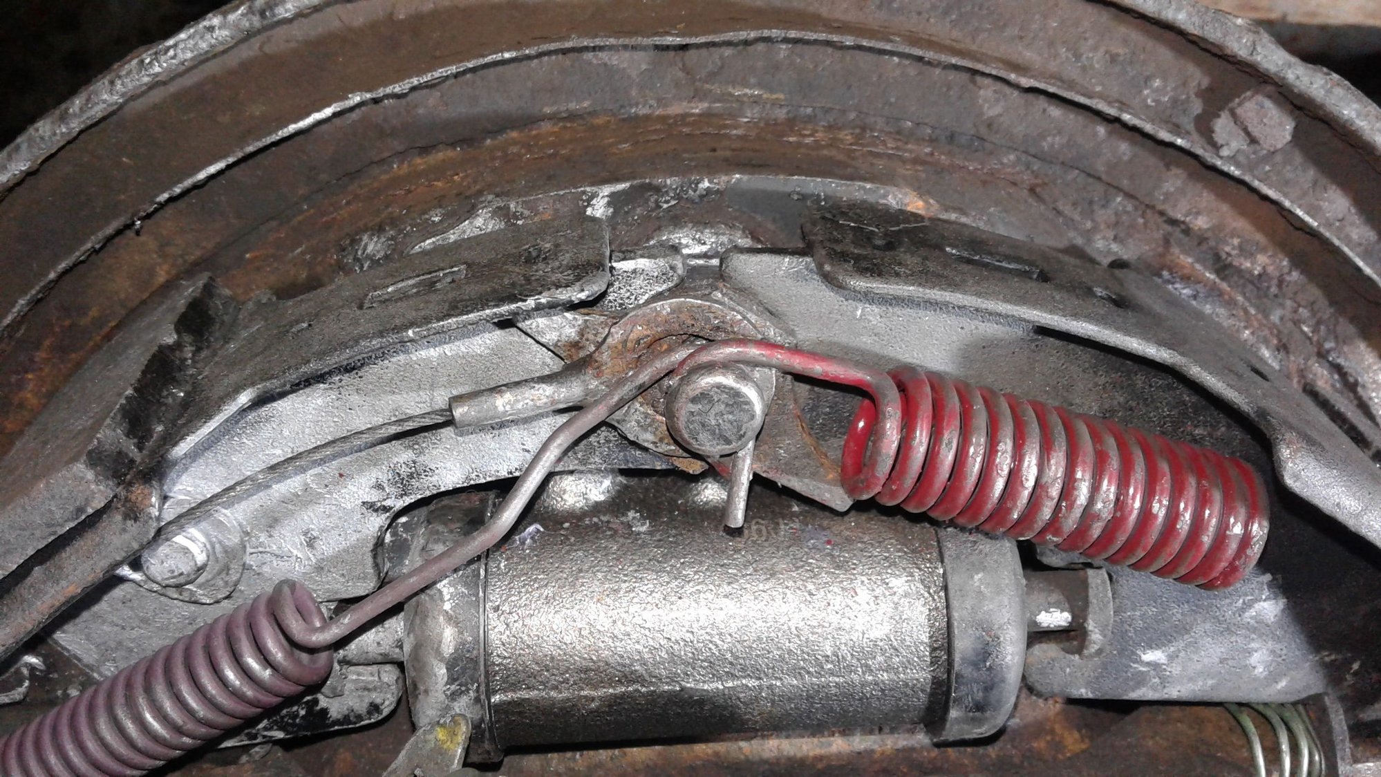

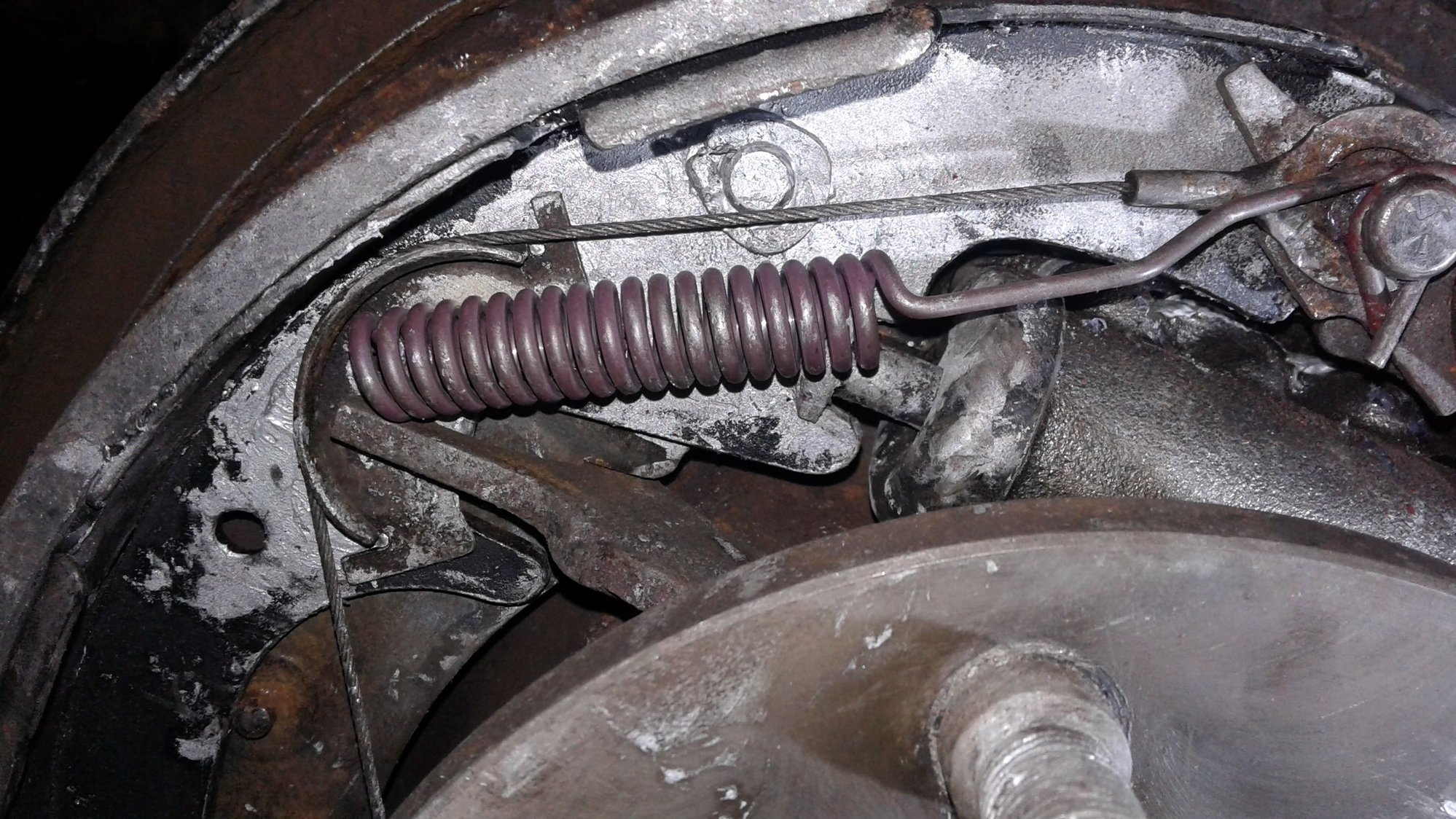

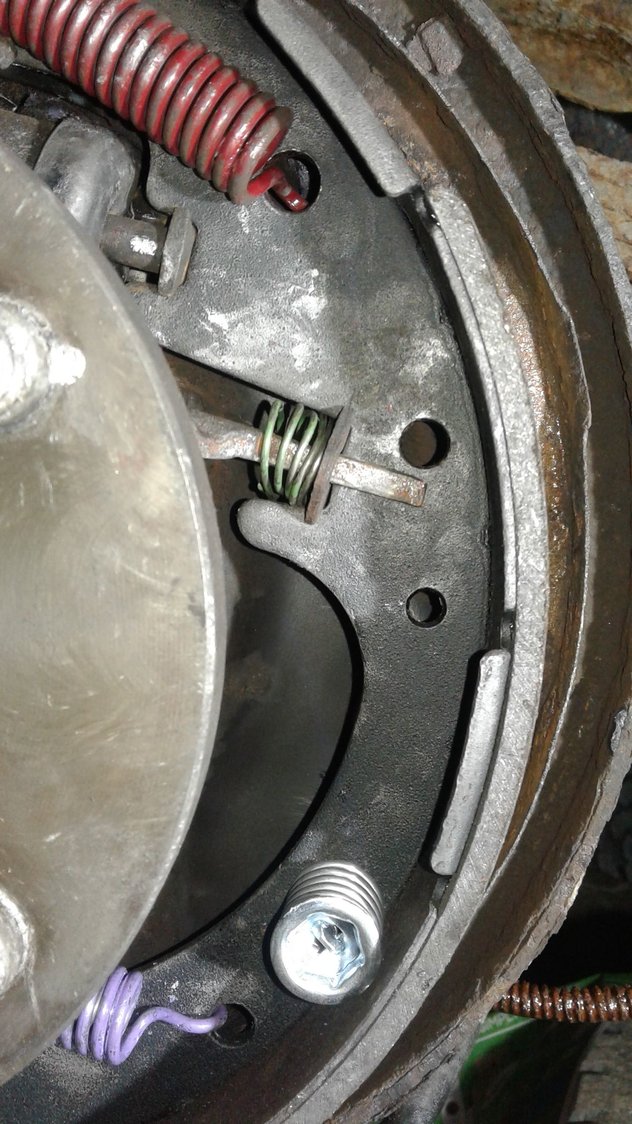

ye what you see in the pics is the current settings u can see its threaded all the way in.. apparently supposed to have a washer in there too... you can see the measurement of the inside of the drum too not sure if that helps as as i dont know measuresments but what you see is what i currently have it setup to

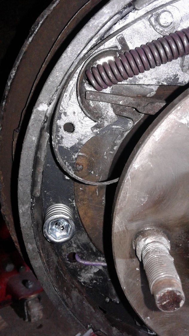

From what I can see, it *should* go back on there. Is it just not lining up properly?
Old Dec 30, 2020 | 06:20 PM
  #58
comet424's Avatar
comet424
Joined: Mar 2017
Posts: 267

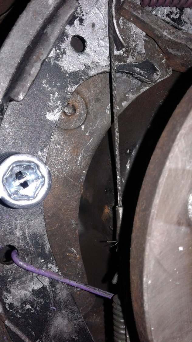

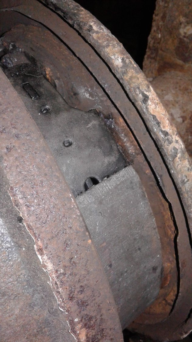

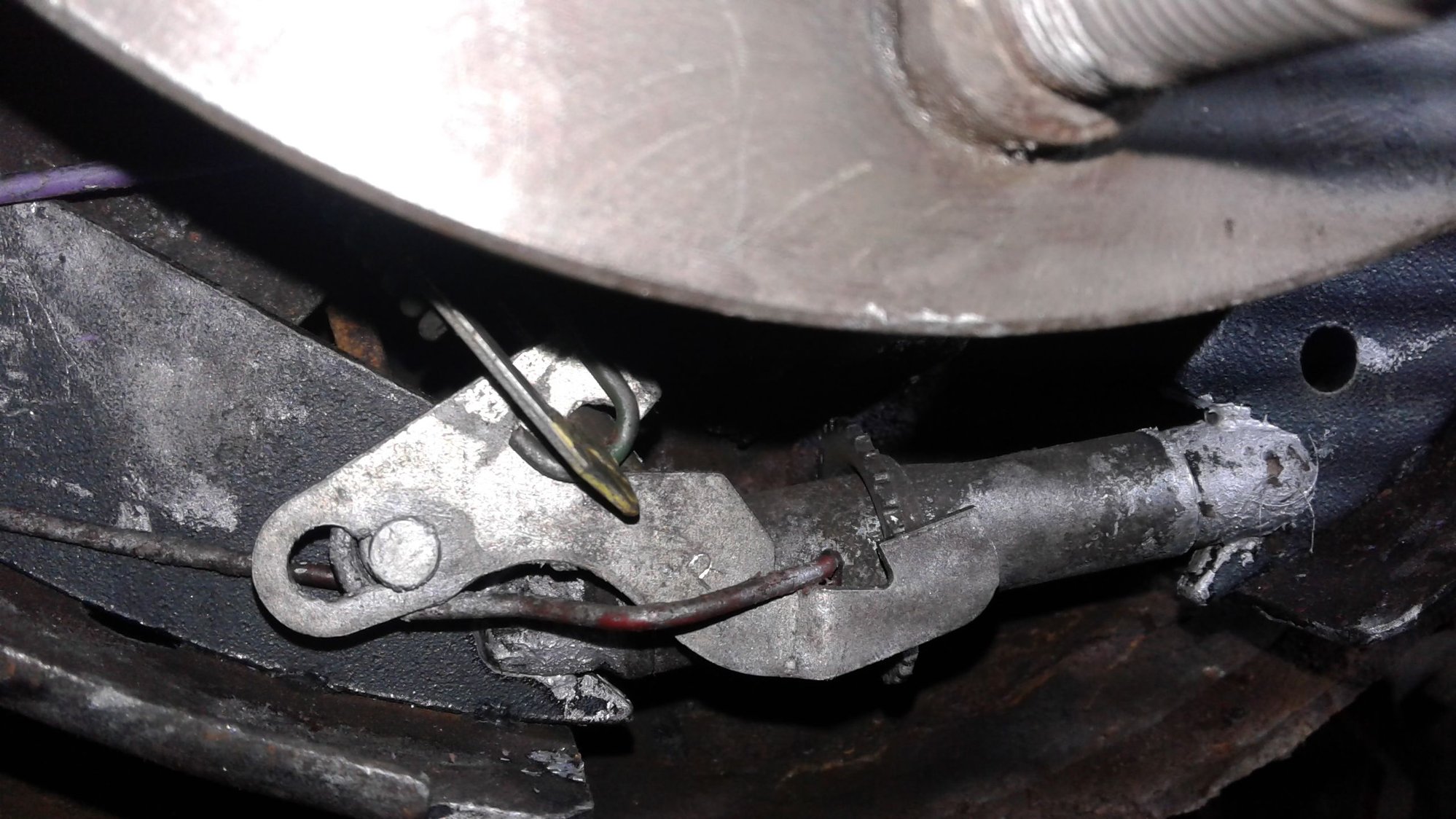

it wont let me push on over the brakes but these the brakes for 2000 i cant get it to slide around the brakes.. and i dunno what these parts are and if they are important? thats why i gave measurement of the inside drum size its like 10 15/16 on the tape measure
im sure if i hammer the drum on it will go on but it should just slide on loose but i cant even start the brakes are holding things back to slide on.. this truck has been a nightmare really

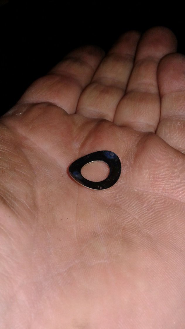

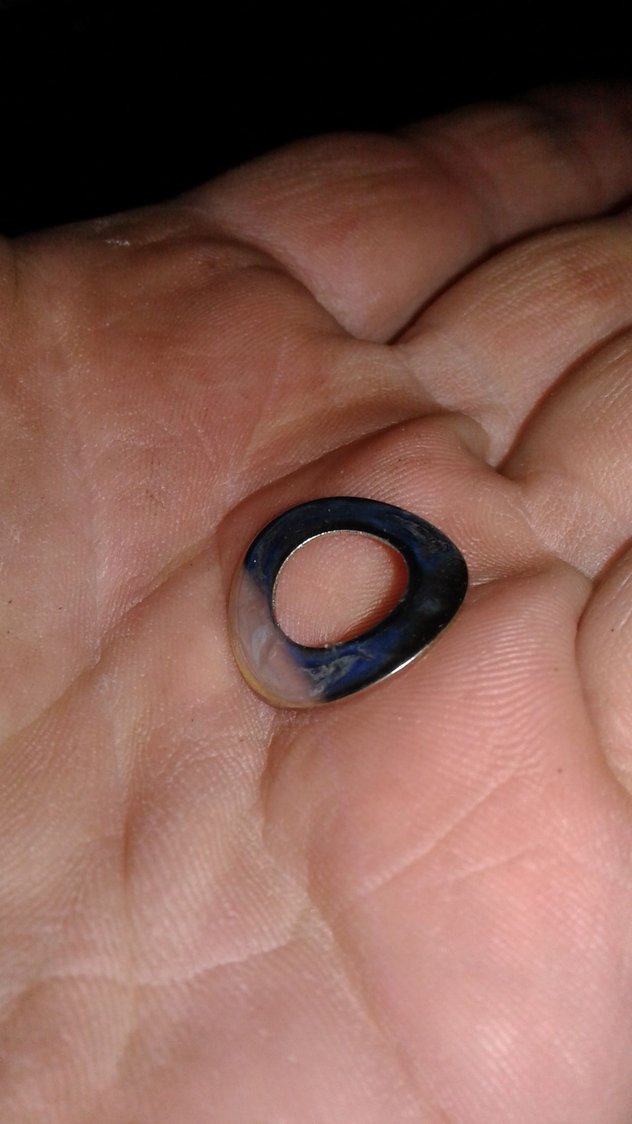

and these 2 things i cant figure out either

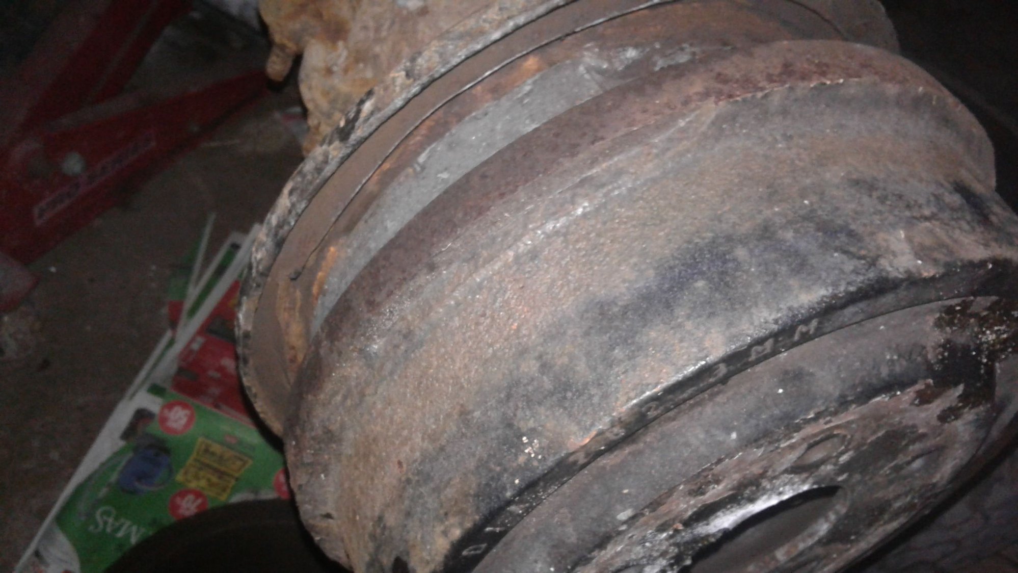

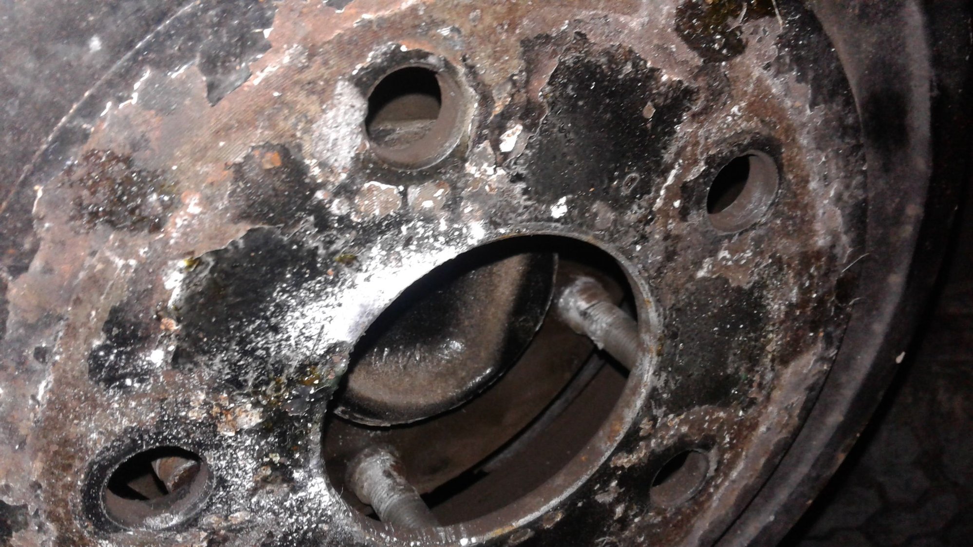

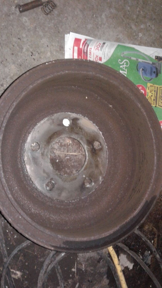

Is there a lip of rust on the drum? May have to get 'em turned.
Old Dec 30, 2020 | 06:38 PM
  #60
comet424's Avatar
comet424
Joined: Mar 2017
Posts: 267
no not that i can see.. i didnt do the driver side yet i miss placed the 2 little **** to go in the damn cylinder so didnt finish that brake..
but i took that drum and tried shoving on it wont go on either.. are there different specs for that year different drums as i was told that was a bad year its a messed up yet
as now i dunno and dont know how to find out
