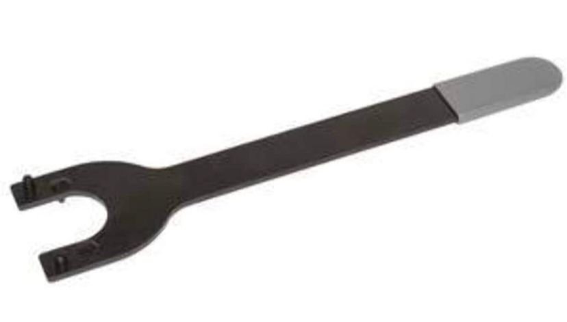

Wrench you can find at auto parts stores. Can also use two big wrenches. I think I used a pipe wrench the first time.

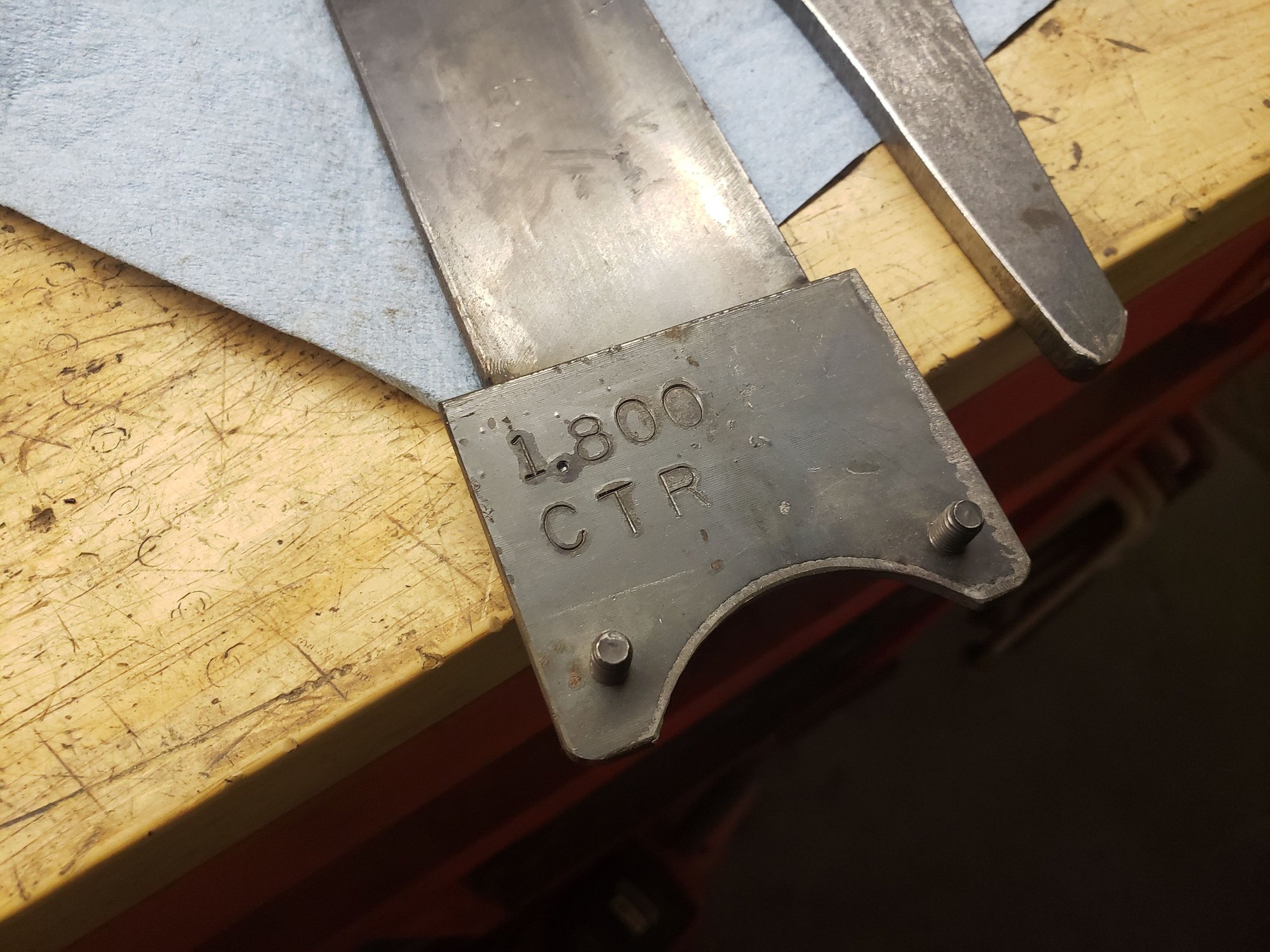

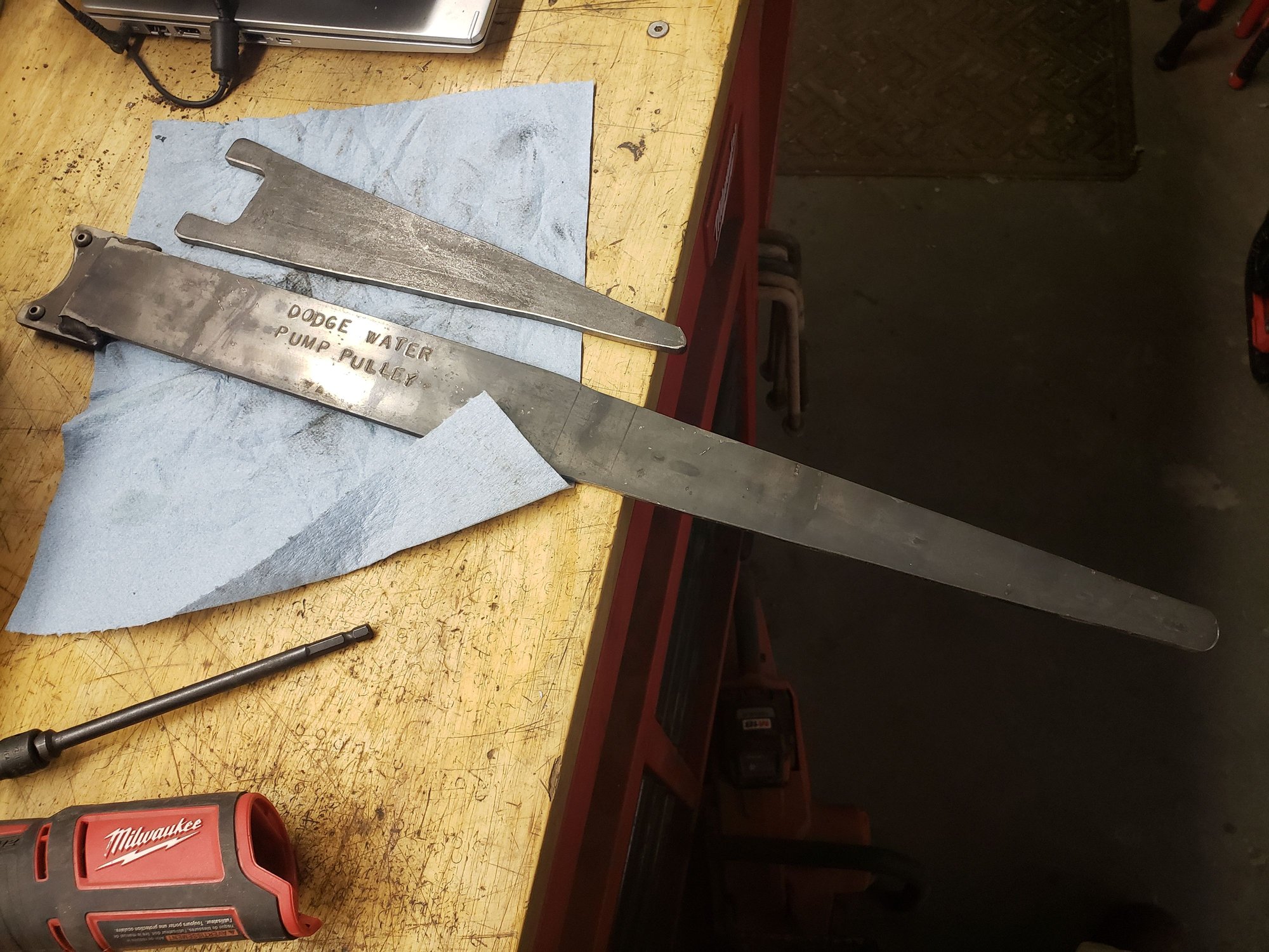

Many years ago after having done a 5.9 gasser WP I still had the pump in my scrap bin...I made myself a spanner wrench and machined a 36mm plate wrench. Sometimes having fab ability and being a machinist by trade is a curse LOL
The pin spanner is 22" long and apparently I determined CL spacing at 1.800"
edit: I've used 'em a couple times and they're extremely effective!

I know the curse well… especially when you can buy one for $35 (seen as low as $16).
