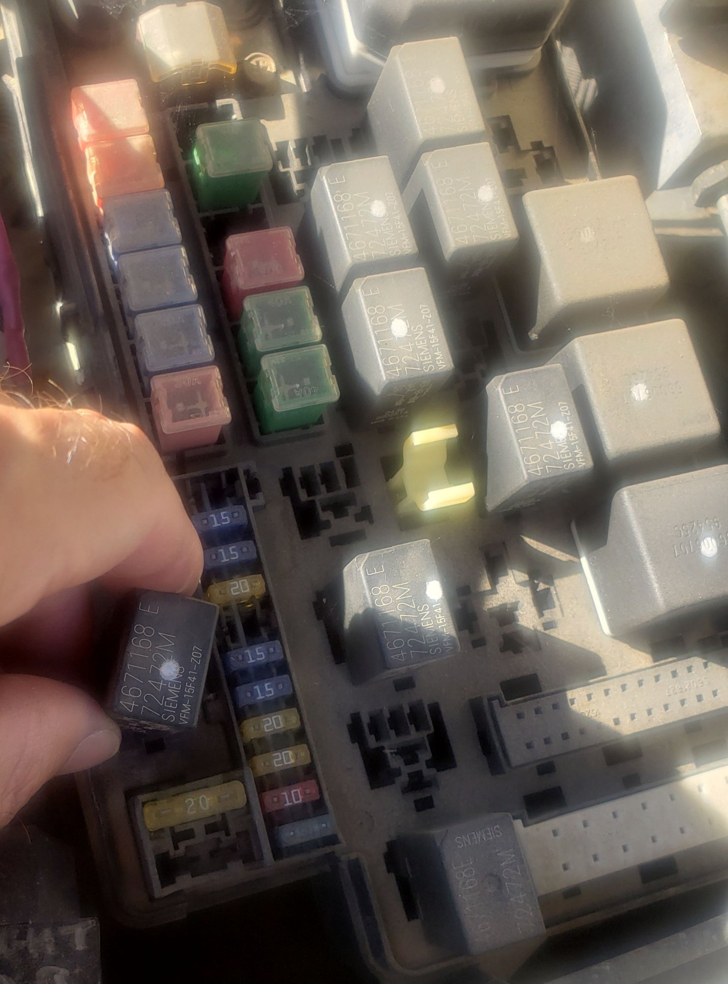

You're correct it's a relay (My bad). I did a swap with another one and no change. I figure since its not real hard to loosen straps and drop it down low enough to disconnect the power plug and drop it down for a quick test with the old pump. I'm not seeing any codes or engine light. I should have did a test before I jacked it up in place. lol.
Yeah it did look like the cardboard from something that.
The tank definitely needed a good cleaning as you can see.

Is the PCM trying to control the relay? Verify you see power at the coil for three seconds at initial key on.
I'm not sure how you would determine this? I mean everything was fine other then signs of pump was starting to fail. The power/ground was removed before any work was done. The electrical plug did give me some issue coming of and the back side came out but wires didn't so I push that rubber part back on as well the cap. Once disconnected I did a full visual and it looked good so I didn't expect any issues once new pump was installed. When I turned the ignition on. I didn't hear the pump as in the past. I tried swapping relays with no different results. My thinking was to take a test light and check to see if I am getting power to the plug and pump. I was also going to plug the old pump in and see if it working as well. Basically trouble shoot and go from there. Maybe you can give more in depth on what your thinking? Thanks

Jump the pump at the relay connections and see if you get anything, that'll at least tell you if the pump is capable of running at all

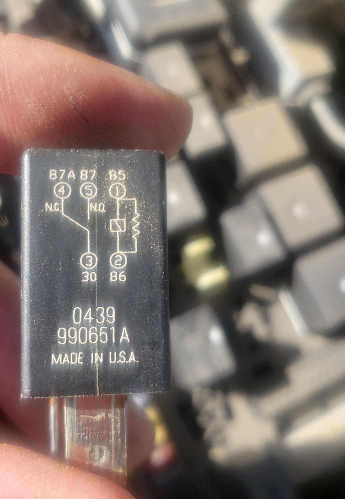

It's a ton of work to lower the tank vs just sticking a jumper in at fp relay connection under hood
Check out @HeyYou from 2011 here, basically you wanna jump 30 to 86. Whatever you do leave 85 out of it because that's a ground and you don't want to jump hot to ground
