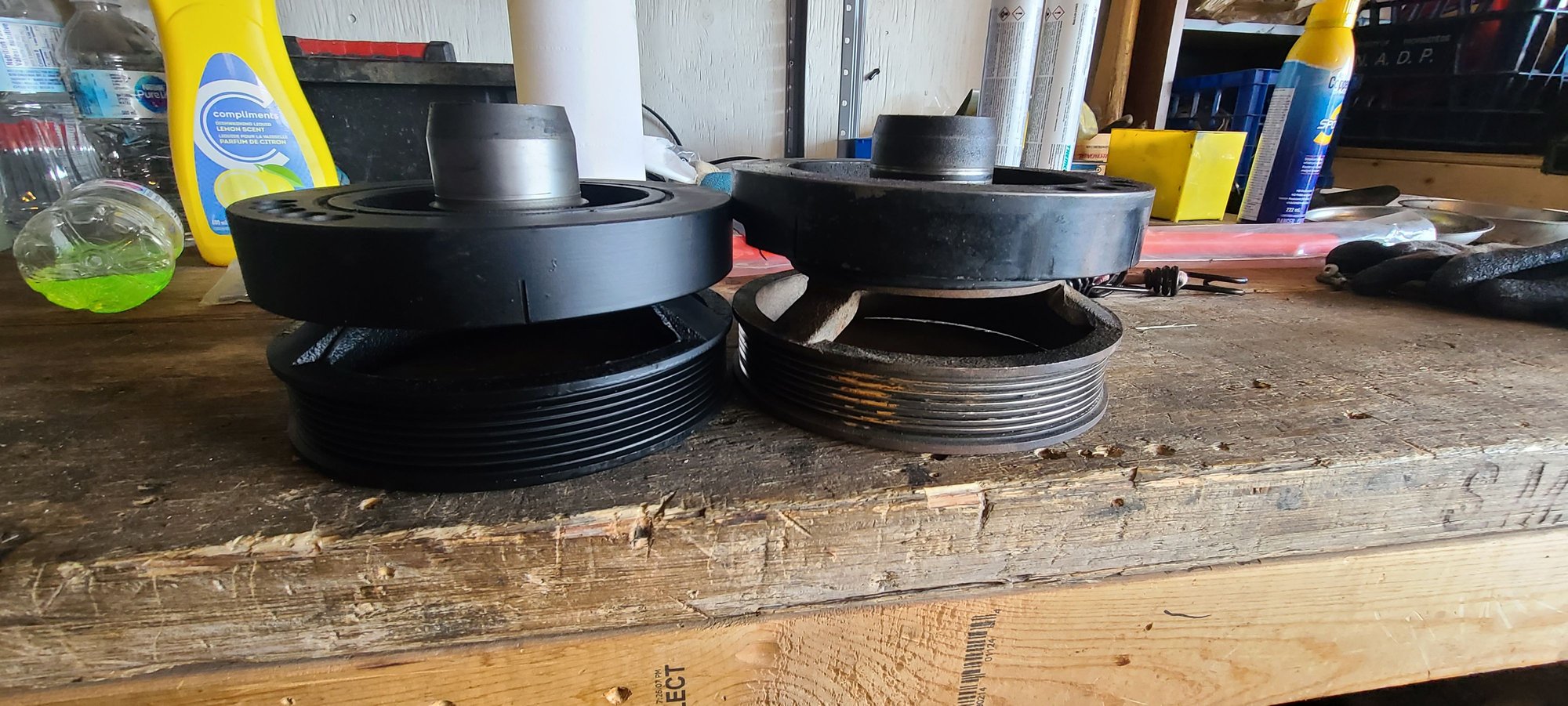

I put the cover on with the 4 bolts temporary then the balancer then torqued the bottom timing cover bolts then the water pump. Seem to work out ok. Hope I sealed everything right
look how much my balancer separated
