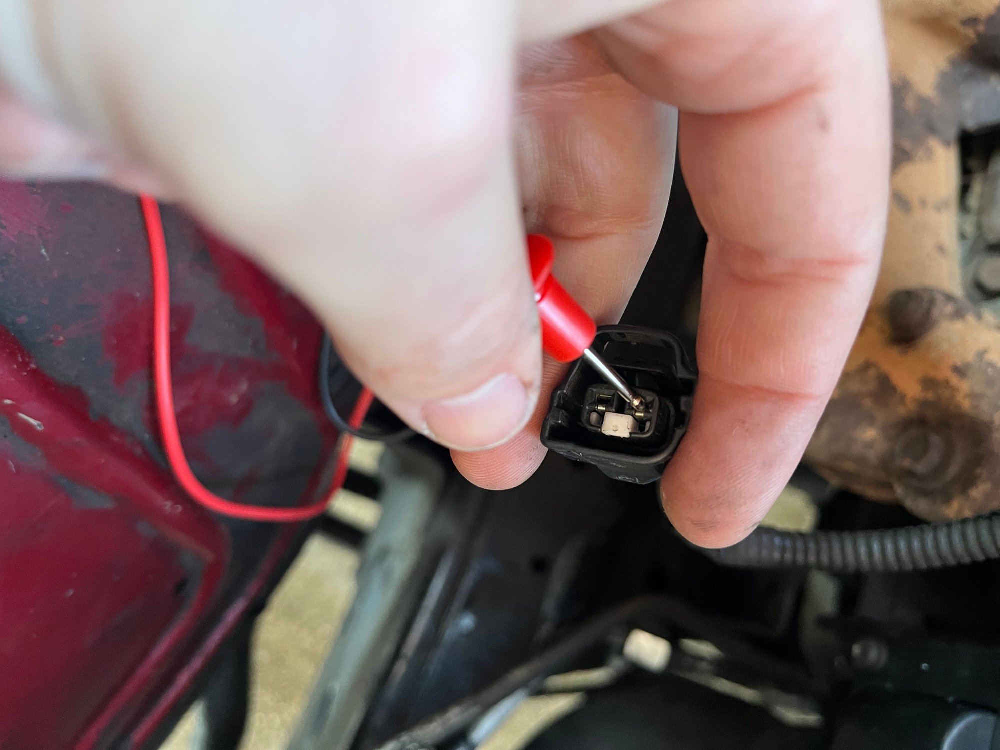

I am getting a constant dim light, test light to negative wire that plugs into ignition coil, alligator clip connected to pos battery terminal.

Unplug it from both ends, test continuity of the wire itself, and also continuity to ground.

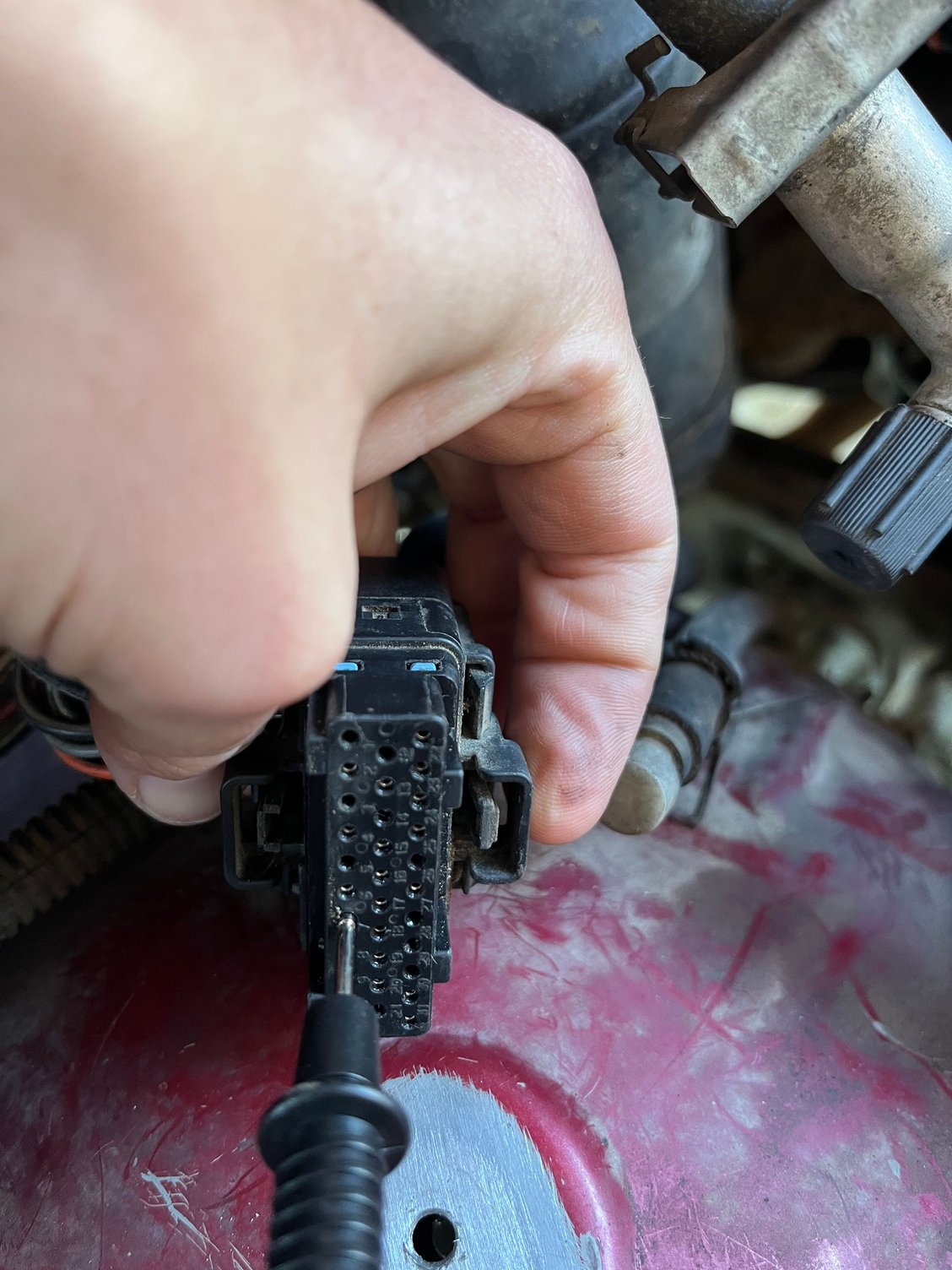

do you know what plug in is the wire for the coil
Old Dec 15, 2022 | 04:16 PM
Posts: 87,548
Likes: 4,230
C1 pin 7, Black with grey trace.

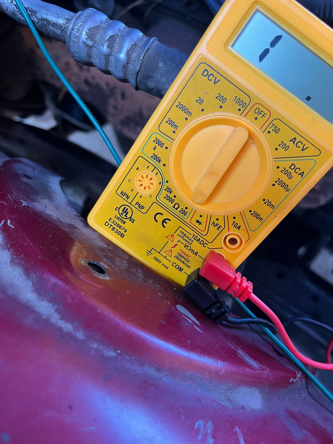

This is how I have my meter set up, I am getting 00.3 on reading testing pin 7 and negative wire to coil

That should mean the wire is good...... Though the infinite resistance in your pic of the meter might be a problem? Or is that just to show the settings on the meter, and not the actual reading?
Test from the wire (either end) to ground as well. (unhooked on both ends) See what ya get.
