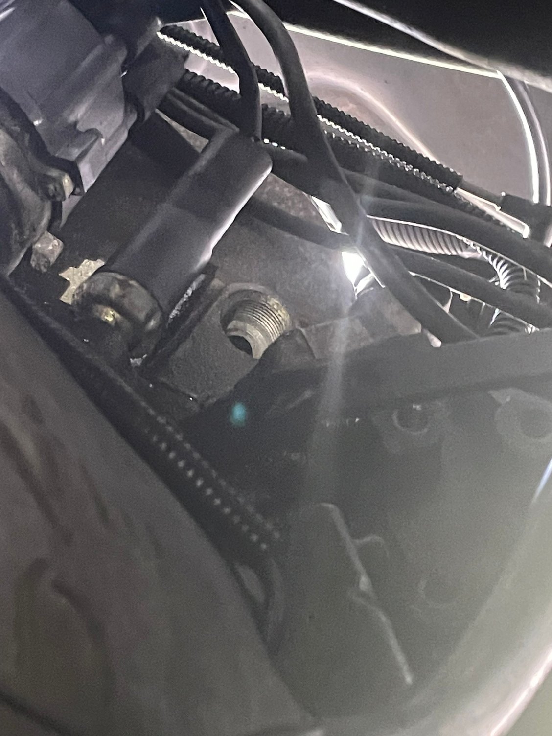

Default Sensor
Does anyone know what sensor is supposed to be here?
Old Apr 23, 2023 | 12:42 PM
  #23
Posts: 87,483
Inlet for the egr tube from the passenger side exhaust manifold. If your truck is 96 or newer, it won't have EGR, and there will be a block-off plate where the valve is supposed to be. Nothin' goes there in that case.
Old Apr 23, 2023 | 02:13 PM
  #24
Snicholl93's Avatar
Snicholl93
Joined: Jan 2023
Posts: 19
Default Different truck.
This is for a 96 5.9. My buddy is wondering what exactly it is.
Old Apr 23, 2023 | 07:46 PM
  #25
Posts: 87,483
My 96 was the same way. It seems that Dodge had some leftover EGR manifolds they wanted to use up, as opposed to just scrapping them.
