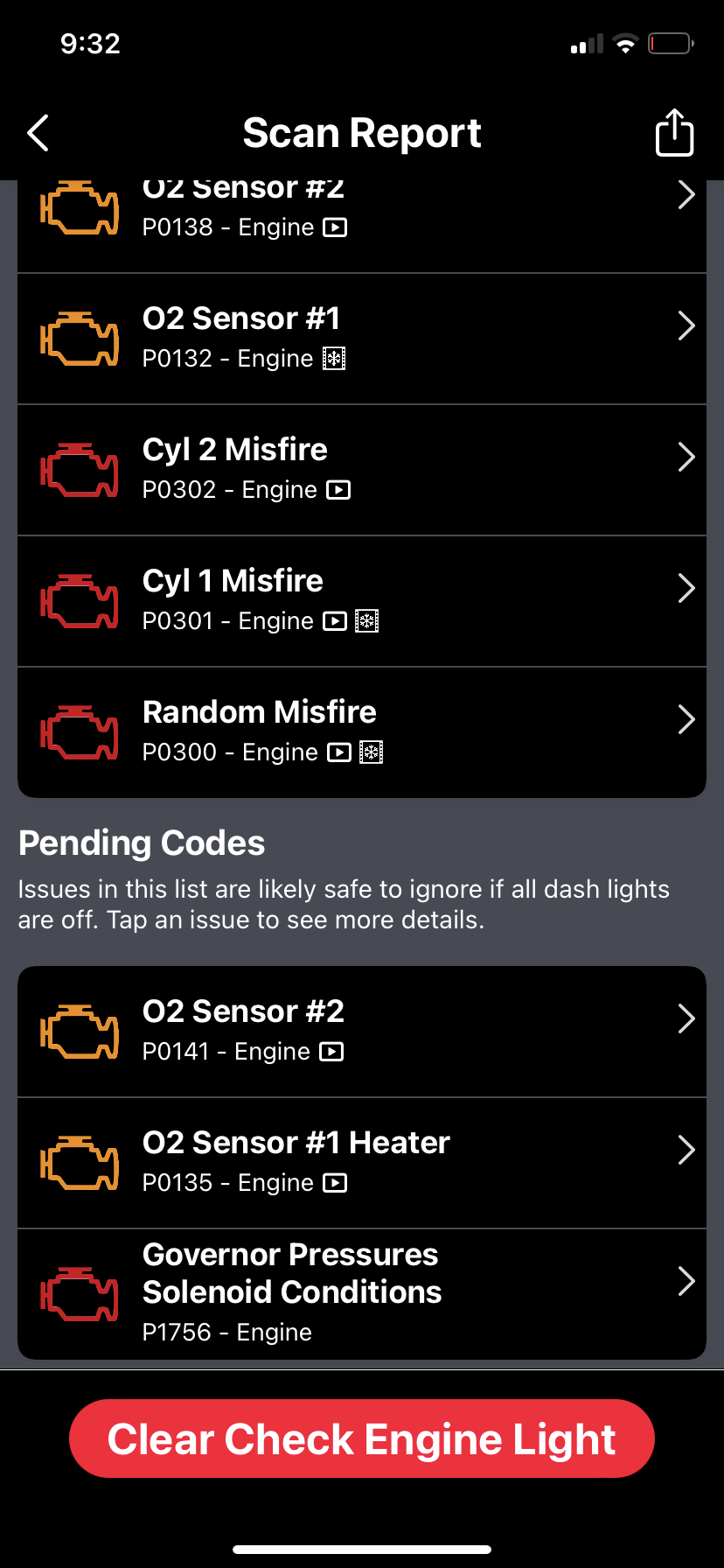

This is what comes up for it. I’ve changed both the O2 sensors before too. When I do a tune up on it it runs great for a few days or weeks but then starts up again.

Might want to pull the bad O2 sensor(s) and have a look at it to see what may be killing it - this thread may help the identification - https://dodgeforum.com/forum/2nd-gen...en-sensor.html
Also, be sure to use OE style NTK O2 sensors replacements after determining/repairing the coolant or oil issue.
