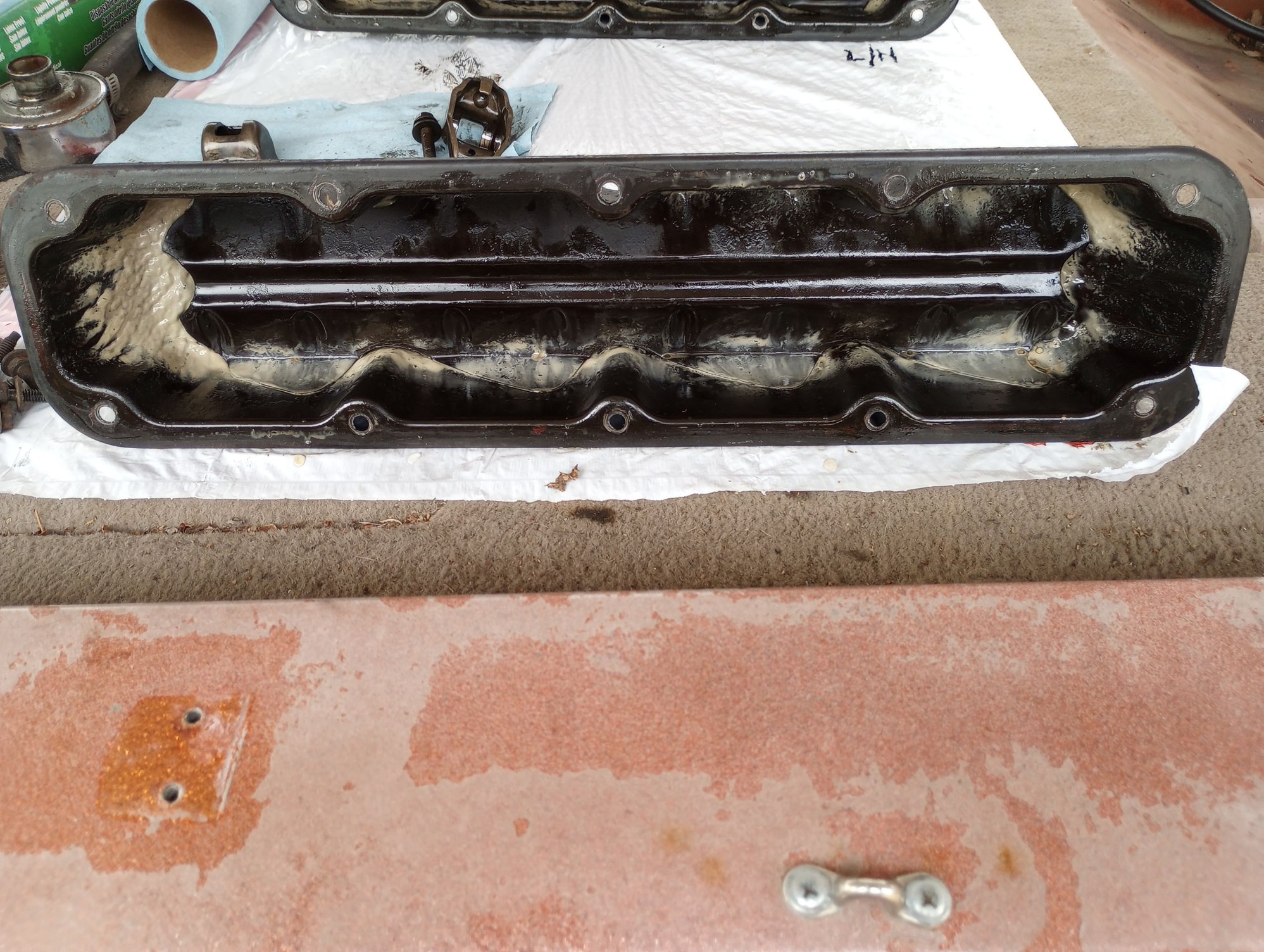

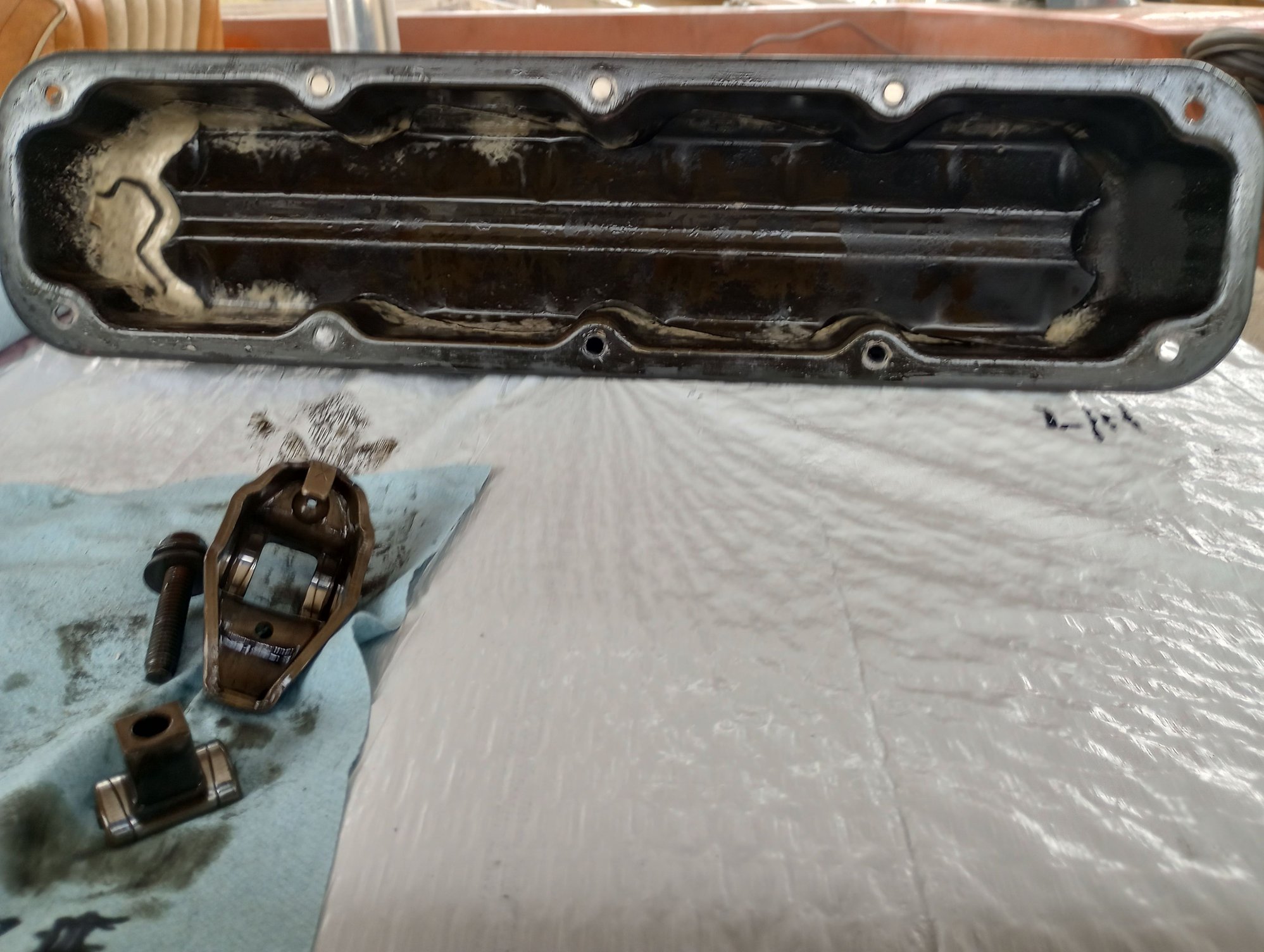

  #30
Rambassguy's Avatar
Rambassguy
Joined: Mar 2023
Posts: 34
From: Missouri
This is what I had when pulled covers off to check springs, heard it's not an issue if truck sits alot which it used to, and none of this junk is in pan or on dipstick
