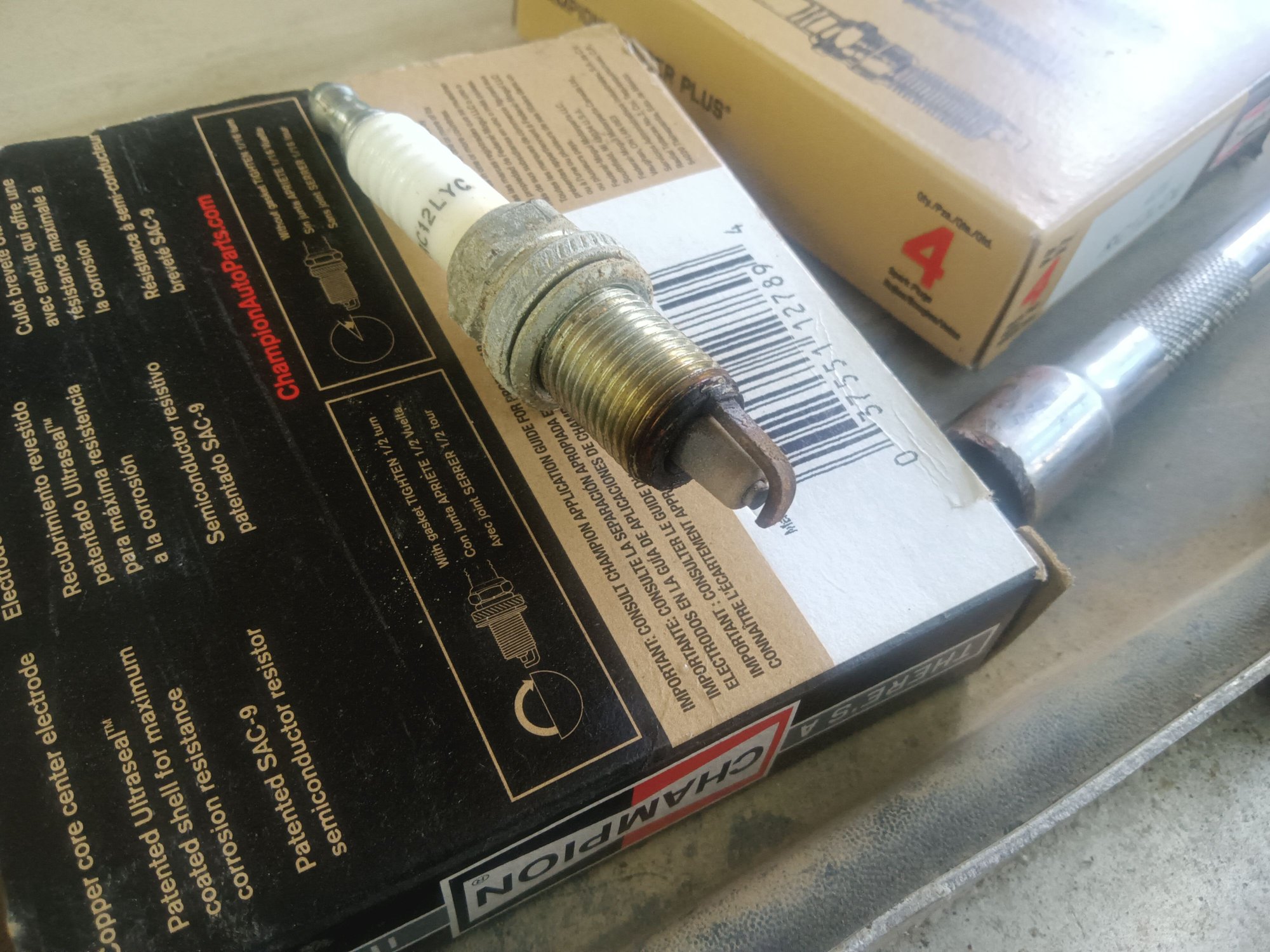

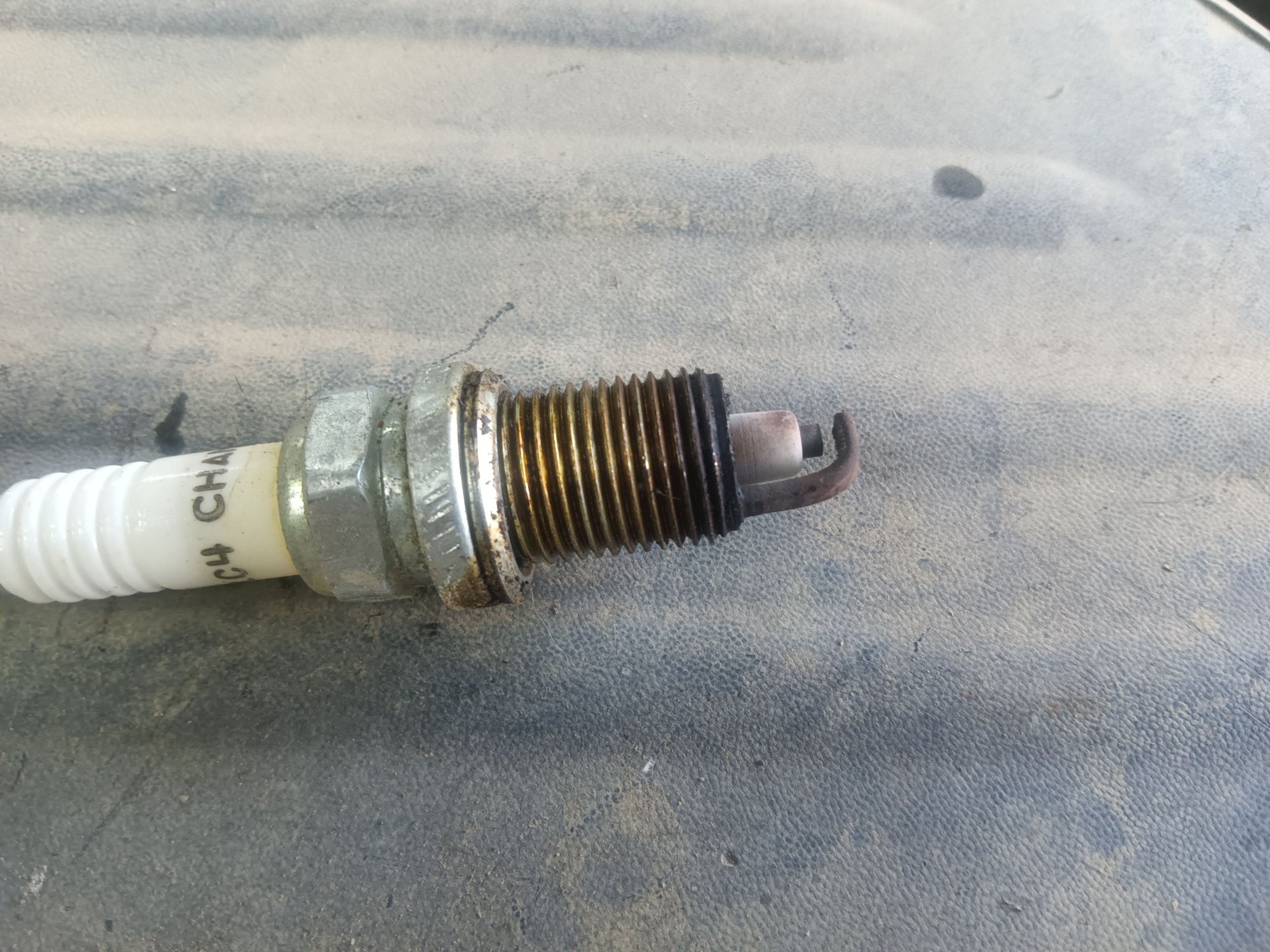

Sorry, weather has been crappy lately along with high temps. I did get in the new sensor. It says it mopar part number 56027870 made in Germany. (crank sensor). I am still trying to figure out how to work this Zurich for live data. The idle issue is just plain weird. I drove it to work this morning and it seemed pretty smooth. Started it up leaving work and idle was again little rough but as normal rpm gauge barely shows it. You can feel it lightly misfire going down the road. I did buy a socket style allen wrench set for this round on changing sensor. It's just so darn tight getting a wrench in there with your hands. I also thinking about giving it new wires, cap and rotor since I replaced the plugs. I mean it wouldn't hurt to give it a tune up anyway. Gas millage has been good. I am going to post pictures of the plugs that were changed. They didn't look all that bad.
I would have to go back and check each box if your looking for which cylinder each plug came from. I labeled each one as they were removed.

How old are the cap and rotor?? WIres?? Sure won't hurt to change 'em if they are old.
