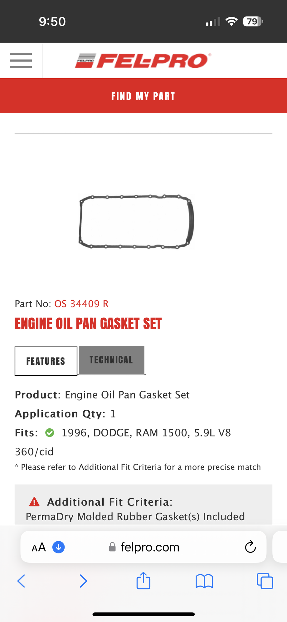

that must of been the gasket kit that was on my engine then!! So stupid ! This white rubber seal that separates the timing cover to the oil pan is what i reused and that’s where it’s leaking from . It’s deff not a 1 piece . Also have any tips for doing the gasket ? How much rtv and where should I put it on this pan? Also where did you get that fancy oil pump ?

where would I find one ? Was looking at the fel pro gasket
