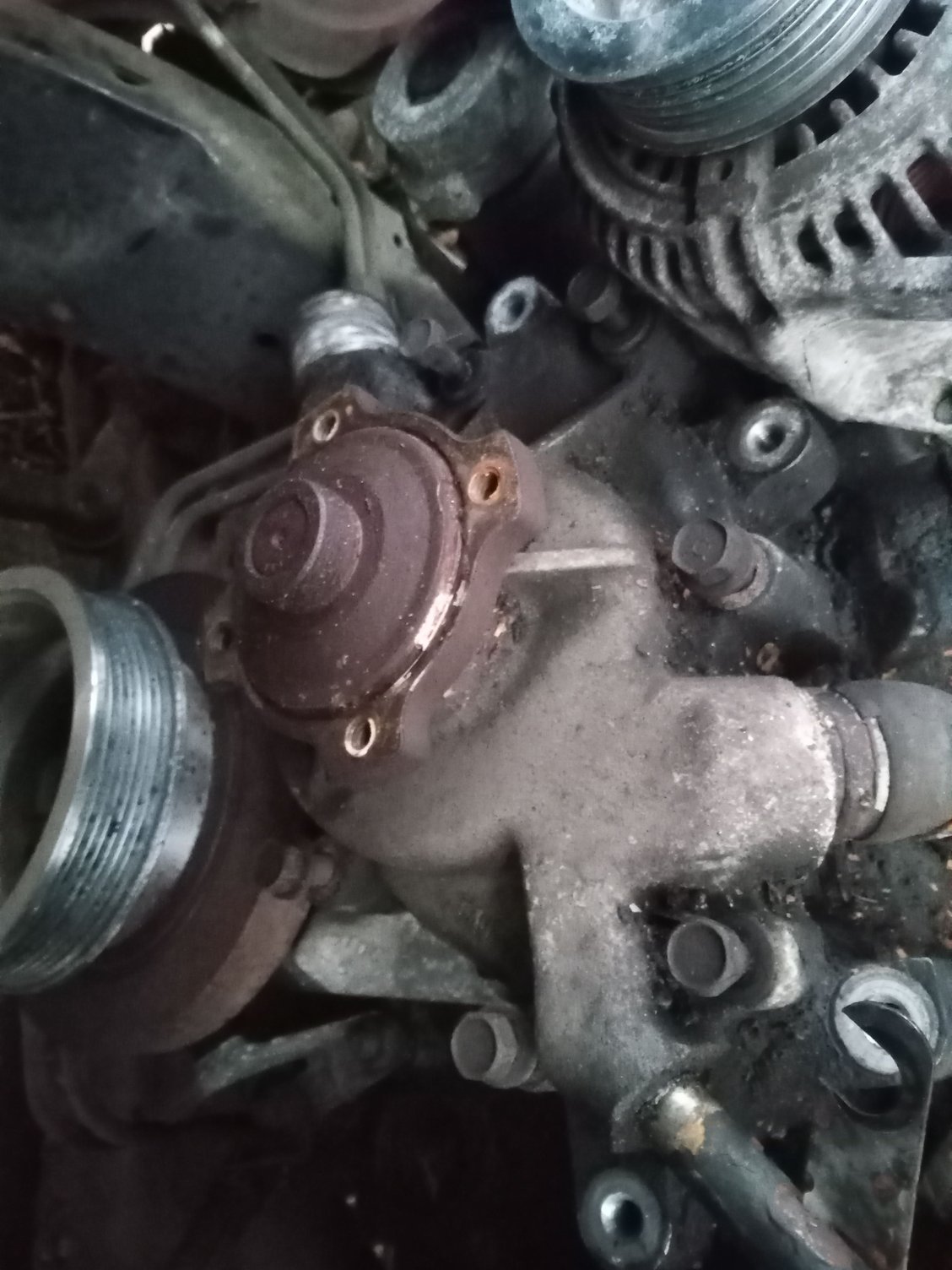

The water pump and everything else is original. The truck was bought new. I'll try to get pics if I can get home before it's dark. I hate the short days of winter.

Took a couple pics before it got dark. Yes my engine is a little grungy.😔

Thanks for those photos. Learn something new regularly. I wonder if the pressed-on pulley would fit that style water pump? I noticed several have 4 holes that may line up with those bolt holes..

The 4 holes in the pressed on pulley don't have threads and are also spaced differently than the holes on my water pump so the under-drive pulleys I have won't work I guess.

See if you can get the oe part # off that if it's original. This is the first one i have seen like it. My guess is the factory changed the design to save a few bucks.
