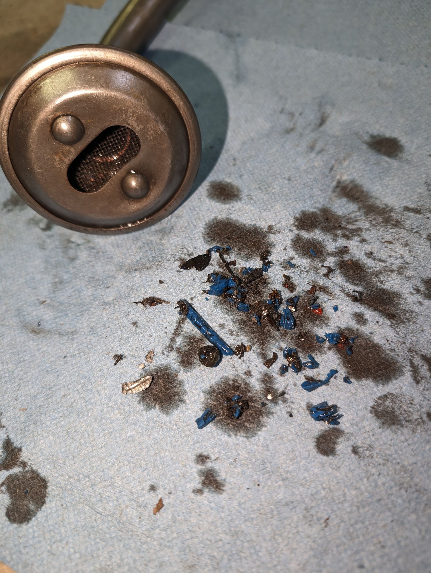

Opened the box - no pickup gasket...

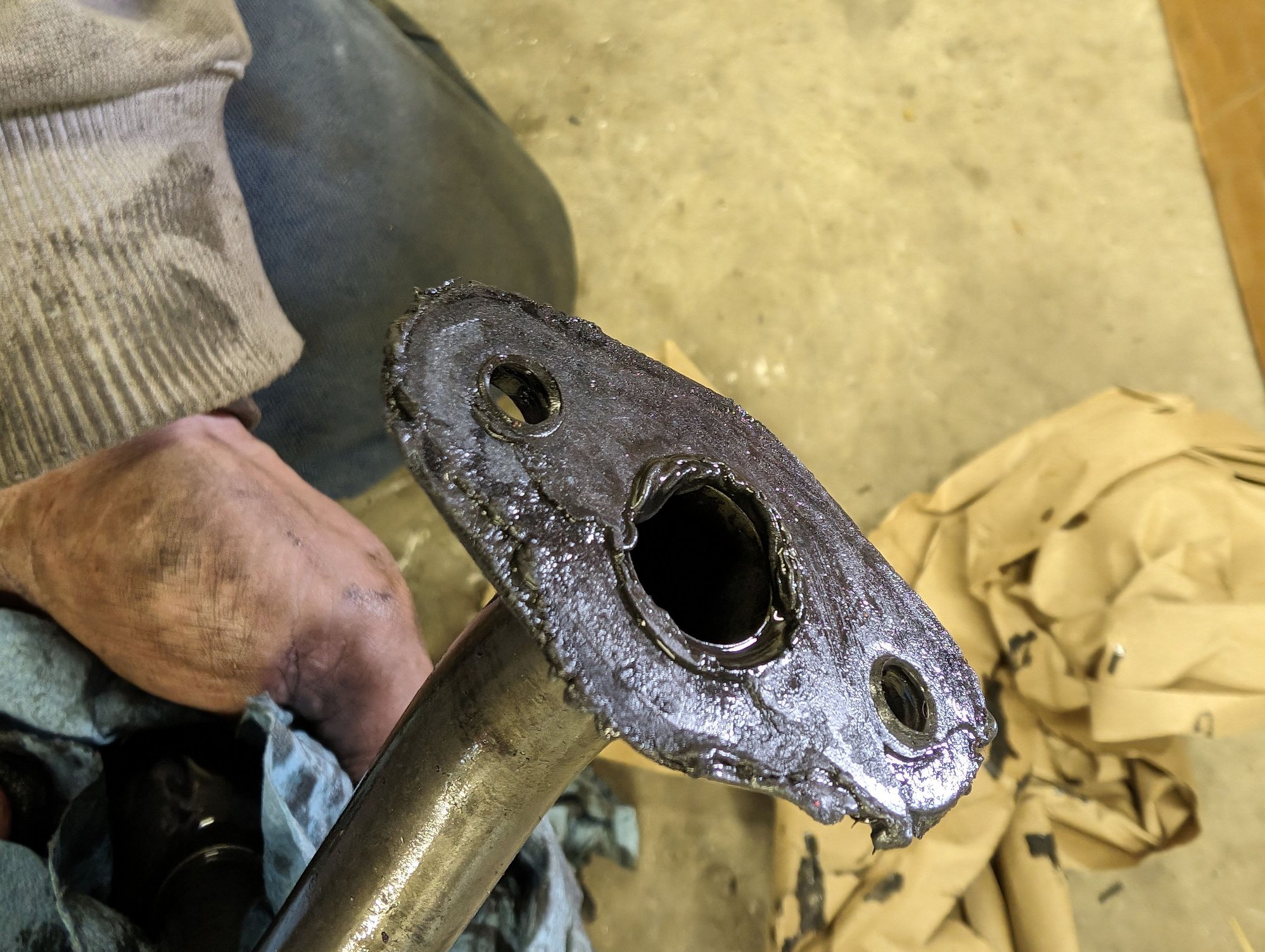

​​​​​​They DID RTV the crap out of the pickup tube gasket.... might've even been a possible leak there...
Also the pickup was FULL of all sort of debris... gasket material... metal chunks... sludge... stuff that looked like hairballs...
and did I mention.... CHUNKS OF METAL?! 😂
I went back under the engine and looked everywhere and couldn't see where the chunks would've came from... Maybe we have our answer for why the heads were redone...?

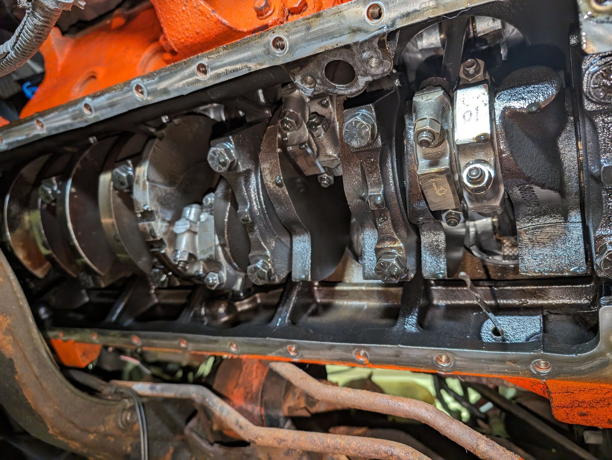

While I was under the engine I discovered that heyyou was, indeed, correct - for the most part - you can see/access the pump cover screws when the pan is off... well, you can see 4 of 5 and can actually access 3 of 5!..... with a 1/4 torx bit and a 1/4 box end. 😂
the three I could access were good and tight... I imagine that means my pressure loss could be due to blockage and no a leak in the oil pump cover...?
​​​​​​Not sure I feel like I need to tear down the front of the motor to get to the oil pump now... part of me says do it and the other says don't... haha

I don't see any real signs of leakage at the pump cover. That's a good sign.
I have seen oil pans MUCH worse, on engines that still ran..... and, of course, even worse on some that didn't.....

That blue seal is for the lower intake. Why/how it passed through the cam galley is a good question. This place has been inhabited by idiots in the past. Gasket for the pickup tube is a little paper affair. Could make one, easy. All the extra silicone those clowns used went into the oil galleries somewhere. You know they never changed filters, so constant bypass.......

I have a V-8 in a 1500 4x4 that someone opened up/pulled oil pan the lazy/easy way, by pulling the pickup tube. They did not retorque the pickup properly upon assembly. When it fell into the pan later, the engine seized. Beautiful, rust free AZ truck, low miles. Bought it dirt cheap. Just an observation.

I cannot help but think you'll have better than you started with after cleanup. Like I said, can't do anything with oil pump with timing cover on. Factory screws have bit of LocTite of some sort. Never seen loose rotor cover, maybe forum parrots chattering.
1. Even with hot 5w-30 mine idles at 35psi of oil pressure. I have since moved to 0w-40 and its even better.
2. maybe forum parrots chattering.... I thought that may be too but when I pulled my timing cover for doing my performance cam. 2 of the screws for the rotor cover were so tight I was worried about stripping the heads, the other 2 were barely finger tight, at 80k miles. Mine was also on 38s and used as a mud truck so take 80k miles with a grain of salt.
