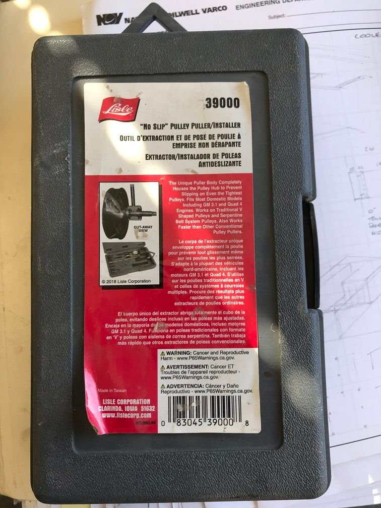

Thanks for the picture! I've officially got that puller on order!

"Thanks for the picture! I've officially got that puller on order! "
Then my apologies, this is the correct one for the damper NOT the power steering pulley.
Not much help at all. I sent both to my son awhile back, grabbed the wrong one to attach. Standard 3 jaw pullers do not fit/grab well. Space too tight. I got lucky once, then struggled. This one works, period.

Apologize again for dumb picture error.
