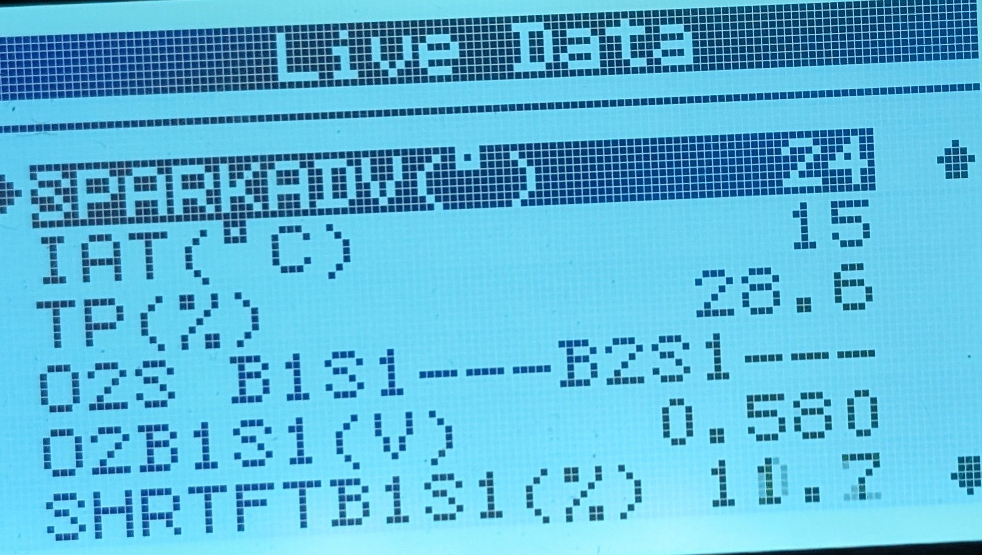

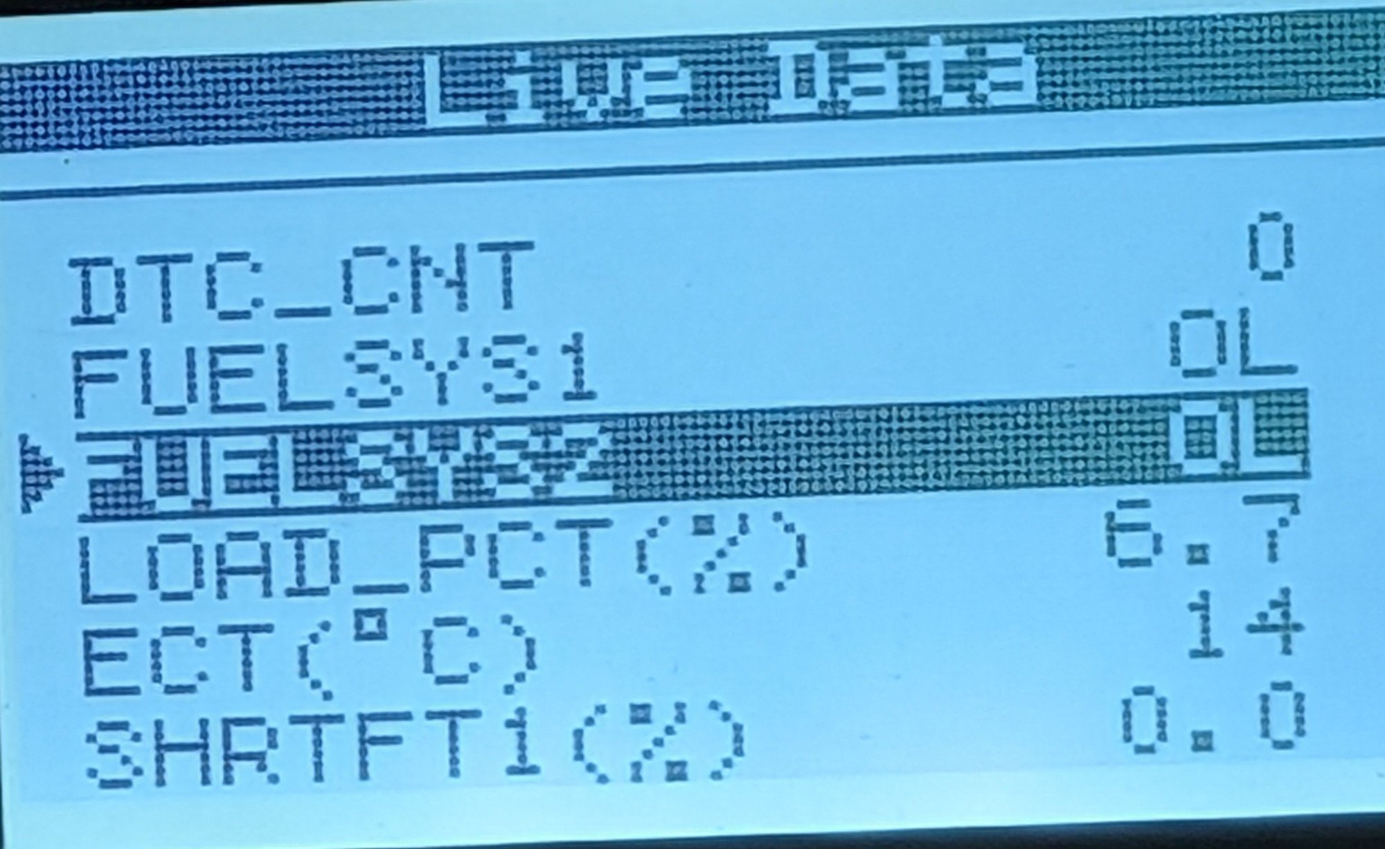

Basically wanna look at anything that would influence fueling. So, engine temp, throttle position, intake air temp, etc. O2 sensors won't play role for the first couple minutes of run time.....
Here we go - live data - key on, not running
For reference with the temps - if I were to guess it was about 60F in the shop...?
Fired the truck up and actually idled pretty okay for a while and then started struggling. The misfires didn't seem as extreme but it wouldn't stay running on its own. I could keep it idling by just resting the weight of my foot on the pedal.
Killed the motor and checked TPS on live data. Foot off pedal and then pedal to the floor:
Didn't get voltage readings at sensors in hopes the live data would be good enough...? Sort of ran out of time - gotta run back into work and fix something for 2nd shift..

Wow, near the end there it was pulling a TON of fuel.
How long did it idle to only climb 2 degrees F? You can probably switch to F in the settings somewhere....
You may want to check TPS backprobed with analog meter -- you want to see a smooth sweep as you open the throttle slowly. But I'm not sure TPS is your problem here

I didn't run it for too long at that point. Maybe a minute or so?
I kept checking live data but noting was changing other than the IAT and IAC values were rising more or less together
Darn, I'll hopefully get to that tomorrow then... I have to run and get the wifes car in to the dealer for regular scheduled maintenance immediately after work and not sure I'll be waiting around for that to get finished. Haha!

What kind of plugs are those? Lookin' at 'em, they look to be some variety of rare-earth spark plug? That may be part of the problem..... Get a set of standard copper plugs, brand of your choice, make sure they are gapped properly, see if it runs any better.
I would like to know why throttle position is at 26% at closed throttle. That seems kinda high to me.
I kinda wondered that, too. I think I've seen 15-18% on some vehicles but 26 does seem high. I wonder what your V10 says?
But that -26 STFT is troubling. It's trying hard to pull fuel for some reason. Maybe inadequate burn from the fancy plugs, but would it be that simple??
