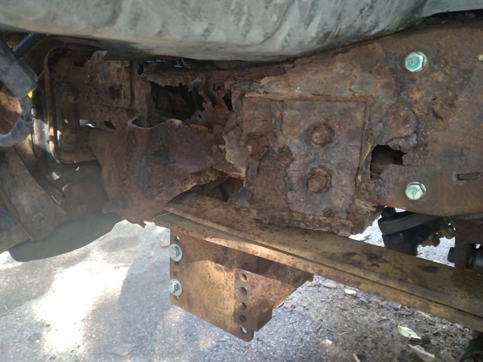

I've honestly been avoiding the cab mount and rocker panel situation for a long time because of how bad they are, but finally dove into that again tonight. Dad and I swapped the driver front out last year, and I just finished pulling this one tonight. Indiana winters have not been kind to it.
I've got a '99 Ford Superduty with good cab mounts. The frame though....
The rest of the frame isn't quite as bad, ut I've gotten my use out of it and I'm selling it as a parts truck. It runs and drives okay, but if it gets hit in front, it'll fold up.
