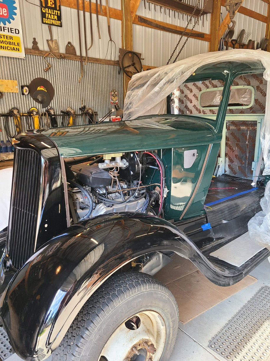

Very nice project truck and thanks for the photos!

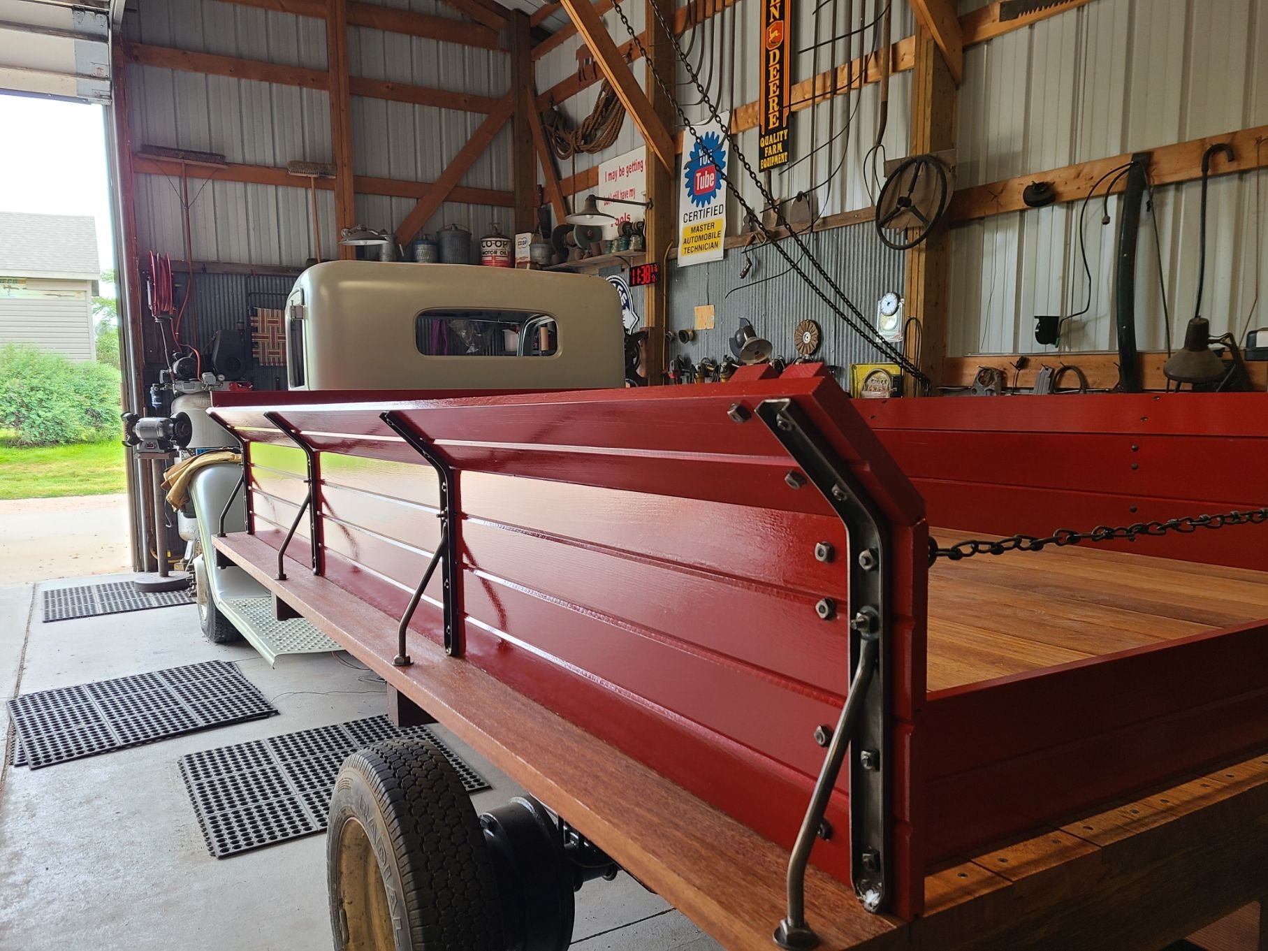

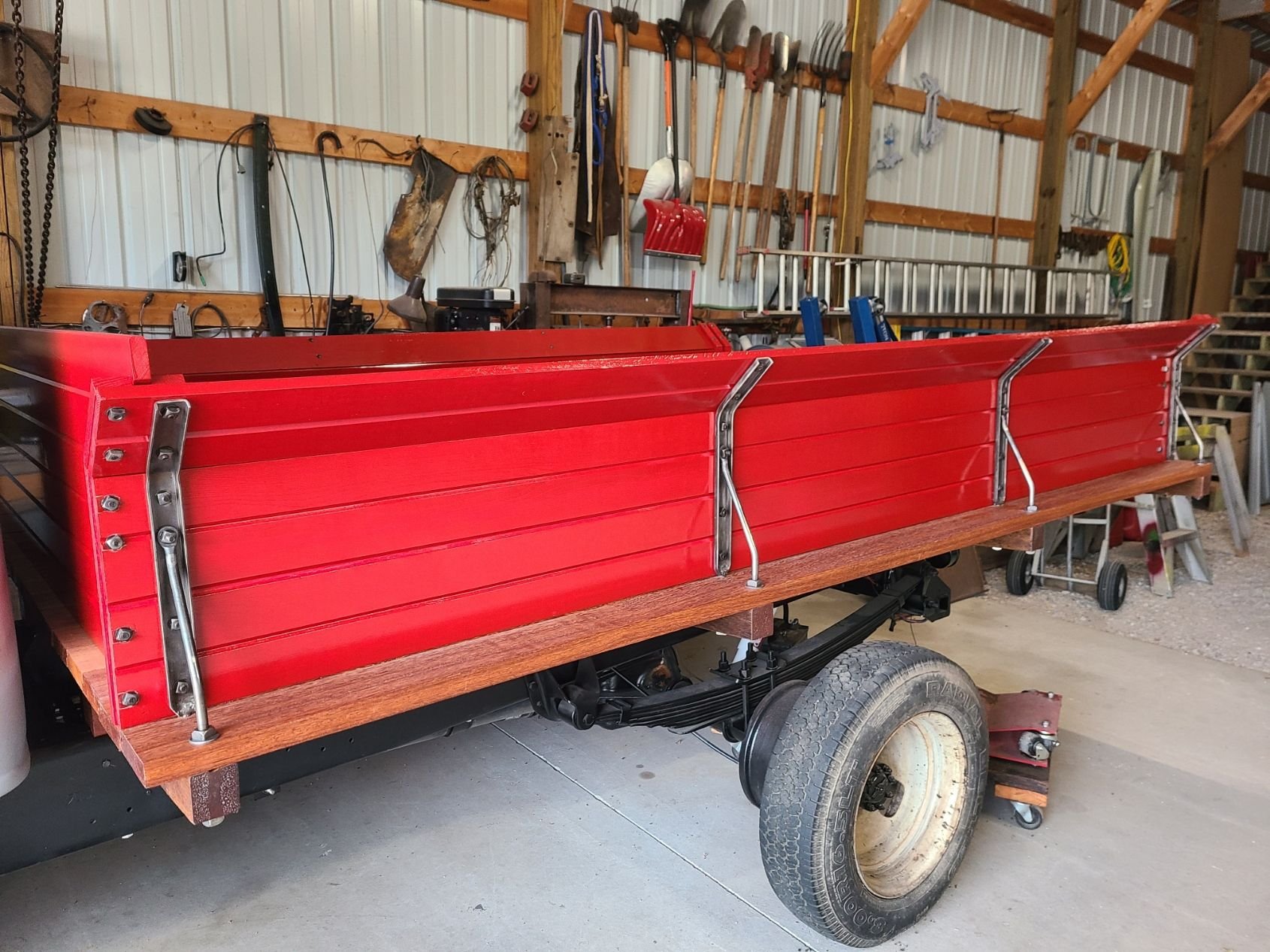

Here is a couple of the box I built. The truck will have dauls.
Old Nov 14, 2024 | 09:56 AM
Posts: 87,549
Likes: 4,230
Ooooo, that's NICE.
