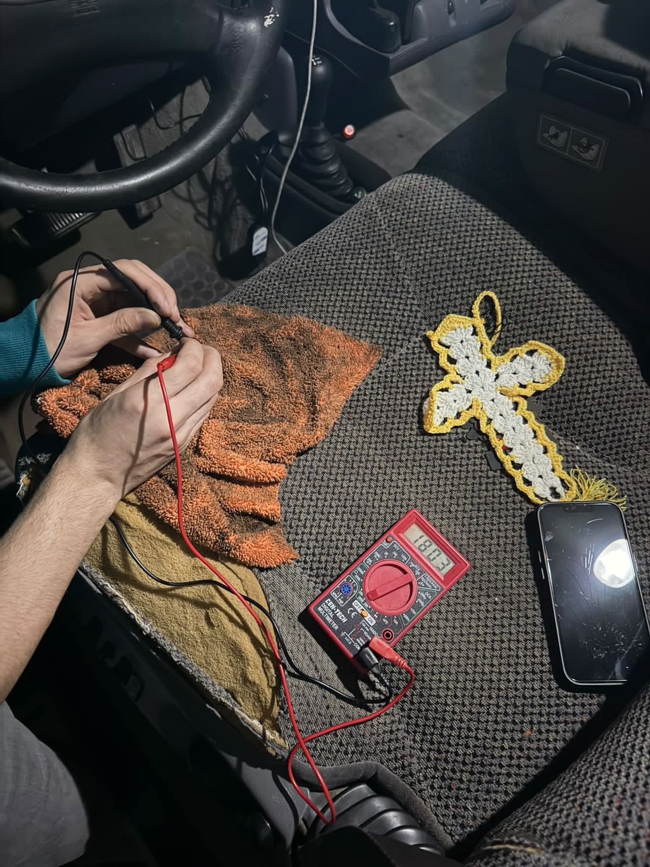

This is Testing the New sensor only a couple months old

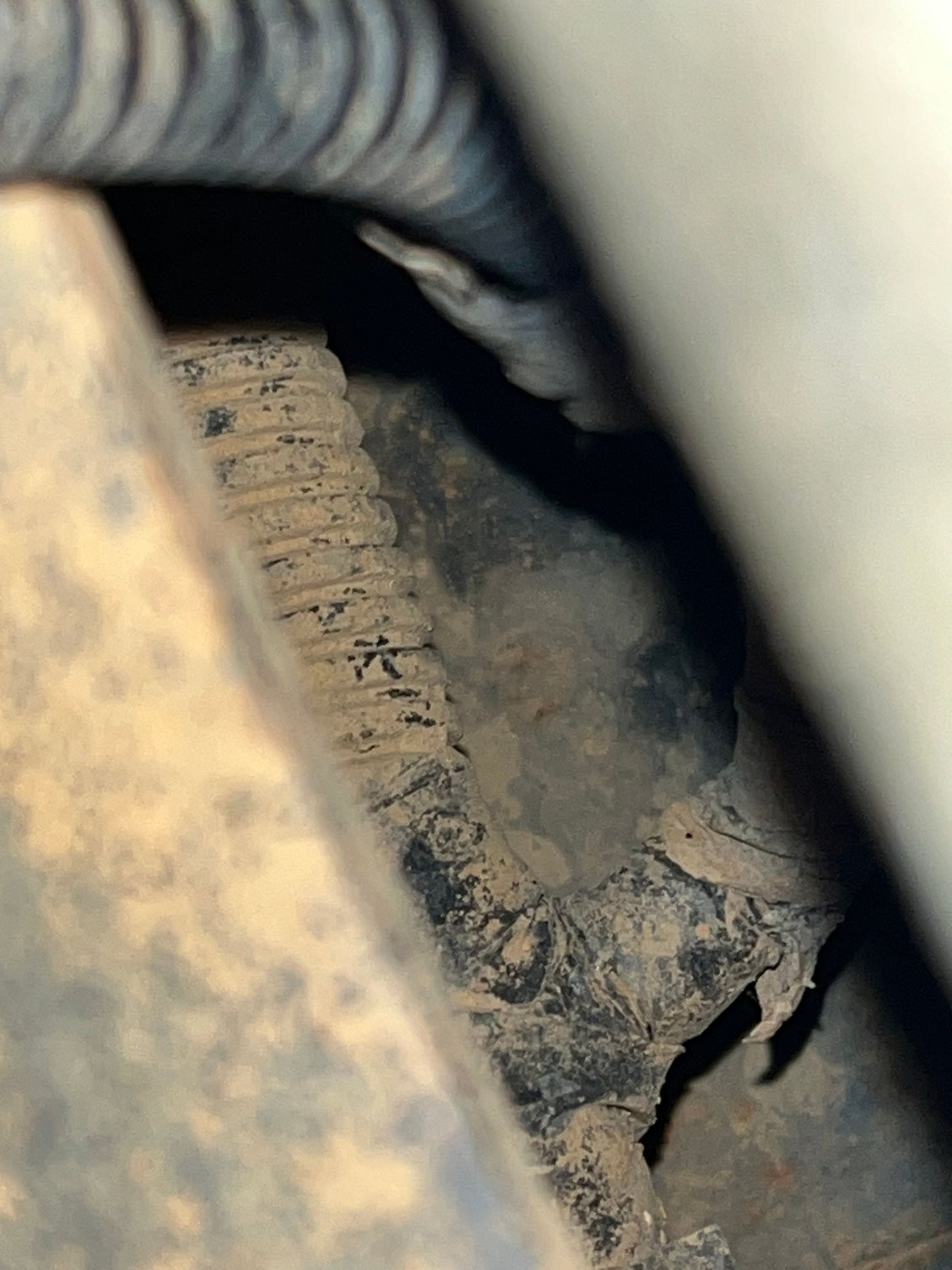

This is the only knick ive found so far that shows any wire.. the rest of it goes up into the frame and Tees into the harness
This is the only knick ive found so far that shows any wire.. the rest of it goes up into the frame and Tees into the body

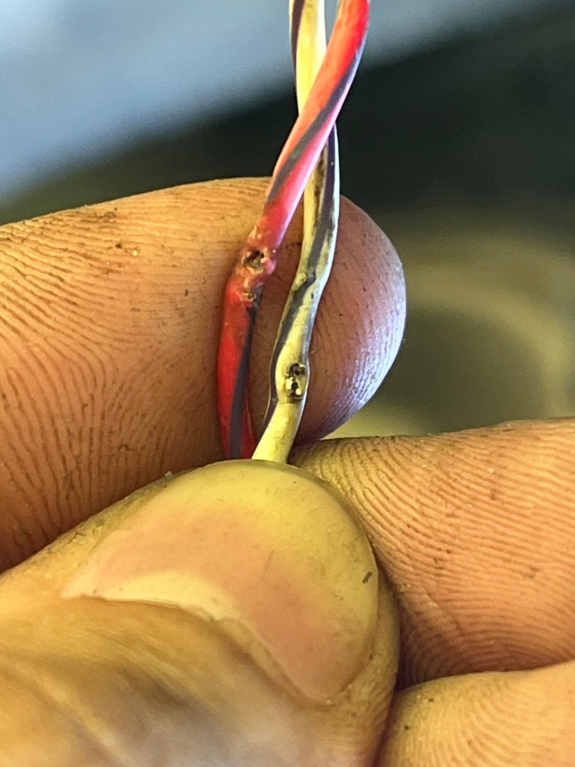

This is where the rest of the wire Tees into the body harness
harness
