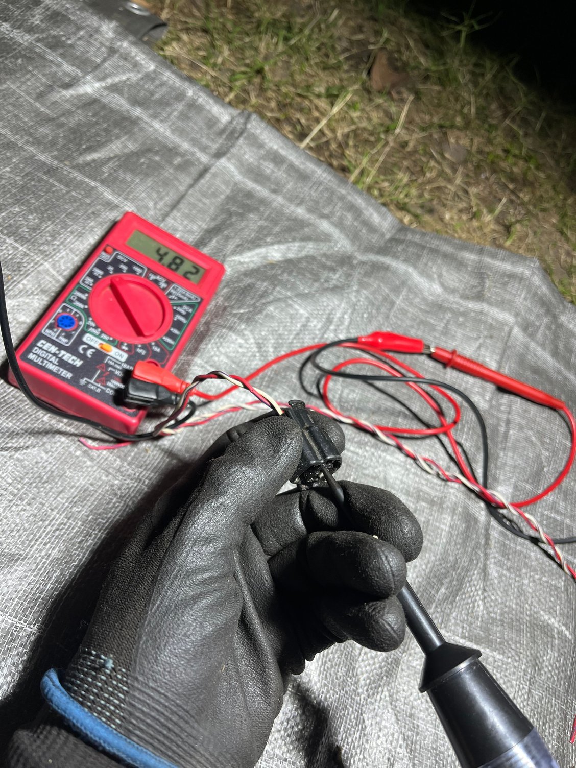

I mean at this point it’s the easiest thing to do, I’ve ruled out all other options. If i chase this wire into my body harness and find the cut. It would of just been easier to run a new wire

I couldn’t wait to order the tool so i made something similar, i have found where the wires drop voltage, it was a thin peice that was fluctuating between 2-4v. I made a new connection and now i have 4.82 all the way to my connector.

Do u think this will solve my issue now? Clear my check engine code and go for a drive and see what happens is next step right?

I jacked up the rear end and let the tires spin freely in drive, nothing on the speedometer or on the Code reader while i had it showing live data….could it be my ground wire?
Old Nov 22, 2024 | 08:45 PM
  #30
Posts: 87,483
Only two wires back there matter. 5 volt feed, and signal return. The sensor generates a 'tone'. The frequency of that tone tells the PCM how fast you are going. If you are getting power TO the sensor, then the sensor return wire is the problem. Or, the PCM itself....
