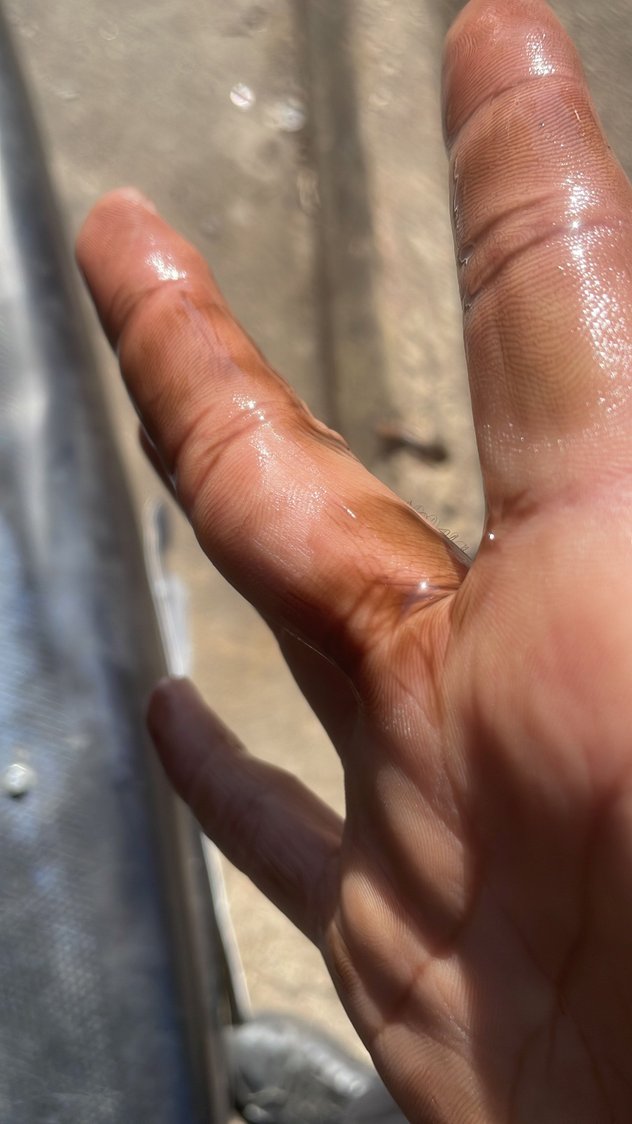

White smoke? That is not a good sign... are you losing any coolant?
Grab the service manual for your truck from here. There is a procedure for setting base fuel sync, which will at least get you close.

Not enough for me to notice, oil seems to be kinda dark and more watery than oil even tho I did a fresh oil change. Not sure if the picture is enough to tell anything....
