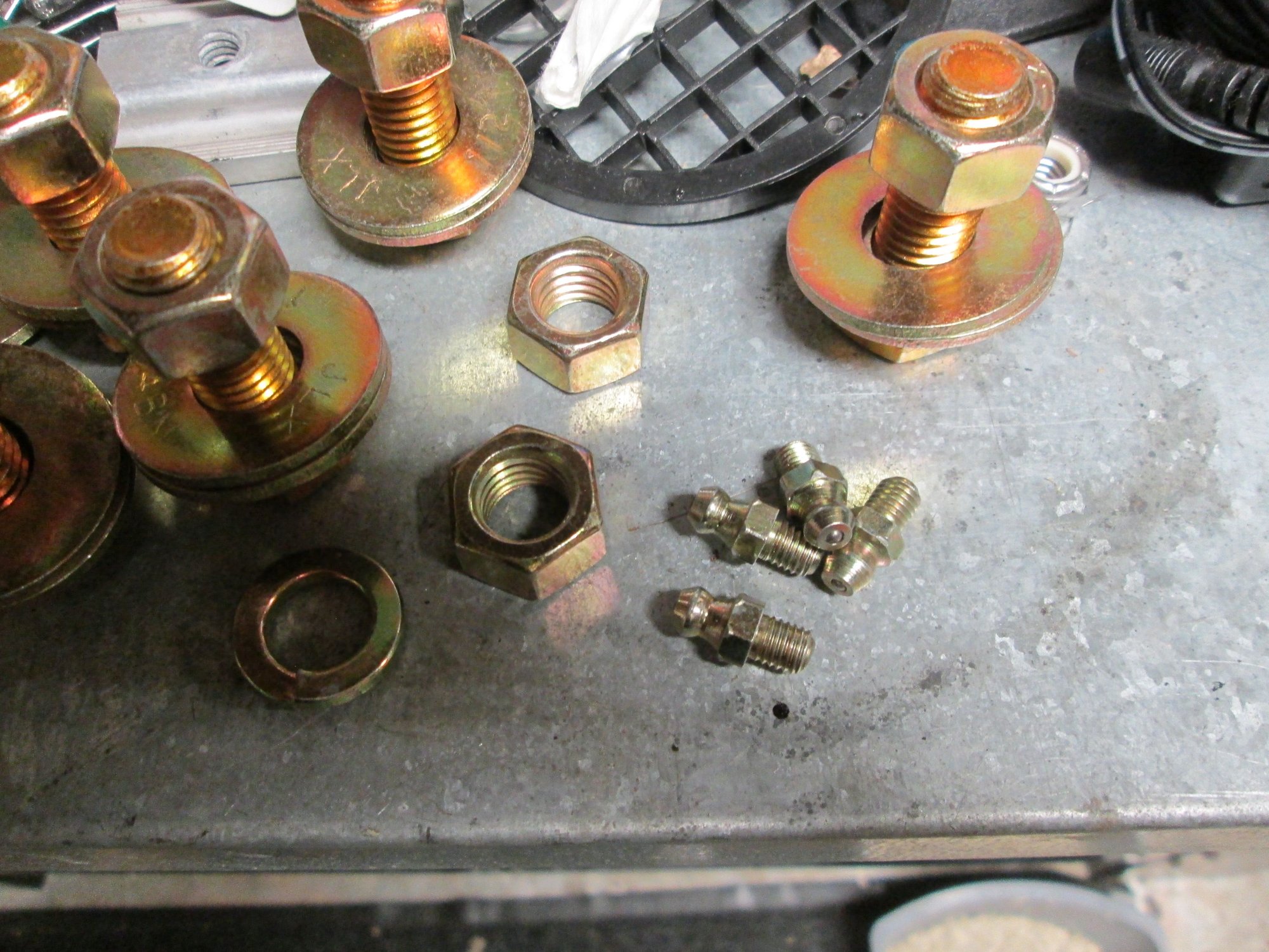

In typical import parts fashion, this is poorly labeled. The 1/8‐27 is obviously NPT (because 27 TPI is otherwise not a thing plus 1/8" would actually be a #5 like 5-40) and the 1/4‐28 is smaller than the 1/8‐27 because, again, pipe thread.
I also sourced some M5 zerks because that may very well be what you find in u-joints that are greaseable in one cap.
Again, don't confuse M5 (metric) with #5 (Amuhreecan). I only mention because people often get confused and think, say, a 10-32 machine screw is M10. BIG difference! (#10 is 3/16")

I've been busy during all the rain cleaning everything up and hope to get the frame done when the rain stops sometime in August, I guess. Anyway, after Keiths posts, I did some googling and found that masonry drills seem to work well with a low speed drill press (which I don't have) for spring steel. This isn't going to happen with my drill index and my Ryobi cordless drill. So I went hardware shopping and came home with some 1/4-28 zerks that have a longer shaft. My 1/4-28 tap says to use a No3 drill bit which I don't have. About that time my neighbor wandered over to check on my progress. He has a drill press and his son is 2 years out of trade school, working as a machinist. We're gonna tackle this probably tues-wed this week.

I might be inclined to try a center cutting end mill and just peck drill, but getting one close to .213 is a little problematic. Even then I'm not sure how well a tap will fare.
You might revisit drilling the spring eye bolt, then cross drill where the two halves of poly meet. You can easily turn (face) the poly to shorten it and create a small gap so the two halves don't quite touch. This is kinda how Icon does their greaseable UCAs for my wife's F150
