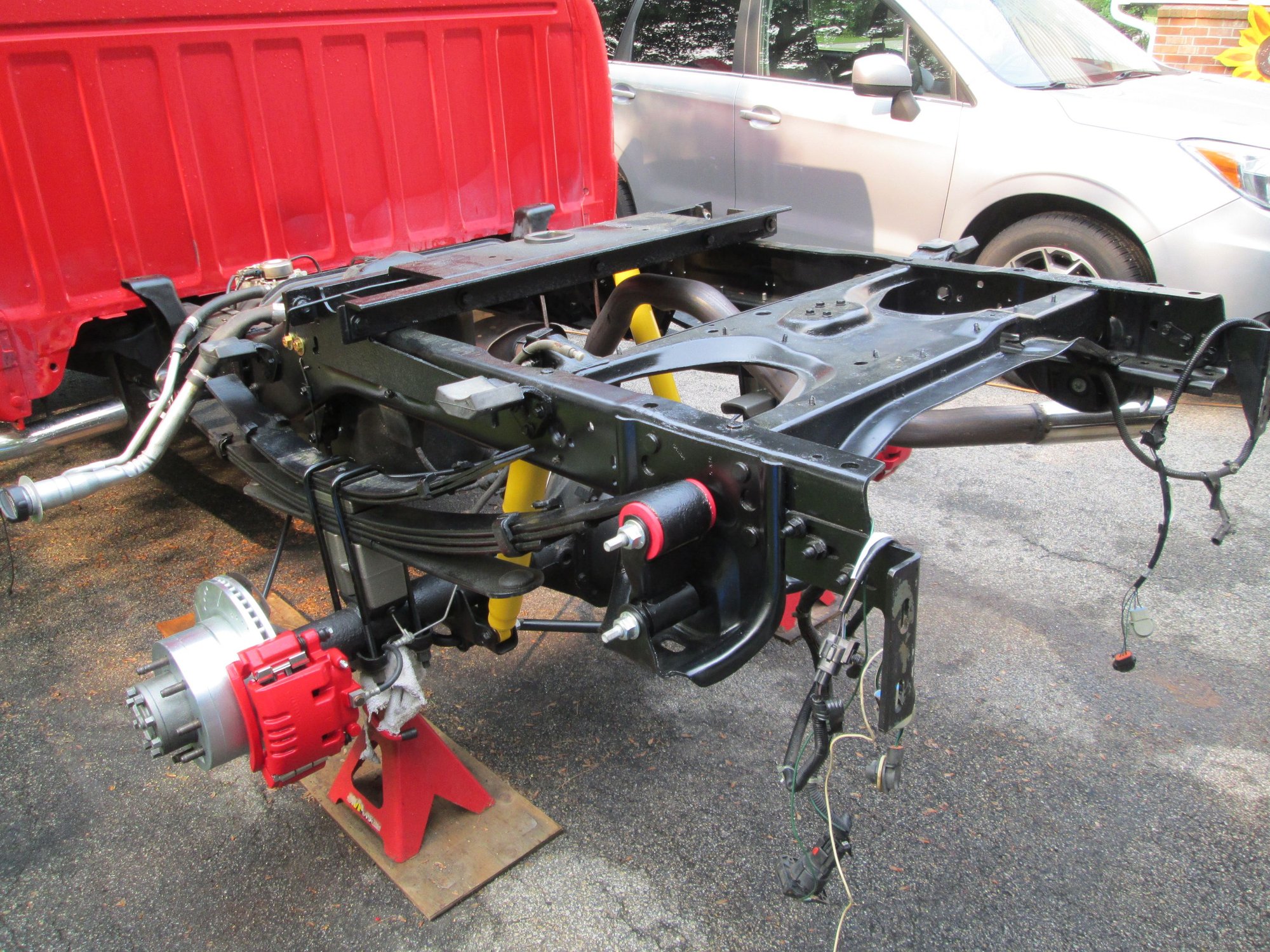

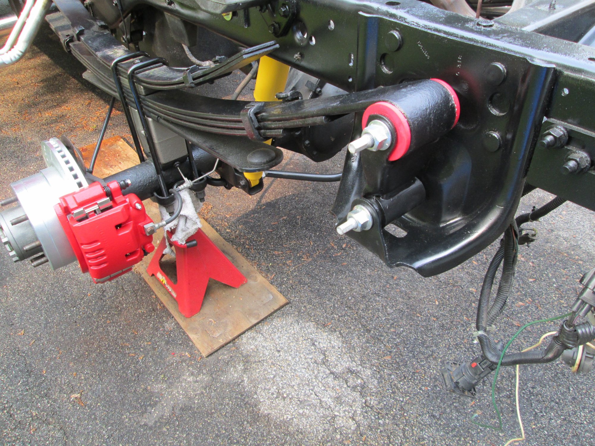

I wanted to follow up on this. Sorry for the delay, life kinda got in the way for a while, but I did get it back together.
The Bushing kit from Energy Suspension for 3" wide springs said to remove the outer sleeves from the factory bushings before installing the new ones. Well, the new black bushing were a loose fit. So much so the truck would never have driven right. I measured the bushings and spring eyes. 1.65 for the bushings and 1.82 or so for the spring eyes. I called ES back and they said I should not have removed the sleeves. Um, directions said otherwise. The mailed me new bushings to fit the eye diameter of the springs under warranty. The new red bushings fit properly but the new sleeves did not. Too loose and too long. Luckily, I was able to use the sleeves from the original kit. The new bushings were wider and fit end to end when installed, so at this point I gave up on the whole greaseable spring eye thing and just got the truck back together using the Formula 5 grease.
Blasted the areas of the frame that needed it. POR15 and top coated. New Mopar hardware and shackles with the bushings, new shocks, 3rd gen brake upgrade with new parking brake pads, hardware and cables. Refreshed and reinstalled the gooseneck hitch. New bushings and links for the sway bar. Upgraded the overload springs to the dual leaf set the Cummins trucks get. New rear exhaust hanger with new rubber isolaters at all locations.
It drives soooo much better. It just took far longer than I planned.

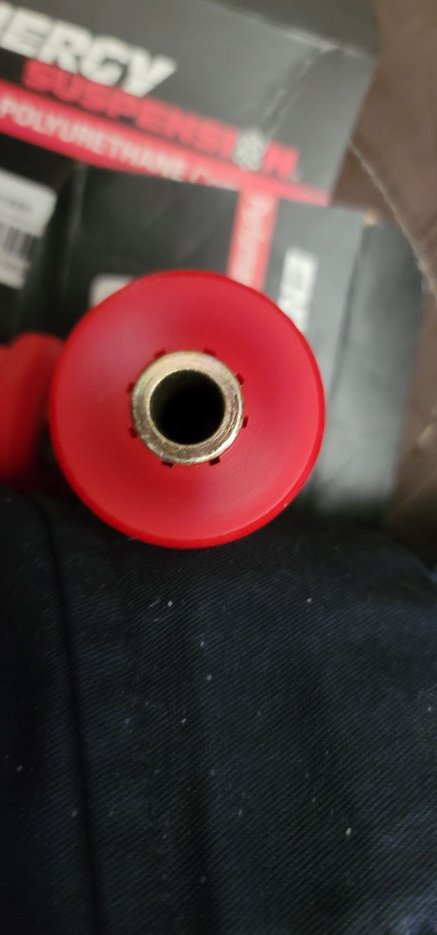

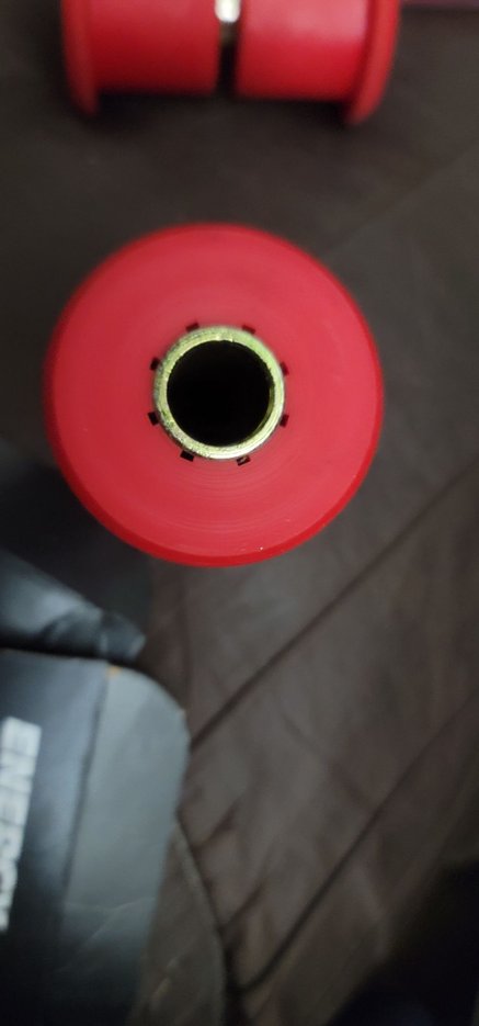

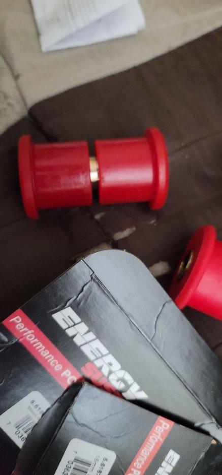

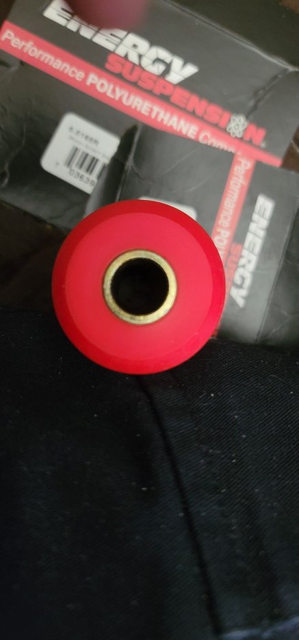

I realize this post is like 4 months old but i am in the process of replacing my Rear leaf bushings as well as Front upper and lower control arm bushings ( F&R Sway bars also) Got the complete Kit for my 2000 Durango 4X4 and was thinking the exact same thing adding zerks to the rear Leaf's and Shackle as well as the lower control arm bushings I have some pics showing slots/grooves in my bushings as well as the gap between the 2 piece bushings when installed according to the sleeve length but ill have to upload those in a few min
Shackle bush no groove
Gap once installed via sleeve length
Grooves Lower control arm
Grooves Rear spring Bushing
Groove upper control arm bushing
As you can see the leaf bushings and Upper and lower control arm bushings have grooves/slots in them to allow grease to actually move from middle to outer if had a way to add grease, I found the same thing on the outer front sway bar bushings as well as both front and rear sway bar mounts have a slit tp allow to be installed where i could drill a small groove aligned with a zerk to also grease them as well The upper ones though i will have to modify a grease needle to get into the slotted area as adding a zerk does not seem feasible
