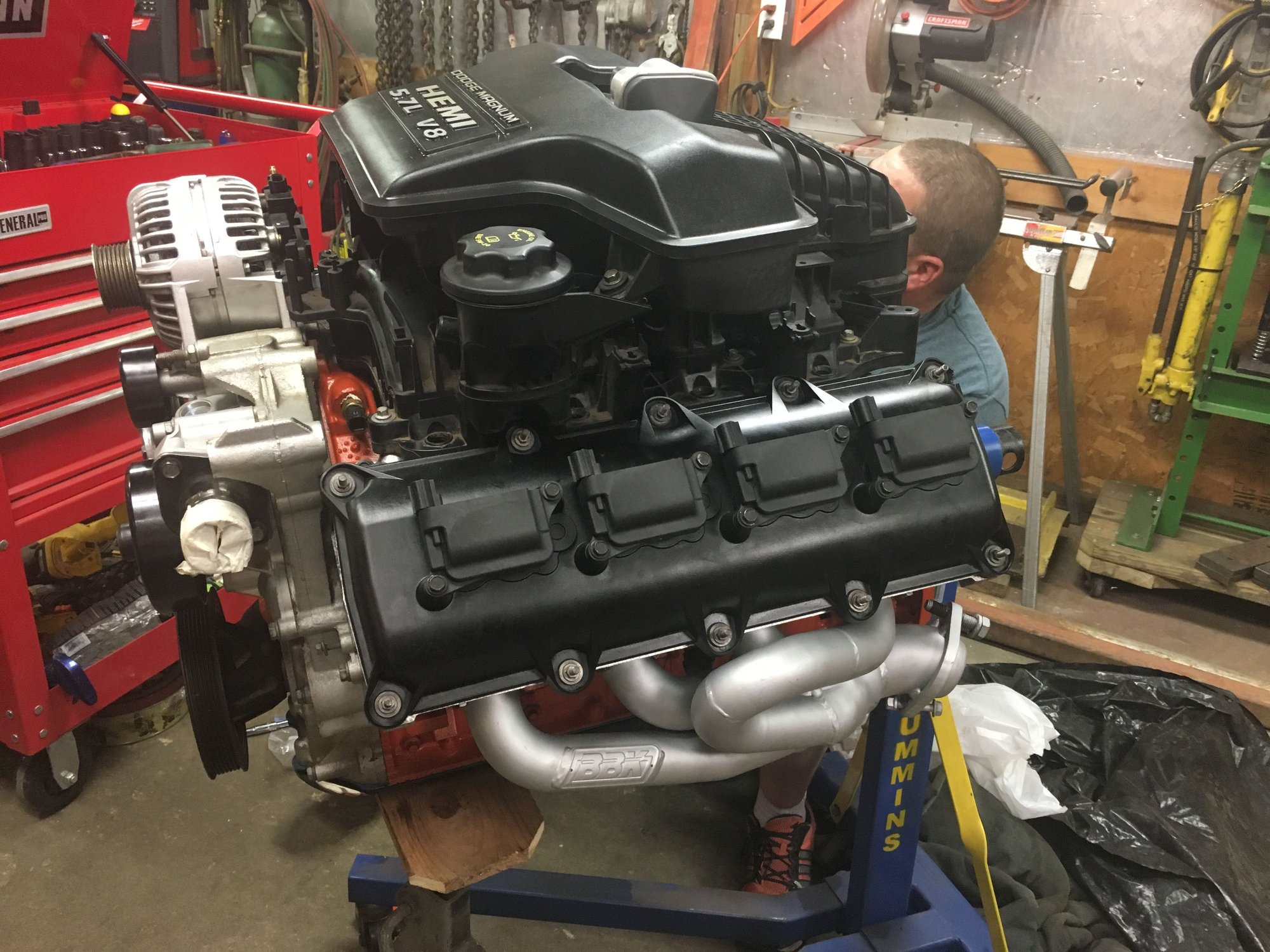

I tried multiple header styles and they would not clear the steering shaft on the drivers side
I had to use stock 5.7 Ram manifolds

Hand built 5.7 with Greene Racing Cam (BBK headers would not fit in the truck ....)
