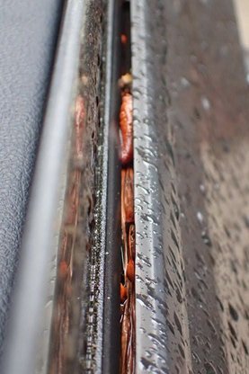

Replaced the vehicle. Literally. That leak was only the cherry on top of the other issues I had with that vehicle. While it's a great vehicle, their design team must have spent the majority of their time at work severely inebriated and only spent one week with a single test mule. The windshield design is terrible and like the side molding at the bottom of the other windows is a debris trap and a pain to clear/clean, add in the fact that the outer seal with the intent to prevent water from making its behind the edge of the windshield doesn't work based on design and installation.
Here is a photo of the top corner of the windshield, driver side looking down, you can see how it seals (err, doesn't) -
(Sorry, it's pollen season here...)
Here you can see how I have to get out the tweezers to get either part of a leaf or a pine needele out from the seal at the bottom right of the window -
And why there is molding with a gap is a mystery, have fun using your high power vac and some tweezers...
Sorry that I somewhat digressed, but you can see what I mean regarding time spent with the test mule. As much as I like my '15 RT, I could continue with this topic for three more screens (at least).
