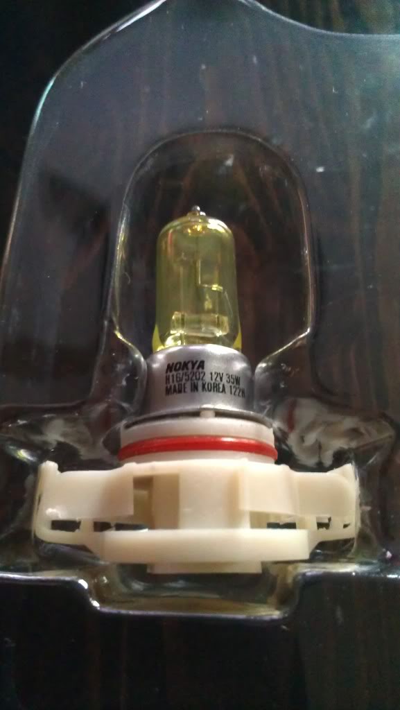

H16 35w halogen bulb. I am partial to the yellow "euro" lookName:  IMAG0080.jpg

Like 2012 sxt posted, you need to sheer off one of the tabs (very easy!) This is the single tab that needs to be removed (other side has two tabs, so its easy to distinguish between the proper one).

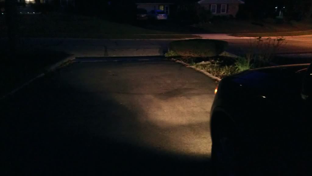

Here is a shot of the brightness from the fogs only!

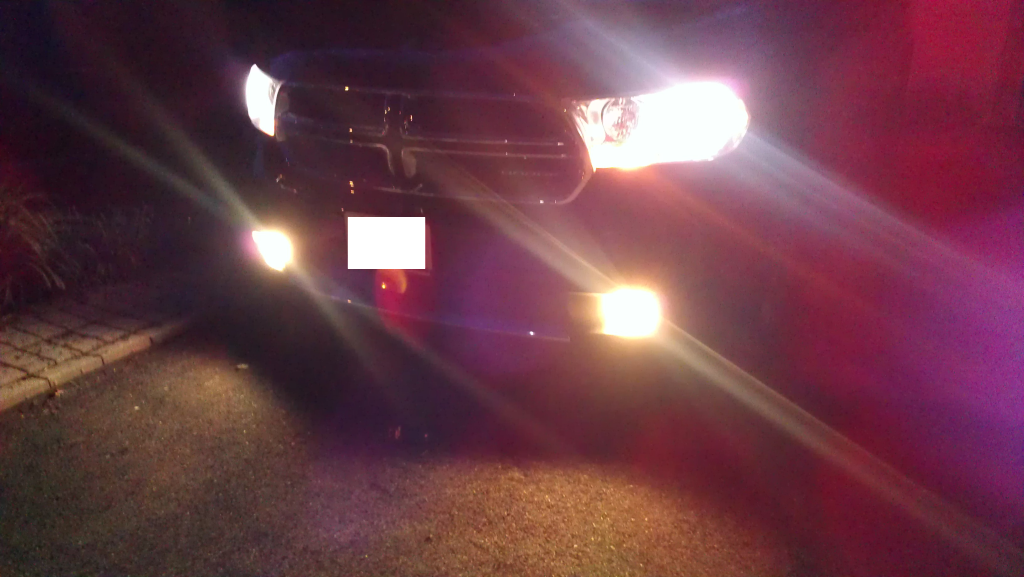

Here is a crap picture meant only to show the brightness compared to the stock headlights (color contrast is WAY better in person and should look even better when the new headlight bulbs come in)

I can't speak to the heat difference and possibility of melting, but with it being halogen and only 10w higher, hopefully it won't be an issue. Bulbs are on amazon for about $25 and come in 4 different kelvin temps. Hope you all find this useful!
