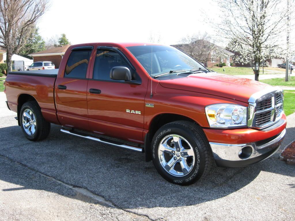

These days, my 08 Hemi Quadcab
1500 2wd, with 130k miles, with 20" wheels and factory 3.92 gears gets 13-14 in all city driving. Mixed, about 16mpg and all highway 20-22mpg. It has been close to this since day one. I have run a Diablosport Predator since it was about a month old and run the 91 octane tune with 93 octane fuel. The only mod is an Airaid MIT pipe between the TB and stock filter box with a K&N drop in filter. I also use NGK copper V-Power spark plugs instead of the oem Champions.
